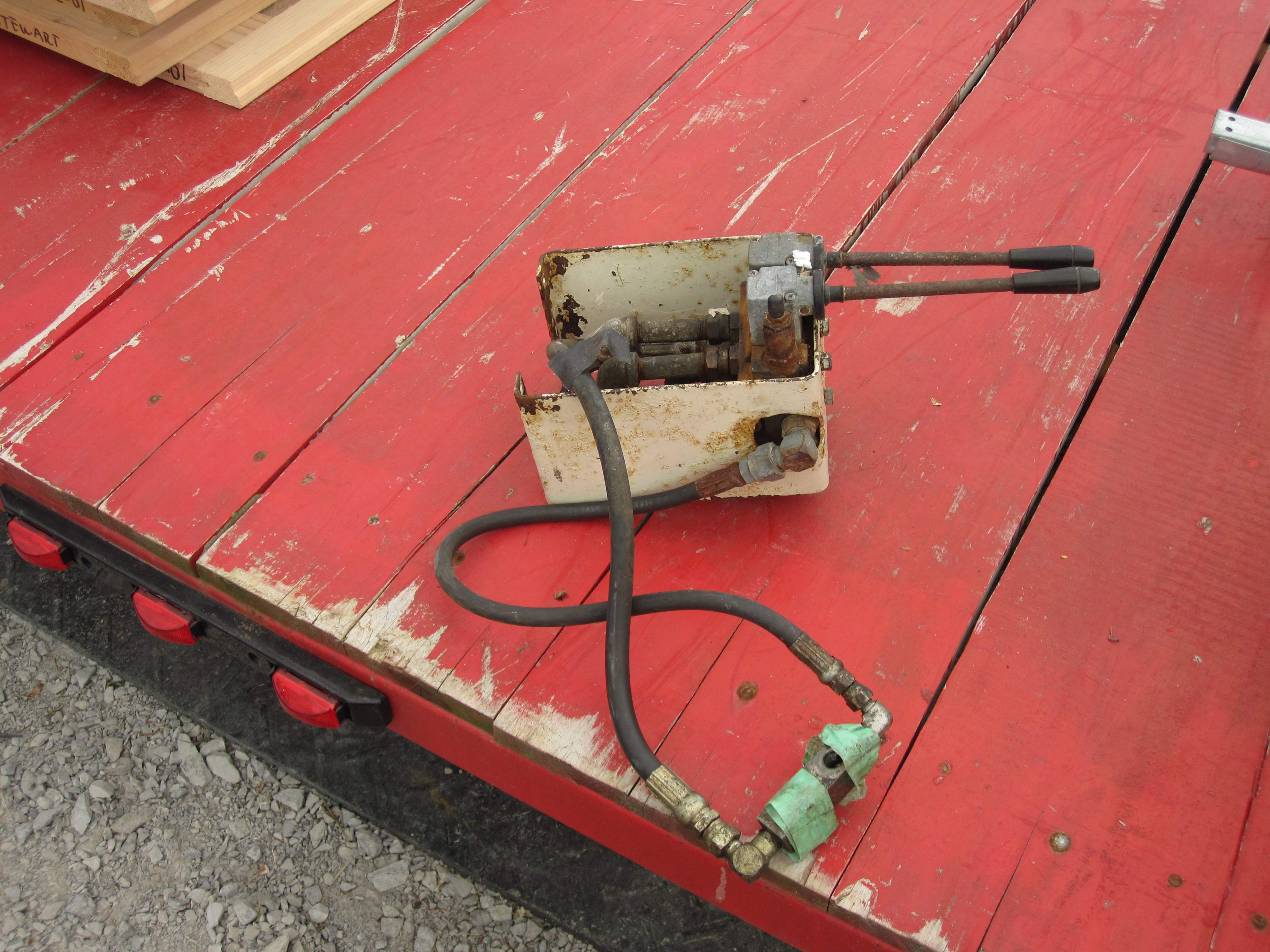

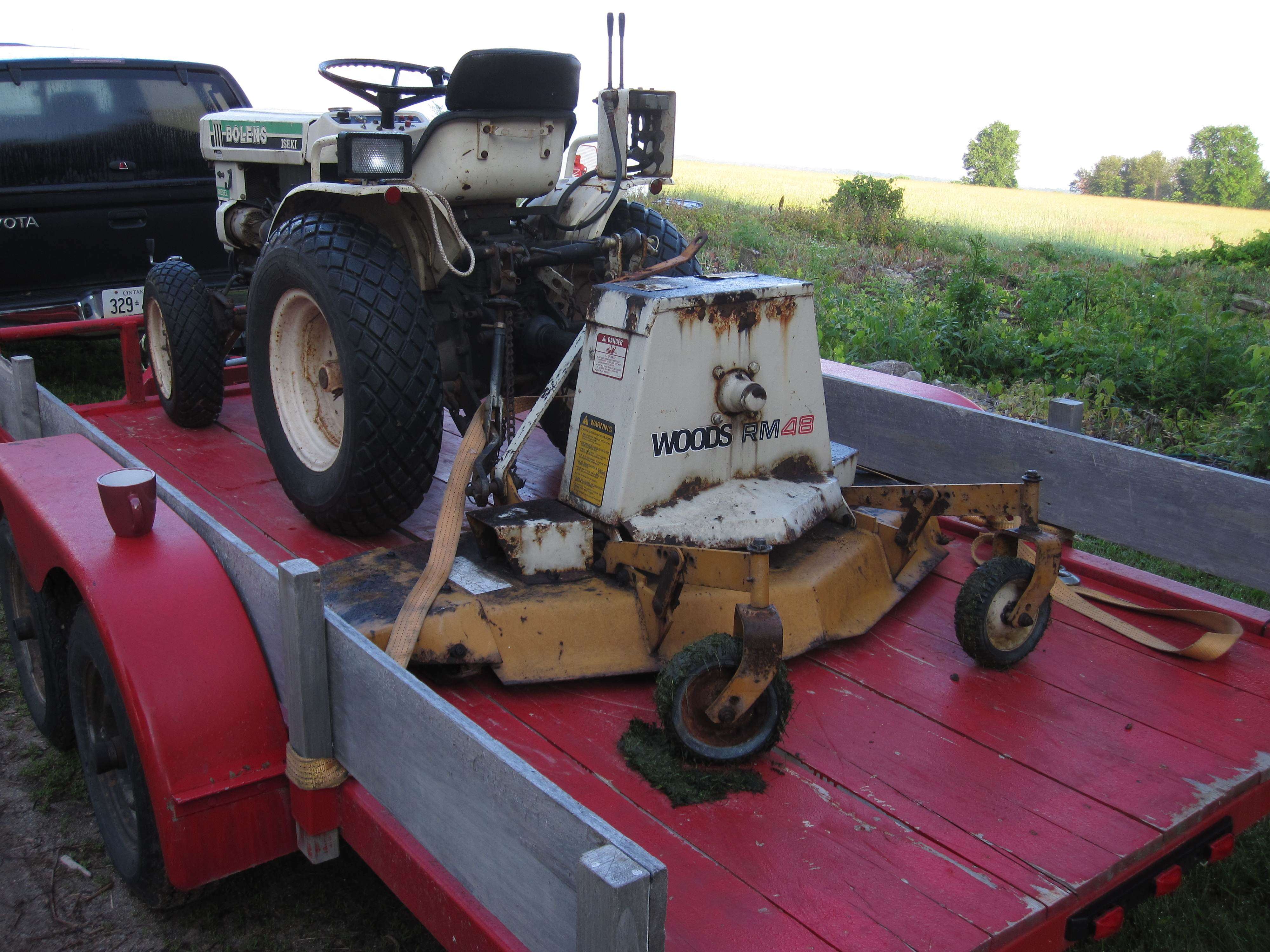

Here are a couple of photos of the unit which came on my G174, the 17 hp model from 1981. While it did not have a visible rear remote, the valves could easily have been routed in that direction.

When I bought it I was told that it had the ability to add a pipe to enable me to tip a trailer. I was told that it was a simply job of undoing a nut on the side under the seat. Adding a pipe and then when I activated the 3 point link arms to move to the top. When they got to the top the oil would then pump through the pipe and tip the trailer.
