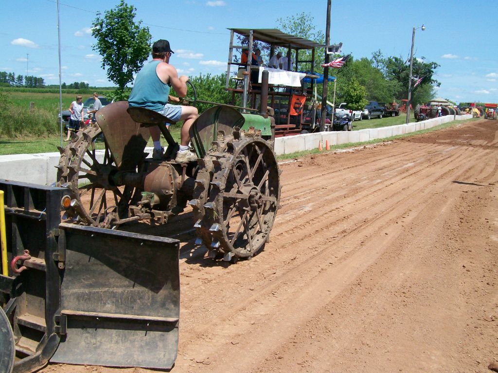

What ply tires are you guys running? My turfs are only 2 ply and I expect punctures. I have one tire that is a heavier ply (which also happens to be the one that I tubed). If I was losing tires that much, I'd get heavier ply tires.
As for the valve stems, see if you can have a hole drilled inboard more and move the valve stem farther away from the outside edge. But what I cannot understand is if you are brush hogging, how is anything surviving in enough big pieces to get under the tires in the first place? When I brush hog everything is destroyed before I drive over it. That's why I love the out front design. Are your brush hog's wide enough to cover your tire tracks? Are you keeping it raised off the ground which allows stuff to go under it and get to the valve stems? Or are you just beating the bajeebers out of it in order to make timely progress on a large job?
There's got to be some solutions to it. Perhaps some steel wheels like the old tractors had. Seriously.
