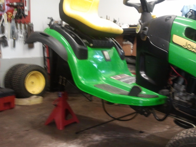

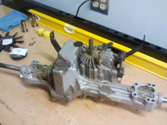

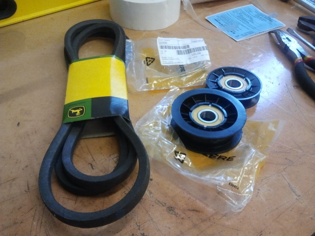

I am all set to begin the K46 rebuild, just waiting on parts. I have the trans removed and cleaned. I also drained the oil by removing the filler cap (vent valve?). Only thing is I wrecked the cap taking it off. The rubber was cracked. No big deal, John Deere has one locally. To the people that will do this repair, I would order this inexpensive part along with the rebuild parts.
I also found out one of my drive belt idler wheels had a seized bearing. The belt had worn through the plastic wheel, and was rubbing against the bearing itself. I had to use a claw puller to get the idler wheels off.
Anyway, I will take some pics along the way.
I am a little concerned about the 'purging' process I read here. I don't quite understand the directions. But, I'll figure it out. Some people said they didn't need to do this.
