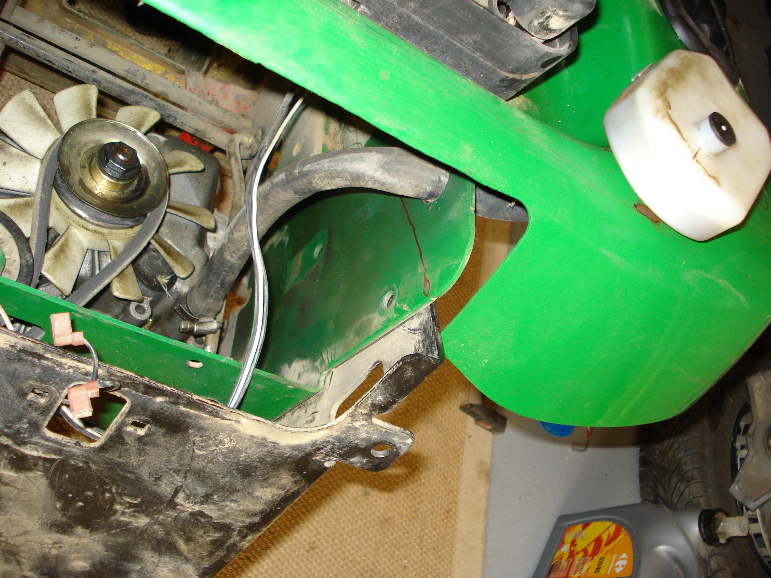

Great thread and good advice did convince me to rebuilt mine:
A JD TRS180 10 years good service (estimate 2500hrs) but loss of traction.
Stripdown showed pistons were in good condition but the filter blocked with ferros black residue. JD workshop manuel notes that "Hydrostatic oil filter plugged" as reason of 5 different defects including lack of pulling power. The parts arrived from TuffTorq and the oilfilter was not the folded paper/carton type filter I had taken out but nylon mesh filter. Seeing that the filter had succesfully worked to keep metal shavings/debrit circulating I was not convinced also as the nylon did not have a metal base no where to put the magnet which also had collected a signficant volume of fine debrit. A call with TuffTorq gave the older (finer) type oil filter was no longer available and recommendation to leave the magnet out :mad: These were the items that got my K46 further then most......................
So my conclussions was that to get my next 4000hrs :thumbsup: I will need to change oil regulary and as filter changes require a total stripdown need install magnetic drain plugs to keep the oil clean between changes.
Drilled and taped the 2 drainholes to suit the magnetic drain plugs I got from my local motorfactor (Take care with the plug near the dif.: it will hit if the magnet is too tall). Then relocated the reservoir to the top of the rh wing. (Carrefull routing the tube from the transaxel to the wing to ensure free flow)
These modifications will allow regular oil changes and ensure (???) long life to the mecanics in that box.
Thanks to all for contributions hoping that's my last "deep tactor" surgery:thumbsup:

Piratesignal: I got my magnetic drain plugs from my local garage mechanic and he also drilled and tapped the two bosses that Tufftorq have cast into the cover (the bosses that have a drill pilot hole cast on the inside of the cover (one can't miss!) If you still cannot find magnetic drain plugs try http://www.magneticdrainplug.com/automotive.html and post here which one you ended up fitting. As I said as short as possible because the crown wheel is close!!
The though of putting an electric circulation pump en remote filter crossed my mind but the engineering involved and starting price of the pump $150 alone....... Also considering the hours I got from my transaxel I beleave that now with the oil tank up on the wing regular oil changes will do me for at least an other 10years.

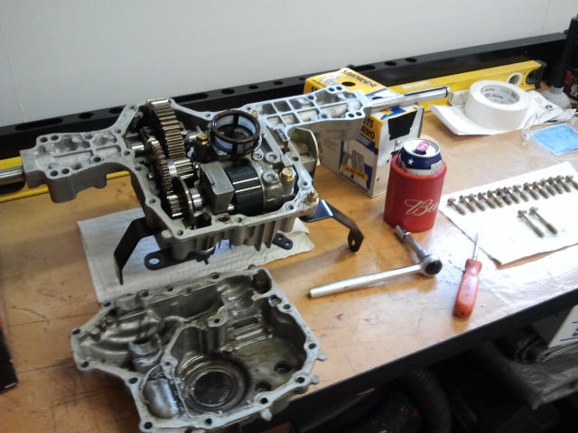

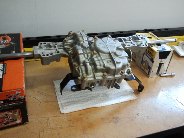

Split the case tonight, cleaned everything and, installed new parts. After reading all these posts about that little pin that can fall out, I said to myself that will Never happen to me. Yep, I got pin treatmant! No big deal though. When you start taking parts out of this thing, have a large enough work area that things can fall out but not fall to the floor and be lost.

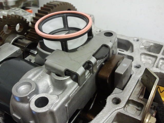

I cleaned the case with parts cleaner and then used shop towels and an air compressor to get all cleaner out. Hold a shop towel over the unit when appling air to keep cleaner from going everywhere. I went through a lot of shop towels through the entire rebuild to keep the work area clean and organized.
When I first split the case, I must admit I was a little freaked out! I had a beer and just kind-of looked at it for awhile. But then slowly started to wor on it. The rebuild took me about 3 hours to complete. A lot of time spent cleaning and removing the old RTV sealer.

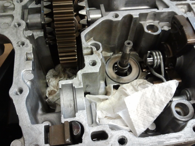

One thing that happened, when I took the case apart, the brake activator was stuck to the case by the RTV, so I had no idea what orientation it should be in for re-installation. I checked the exploded view on TT's website twice to figure it out.

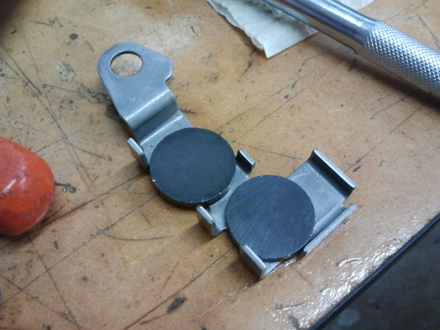

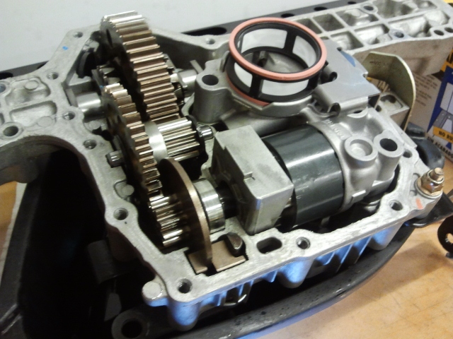

The other thing, is that my replacement parts included an upgraded magnet system. The trans now has four magnets instead of two! However, I am still not sure how this magnet braket should be mounted. I may have to call TT to be sure I have this correct, so for now I have everything covered up and have to wait until Monday to talk with TT.

1. Ready to open the case
2. Case opened (it was much cleaner and better shape than I expected!)
3. Cleaning the trans
4. Rebuild complete
5. New Magnet bracket and how I think it should be mounted
6. Close-up of magnet bracket with magnets installed. It is upside down in the pic.

So I closed-up the case today. I applied RTV and it is sitting now since this morning, I'll give it until tomorrow afternoon when I fill it with oil, and begin the purge process.
There was a question regarding the upgraded magnet bracket, but after further study and re-reviewing the exploited diagram I elected to proceed.

btw, in pic 3 I have the brake actuator in the wrong way! I still hadn't figured it out. The Done pic (pic 4) shows it correctly.
