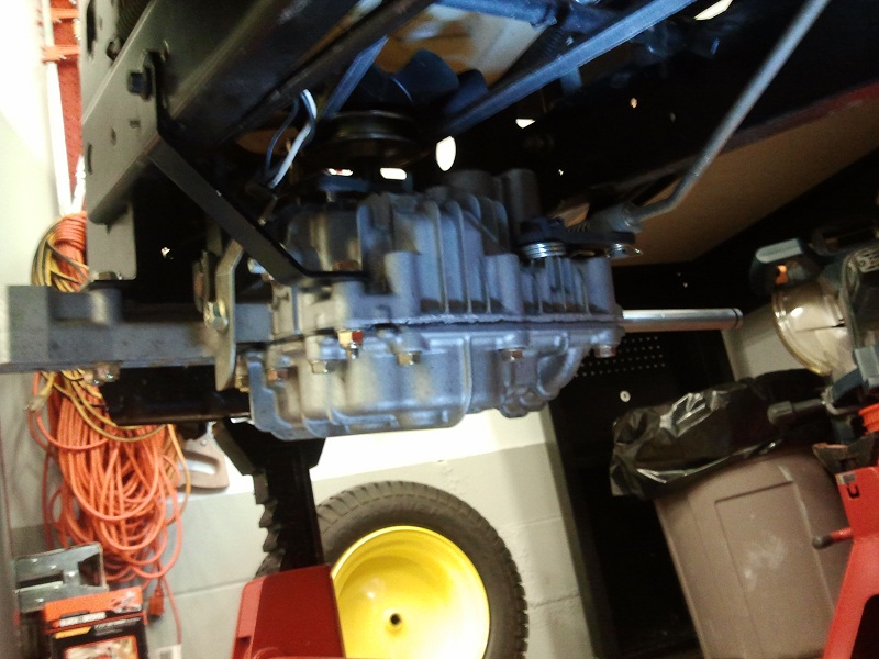

The completed the K46 rebuild last Sunday, but wanted to share some additional findings I made along the way.

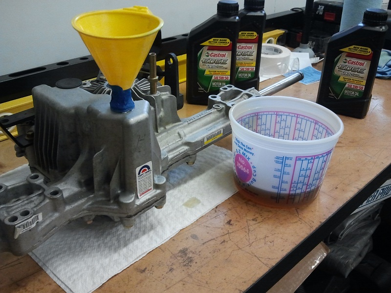

I think bench testing and purging the system is really a required step. When installing the new parts, it is easy to prime the pump that sits vertically, but the other one sits horizontally, and the oil tends to just drip out. When I bench tested mine, the oil level did drop just slightly, so I topped it off. If I had not bench tested, there would have been no opportunity to top it off.
I used Castrol 5w - 50 synthetic, cause thats what the parts store had. Also, Amsoil and Royal Purple were 15w - 50. I wanted to stay with the 5w - 50 weight.

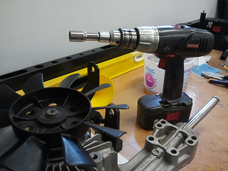

Also The pulley shaft on my K46 has no nut, just a c-clip. Trying to figure out how to attach a drill to it was a challenge. It turns out that a 1/2" drive extention had just enough grip on the shft, and worked fine.
After re-installing the k46, I started the tractor and very slowly went forwards and reverse a couple feet at time. It hestitated for just a second the the first time going forwards, but then seemed to have full traction after that. I think bench testing really paid off here.
I kept going longer distances in forward and reverse and with greater speed. After a while I just went at it on hills, climbed into and out of a steep ditch. Full traction has been restored, and then some.
Below are some pics.

Since I haven't taken one of these apart for myself, maybe you can comment on this notion: would it be possible to install two general purpose nuts on the input shaft and tighten them against each other? (I don't know what the shaft looks like, obviously) Then you could use an ordinary socket on the top one with a hex drive adapter for the drill.
One more question: Was there some particular reason you chose to use the vent opening to fill the unit with oil? Isn't there a magnet under the usual fill hole that ought to be removed and cleaned? Did you do that?
   / TuffTorq K46 Repair Guide with Pictures #214
LOL! Good observation. The vent was leaking and badly cracked, so I decided to just use that to drain and fill. When I bought the parts, TT didn't mention getting a new fill cap, and I thought I might break this thing taking it out, and with there $25 minimum parts order I thought I might end-up in a jam. I cleaned the magnet with parts cleaner and a long nossle tube, and then an air compressor. That magnet had suprisingly little metal on it, but the other one was caked!
Next time I do this, or for anyone else doing this, you should order both the vent cap and fill cap along with the rebuild parts.
