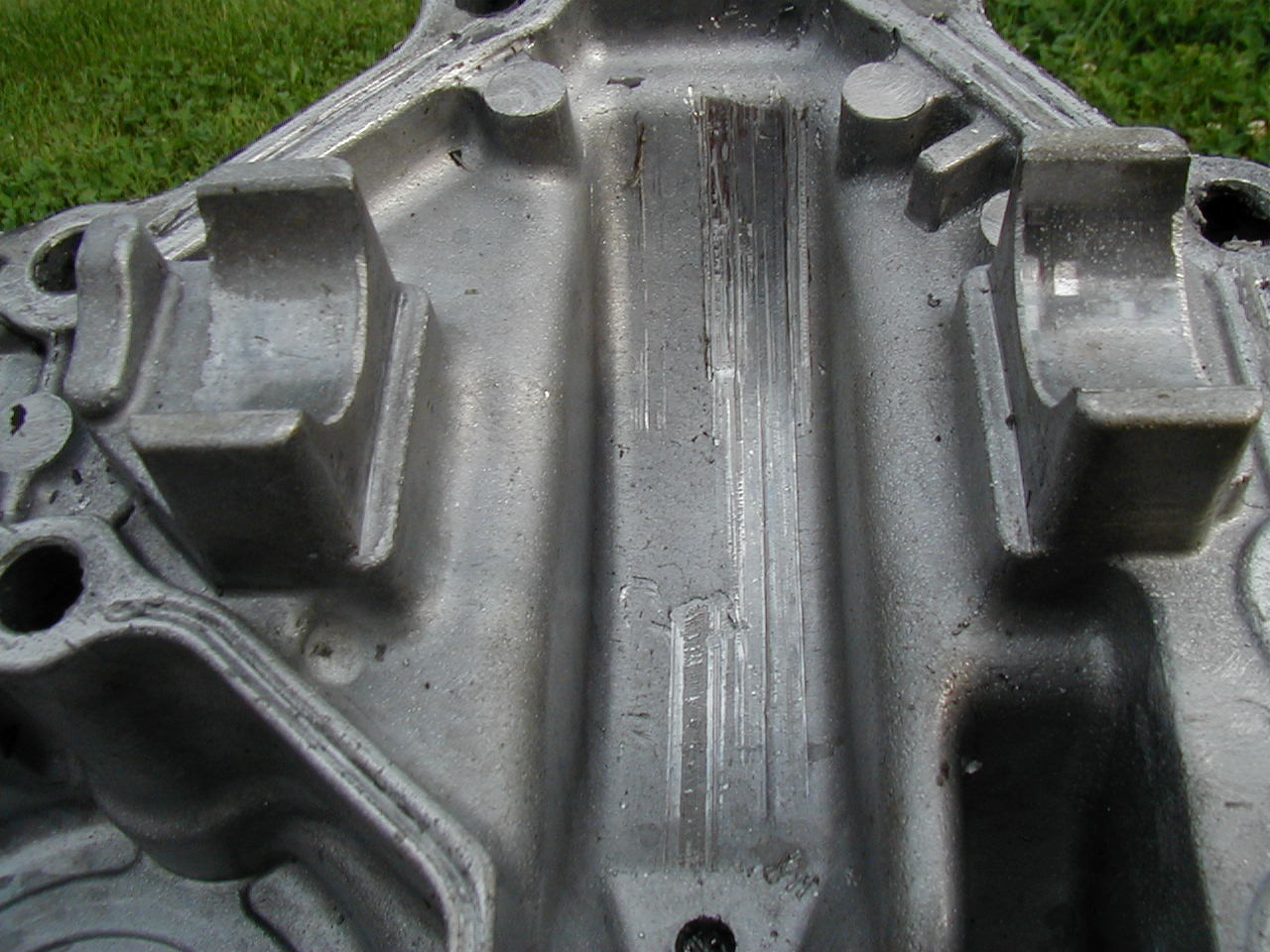

OK...here is a pic of the scratches in my trans pan....I don't remember removing the final gear #62 so I'm not sure how it got out of place. Oil was full of aluminum and center case #24 was scored up. Now back together with $300 of pump motor and center case....Operates like new, but I plan to drain and check oil after a first mow.

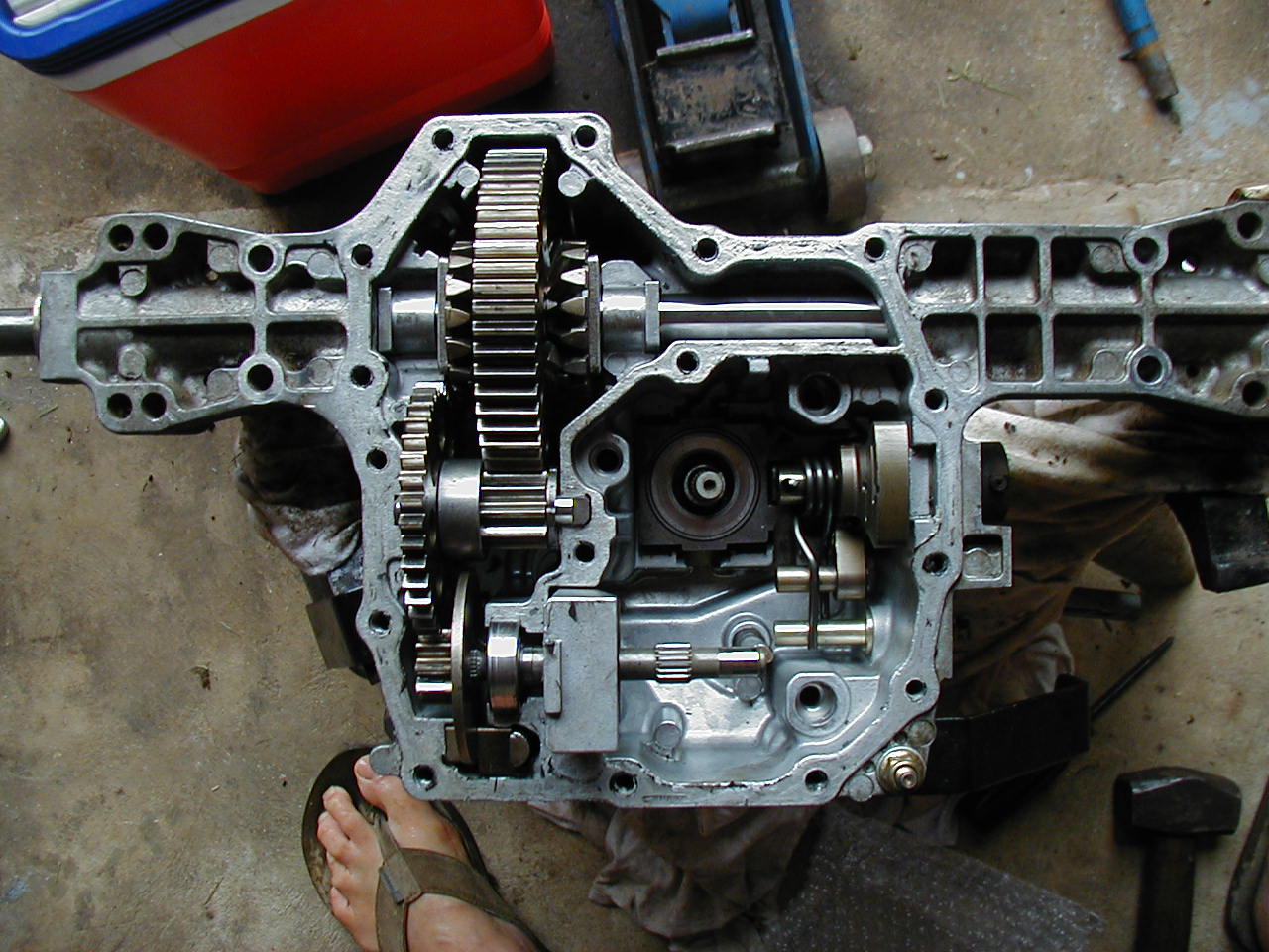

This is on a K46AC Scotts L2548...probably 6 or so yrs old I will post the hrs.
It was slow in reverse so I changed the oil...I guess the pan didn't seat properly.
