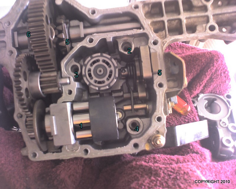

All of the guidance gave me the confidence to order the parts for the K46 transmission in my JD LTR-180. Got everything out....rebuilt and put back together then.......transmission runs in REVERSE! I must have put something in backwards or upside down! Reverse pedal drives the tractor forward but at reverse speed......Forward pedal drives tractor in reverse at high speed! Any idea what part that I put in wrong? Linkages are all correctly connected.

The ramp is upside down part #1 here is a pic from the first page of this thread.
See page 2 of this thread post #19
"It may benefit some folks to know that the wedge (part #8 on the pic in the 4th post) can be installed 2 ways; the way it appears in the picture, or 180 degrees out. The resulting actions due to an incorrect install will leave you with your forward and reverse foot pedals sending you tractor in the opposite direction. Don't ask me how I know this."
   / TuffTorq K46 Repair Guide with Pictures #349
After some further research of the different flavors of the K46 it appears as though a large percentage of the varieties (K46A) have part #36 of the schematics upside down as opposed to the picture in the 4th post. My error was not photographing my original configuration and just following the photo (which is for a different flavor than mine). The final issue was that I didn't know my variant as the bar-code label had fallen off the transaxle.
