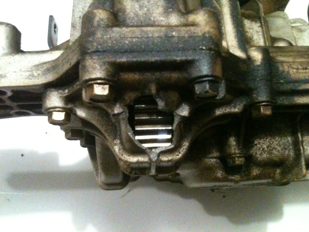

Been reading through the posts and can't thank those enough for the knowledge and help in advance.
I bought a 2005 L118 recently with known transmission problems. 450 hours, regularly serviced, other than transmission its in excellent condition.
Dropped transmission easy enough and will get to opening it tomorrow, but found the initial problem this evening. There is a hole in the lower casing about the size of a thumb. Please see picture.
I'll get a better look inside tomorrow but does anyone know if the casing is repairable? Welding or metal epoxy?
Appreciate any tips.
Thanks,
John
   / TuffTorq K46 Repair Guide with Pictures #468
OMG John...that is one big hole. If it was a lot smaller, I'd suggest patching w/ some JB Weld, but that looks too big I'm afraid. I'm no welder and don't know if tranny case is weldable metal (aluminum) or unweldable potmetal, or even if weldable, if something that big is weldable while keeping added material thin enough to avoid interference w/ differential gear. I'd be concerned about strength & durability of any patch that large, whether welded or JB Weld. Added material has to stay thin and could make weak spot. You can buy replacement lower case from Tuff Torq for $135.00. However, the bigger issue to understand is: because of that hole, the tranny no doubt ran without oil and that may have irreparably damaged many other parts. It doesn't take too many parts before cost starts exceeding cost of a good used or new tranny. Let us know what the inside looks like, but your best bet may be to buy a used or new replacement tranny.
