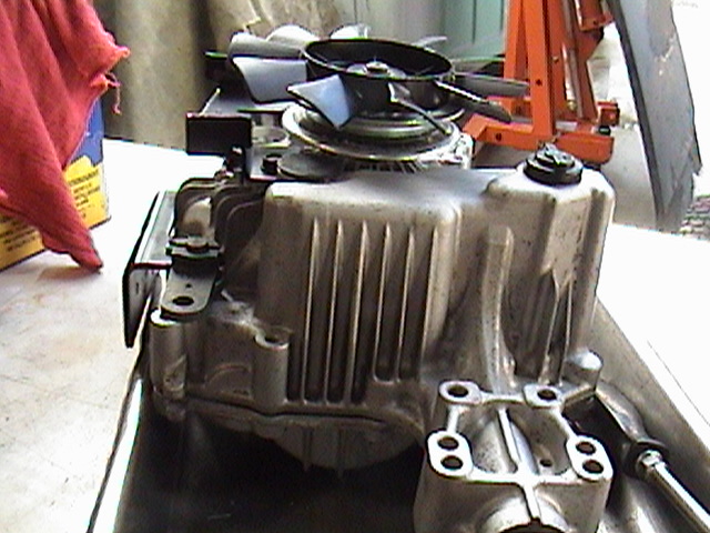

Just another opinion. I have just removed a K65 out of a JD Sabre 2048 because of a leak between the case halves. Plan was just to drain oil, clean magnets a reseal case, as there were no symptoms of problems. Upon inspection, I found a few larger bits of metal and some worn/chipped teeth on the differential gears. Filter is different than the k46, which I usually just inspect & clean. This one is a different style and can't be cleaned to the tune of 35.00! Gears are 133.00 & oil is 28.00. I'm not doing anything with the motor and pump or center case. What I guess I'm saying, is yes, I would split case and clean and inspect. Also, if you don't need to order parts & you have a hard time finding 5W50 full synthetic, Darrel at Tuff Torq said 5W20, which is more easily found in auto parts stores, is fine. Saves on the s/h, which is pretty high, from tuff torq.
   / TuffTorq K46 Repair Guide with Pictures #443

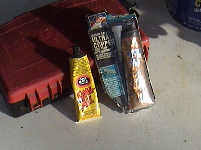

UPDATE as of Nov 15, 2012
View attachment 288978 View attachment 288979 View attachment 288980 View attachment 288981 View attachment 288982 View attachment 288983 View attachment 288984
I used a Dremel Tool with a small wire wheel to clean the old gasket material off the mating surfaces. It helped to get the material out of the little groove that is in the middle of portions of the surfaces.
I then used acetone to get the surfaces really clean.

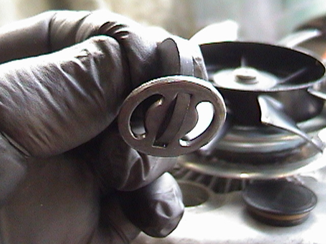

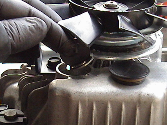

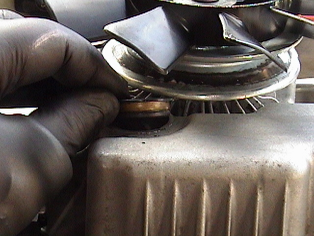

I had a loose round magnet that I couldn't figure out wear it went. Called TuffTorq but no one was there except for the operator. She sent me an email attachment supposedly showing where the magnet went, but it didn't have anything but a little black arrow that didn't show anything. I looked at the parts blow up for my K46BT tranny at:https://www.tufftorqservices.com/COM_Net2/servlet/WebDispatcher?mode=comnet

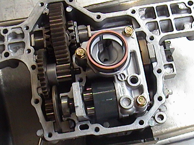

It appeared that the magnet labeled part 8 which fits into the magnet holder labeled part 9 was under the Seal Cap 30 labeled part 15. Didn't see any other magnets in the blow up, but I had one that fell out when I dropped the lower pan.
My guess is that magnet should be in the slot of the upper case. Look in your bottom pictures of your post, picture #4. Next to the large gear (final gear) on the left. You can see a slot that the magnet fits in. Look at the front of gear, then a tad left & the slot is inside of two bolt holes.

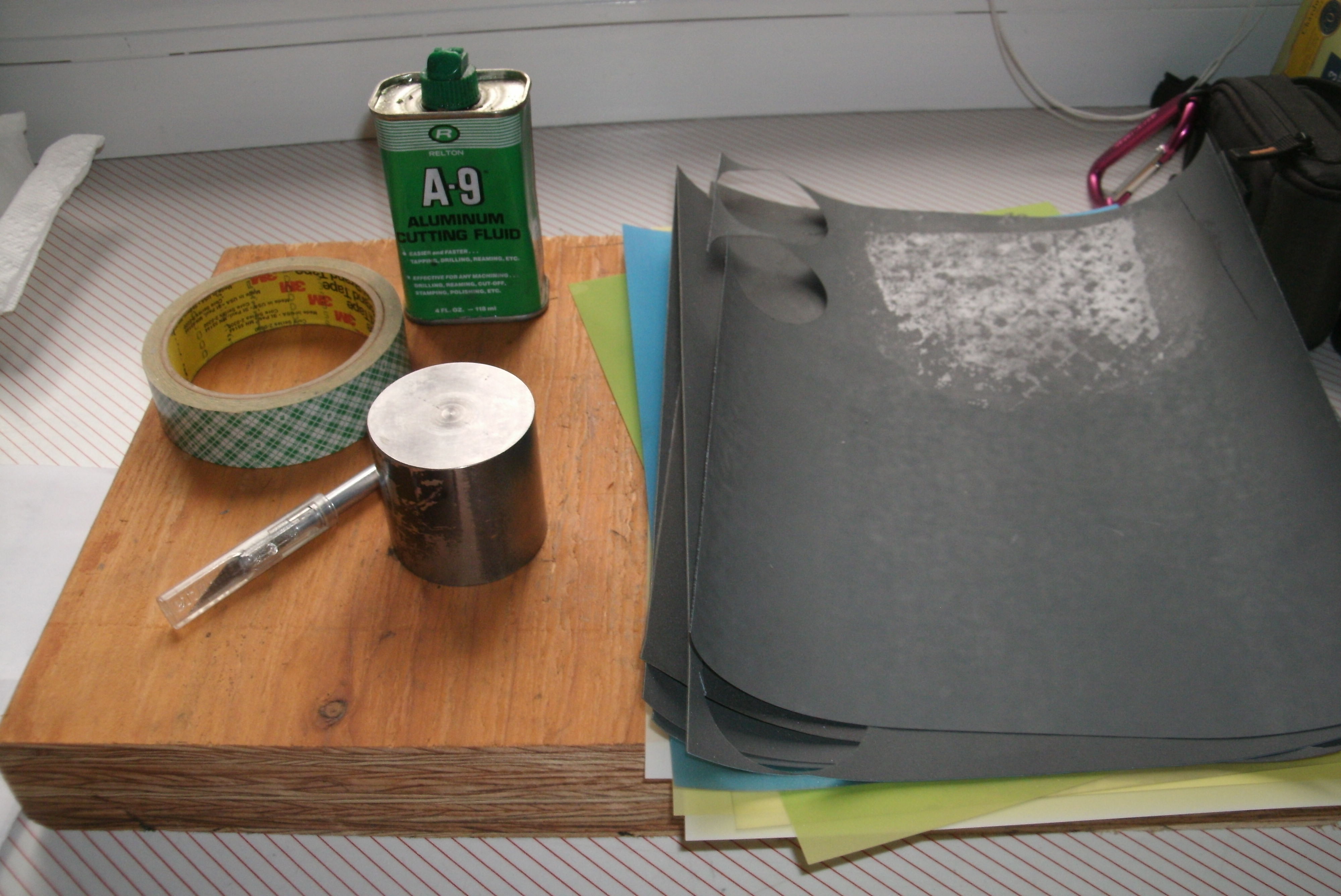

Since the three parts end up about $300 from Tuff Torque, I decided to try grinding/polishing the center case faces and the pump & motor faces (the faces of the “revolvers” which contact the machined faces on the center case). Here’s what I found.
I called machine shops and found hourly rates $70-100/hr. The center case is a complex shape and the shop I visited had no machine with a working head that could get to its faces…the head would collide with other features on the case before getting down to contacting the face needing machining. Even if one had such a machine, the center case needs to be held securely and level (so needs some sort of fixture to hold & present to machine head), and the machine would have to be prepped & setup for the job. At $70+/hour, seemed just the setup time could easily exceed the $25 others have reported for grinding. I couldn’t find a shop that’d come anywhere near that. Buying a new center case for $125 plus shipping seems certainly cheaper than machining at a shop (if you can find a shop with machine that can do it). A shop could grind/mill the revolvers because they are a simple cylindrical shape. But no takers for $25 on the center case…just laughs. So I decided to hand grind similar to SJSmith.
I used gray abrasive (sand) paper (carbide?) used for metal work vs. ordinary sandpaper. For doing the center case faces, I got a 2” diameter, 2” high cylindrical chunk of dense, HEAVY stainless steel to use as a “puck” for mounting the carbide paper (instead of oak block sd SJSmith used). I had both ends milled flat (that was way cheap). I used 2-sided tape to affix carbide paper to the puck. I pulled guard sheet of one side of thin 2 sided tape, and affixed tape to the flat end of puck (tape only 1” wide, so took 2 pieces to cover entire end of the puck). Then I turn puck over onto the tape and exacto knife around the perimeter of the puck to cut off excess tape. Then I remove tape guard sheet from the exposed side of the tape and press the puck onto backside of carbide paper. I use exacto knife to cut paper around perimeter of puck. I end up with an extremely flat hard grinding surface on an easy to handle but heavy cylindrical puck. I turn the puck over and tape another piece of carbide paper onto its other end, so I can use both ends. I started w/ 320 grit as did SJSmith, and that seemed good for starting. On the other end of puck I put 400 grit. As the paper loads up with sluff from grinding it gets less effective, so I pull off the worn paper & tape and replace it as needed. I put 5-6 small drops of aluminum cutting oil on the 320 grit and grind in figure-8 pattern, rotating the centercase around periodically so I remove material evenly around the whole surface and don’t get a low spot from favoring a particular area. I added more oil if puck felt sticking/skipping or felt too dry. I did not push down on the puck because my pushing would not stay even and maybe I’m **** but I didn’t want to risk flatness problems or uneven grinding. I just pushed the puck around laterally and let its heavy weight do the grinding job because that weight stays consistent. I ground w/ 320 grit until all wear marks disappeared. The motor face was clearly scored deepest and that took well over half hour because some tracks were pretty deep. Took awhile. Not easy 15 minute job for me. Maybe deeper scoring in mine compared to SJSmith’s. I probably could’ve cut the time down had I applied vertical pressure on the puck. The pump face on the case went much faster…it wasn’t scored as deeply and its smaller diameter helps cut the time needed. After no sign of gall marks w/ 320 grit, then the polishing starts: I went to 400 for just a few minutes…until the puck slides evenly and smoothly. Then on to 600 (again just a few minutes until it glides smoothly). I did a final pass w/ 12 micron paper (that paper was yellow, not gray). These surfaces are probably now better than new. How long it takes in total is also affected by how smooth you want it to be, but fair to say once you dive this deep into it, you don’t wanna half-*** it.
For the revolver faces I didn’t use the puck. I had a surplus piece of flat granite tile laying around and placed carbide paper on that (grit side up of course), then put revolvers on that and pushed them around (w/ machining oil) just like I pushed the puck around. Not a quick job there either. The face of larger diameter motor took more time because it was scored more than the pump face (just as its opposing center case face was far more scored than the case’s pump face). Also, both revolvers are hard steel so even though scoring isn’t nearly as deep as on the case, it takes awhile to work them out of the steel. Again, if I pressed hard on the revolvers while grinding, it may have reduced the time.
