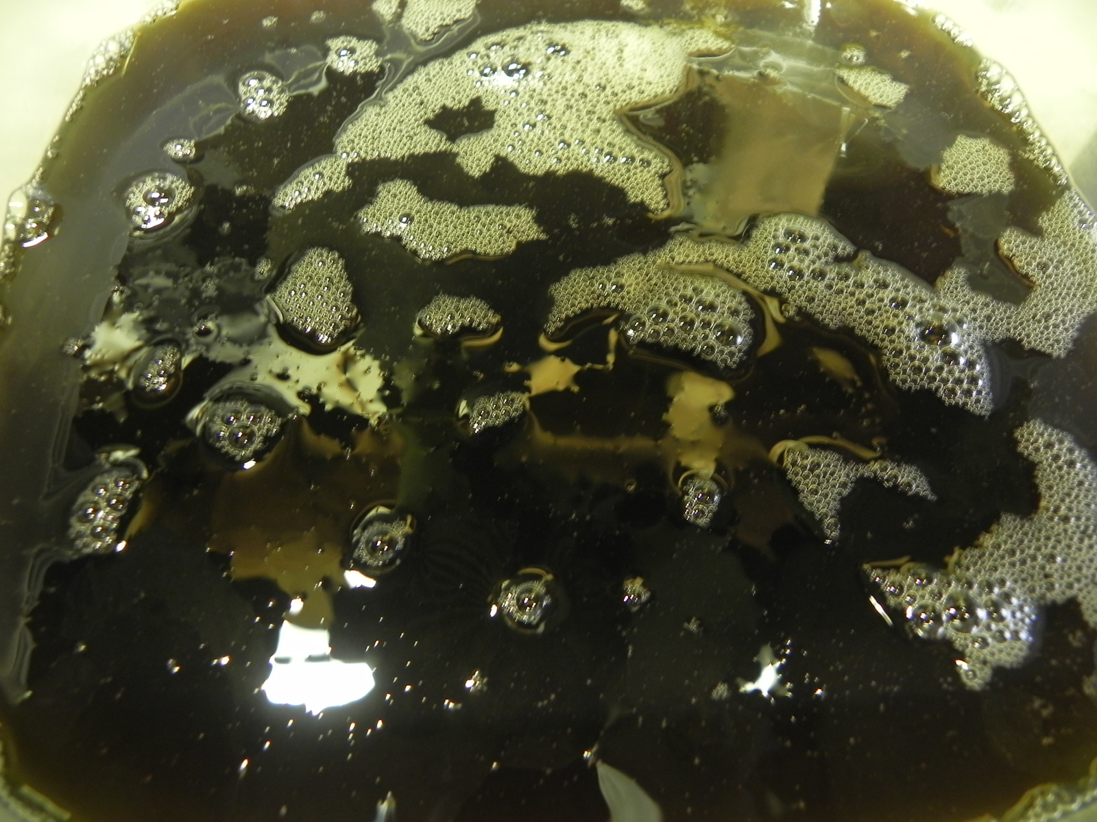

Good day all,
I recently purchased the X300 about two months ago and at this point it has 10.0hrs on the clock. A groaning noise from the transaxle about a week ago prompted me to do an online search for information regarding the transmission.
The results of the search produced a result that I could have never anticipated regarding all of the information available for the K46 transmission.
Taking the suggestions from this thread I removed the unit and poured out the oil. It was black and full of a silvery stream of metal particles as it drained.
Ended up opening the case and installing the drain plugs. Also noticed that the final drive gear train appeared to have been "indifferently" assembled.
Not to be disparaging but the common term, "slapped together" came to mind.
(A bit about my experience, mechanic for 40 yrs specializing in Porsche transmissions).
The motor drive pinion gear slid on the motor shaft to the point where the pinion gear travelled off the end of the shaft by a third of the width of the pinion gear. (There is a friction block that "adjusts" this travel but it would appear that the assembly technician might have made a better selection as opposed to the one that was installed).
A shim for the friction block set the max outboard travel of this gear to coincide with the length of the shaft thereby limiting the uncontrolled slide of the pinion gear on the motor shaft so that the gear remains fully engaged on the spline of the motor shaft.
Observation of the initial position of this pinion gear relative to the "intermediate" gear was such that during max axial travel of these gears sliding to and fro in this uncontrolled fashion on their respective shafts produced a contact between the motor pinion gear and the intermediate gear such that only half the width of the gear teeth were engaged. I believe that this cannot be by design or then why would the engineer designer not have installed a gear half the width?
A stainless steel intermediate gearshaft shim was fabricated on the milling machine with a final fitting dimension achieved by a few minutes on the surface grinder. The intermediate gear then itself required a shim since the gear had ~1/4" travel back and forth on the shaft.
Careless production line quality or is this the standard of the fitting of precision gears in the lawnmower industry ?
The quality of the gears and shafts themselves appeared to be of a good order.
The large differential gear at its outboard circumference had a "wobble" that allowed the outer circumference of the gear to travel in a arc that was
on the order of 3/8". A strategically placed shim on the final driveshaft had the combined effect of bringing the "spider" gears into full contact and alignment along with the support of the differential gear itself on the driveshaft effectively removing the "wobble" of the gear and the excessive end play travel.
All shaft/shim clearances were adjusted to .020".
In the end the question might be, would the metal that is ultimately found over time in the oil that fouls the hydrostatic pumps be produced by excessive mechanical wear aggravated by the poor fitting of the final drive gear assembly?
(Taking into account the break in period where good mechanical practice would suggest that the oil be changed out within a short period of time from new to remove the initial accumulation of metal. )
With the excessive shaft end clearances which allow the gears to travel out of full contact and alignment with one another along with the degree of axial movement of what should be precision fitted parts the wear of these parts must be accelerated thereby loading the oil with particulate matter.
1st photo, Black oil full of metal

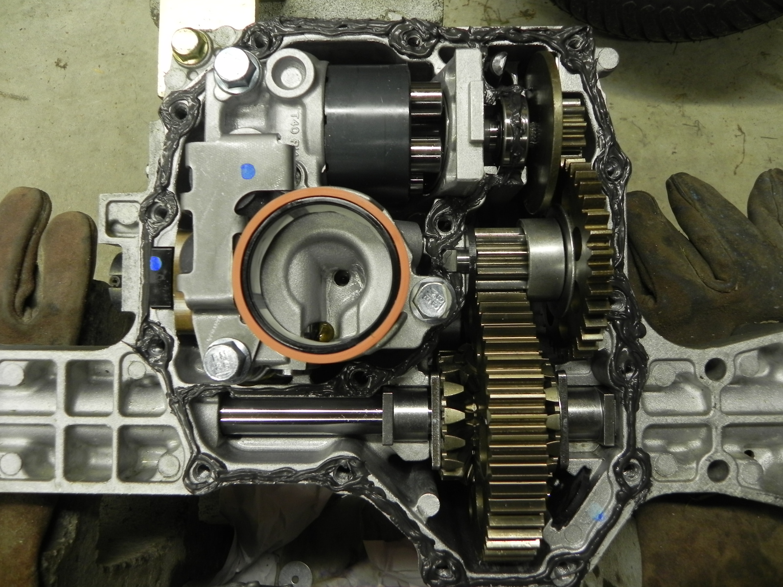

2nd photo, Metal fuzz on one of the magnets, 10.0hrs of run time since new, all of the other magnets held equal metal or more
3rd photo, Stainless steel shims, properly selected factory shims during assembly would not have required this additional work although
it would require the factory to train the assembly people to a higher degree and it would also require additional instrumentation,
tooling and time on the assembly line.

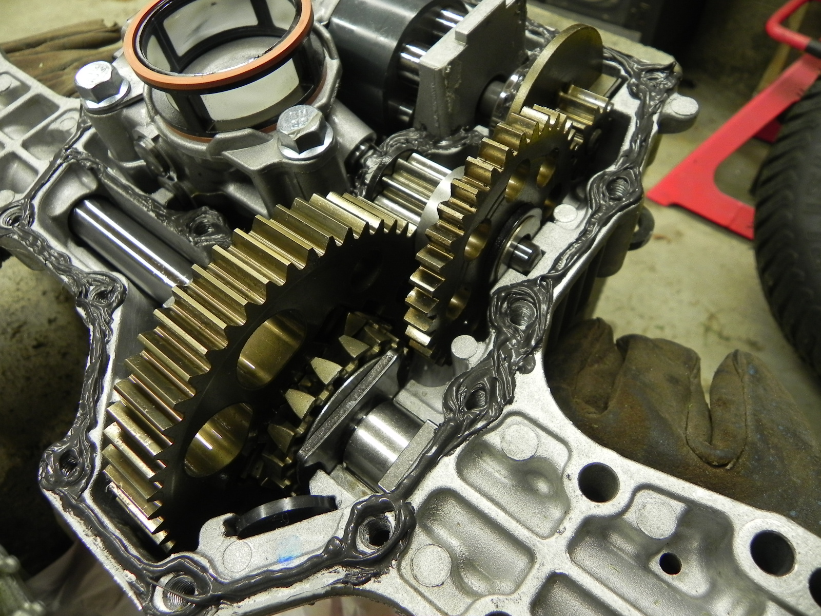

4th photo, Pinion gear to intermediate gear, full contact now
5th photo, Intermediate gear inside shim, the intermediate gear was allowed, by factory assembly, to travel along the intermediate shaft ~1/4"
for no apparent reason. One could see that under changing conditions of loading that this gear could conceivably, "slap" back and forth between
the factory shim and the shaft collar, (the shaft collar then with this amount of available travel would be slapped into the side of the differential
gear by the travel of the intermediate gear).

Photo 1 Closeup of intermediate shaft shim. This shim contains the end play of the shaft itself and holds the factory
shim, (the thicker of the two washers in the picture) in close proximity to the intermediate gear.
This shim also promotes the full alignment of the intermediate gear and the hydromotor pinion drive gear.
Looking through the holes in the intermediate gear the circumference of the "inside" intermediate gear shim can
be seen. The inside shim contains the movement of the gear on the shaft from "slapping" back and forth on the shaft.
Photo 2 Closeup of the shim on the driveshaft which sets the driveshaft pinion gear in position to contain the spider gears
within the differential gear in the proper position and also remove the excessive end play dimension to contain the
large differential gear from "wobbling" on the shaft. If you observe you can see the factory end play shims, (the "horseshoe" shaped shims)
which are apparently not measured and fitted at the factory to take up the differential gearing shaft end play.
All of the differential gearing, (spiders/spider shims, driveshaft pinions, and the differential gear itself), all "jingle" around on the shaft in a form
manner that I have only observed on high mileage, 400k+ diesel truck transmissions.
