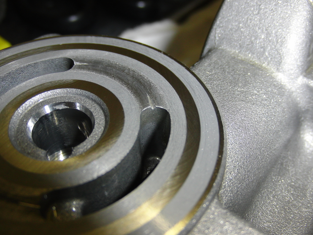

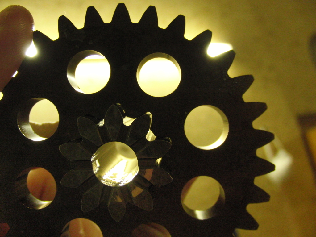

I have just taken apart the rest of my K46AM. The pump and motor feel quite alright (very little play of pistons in bores), but the center case has some wear. Less than I expected though, except for those nasty scratches around the holes. I think I won't even replace the pump and motor and see what I'll do with the center case (sand it or mill it or coat it or replace the surface with something harder.. I'm not sure yet).
The differential gears are NOT made of steel but chrome plated powder metal and have serious tooth decay.
The other gears have wear all around too, so I will replace the whole gear part and add shims in the proper thickness in the process.
Straight cut gears can transmit more torque than angle cut ones too and in this application, noise surely doesn't matter. :)
I'm very confident the early oil change I did (mine had drain plugs, so it was convenient) saved the hydraulic parts from silvery-mineral-oil-death. The gear part however is terribly assembled/designed and can't be expected to last more than the 250hrs life time rating. It's not the quality of parts that's bad, simply their arrangement.
This is a little saddening, as even the K46 could have been a great transmission with only tiny bit more investment in production. I can't imagine an engineer screwed this up. The unit has to have been deliberately worsened by people higher in the command chain. "Make it break and make it cheaper!".
So regarding your questions andrew, I think you're in the ballpark with your numbers. There might even be more K46 around.
Now I too would like to know if the K66 and up have similar flaws.
Best of luck to the other rebuilders,
Stefan
