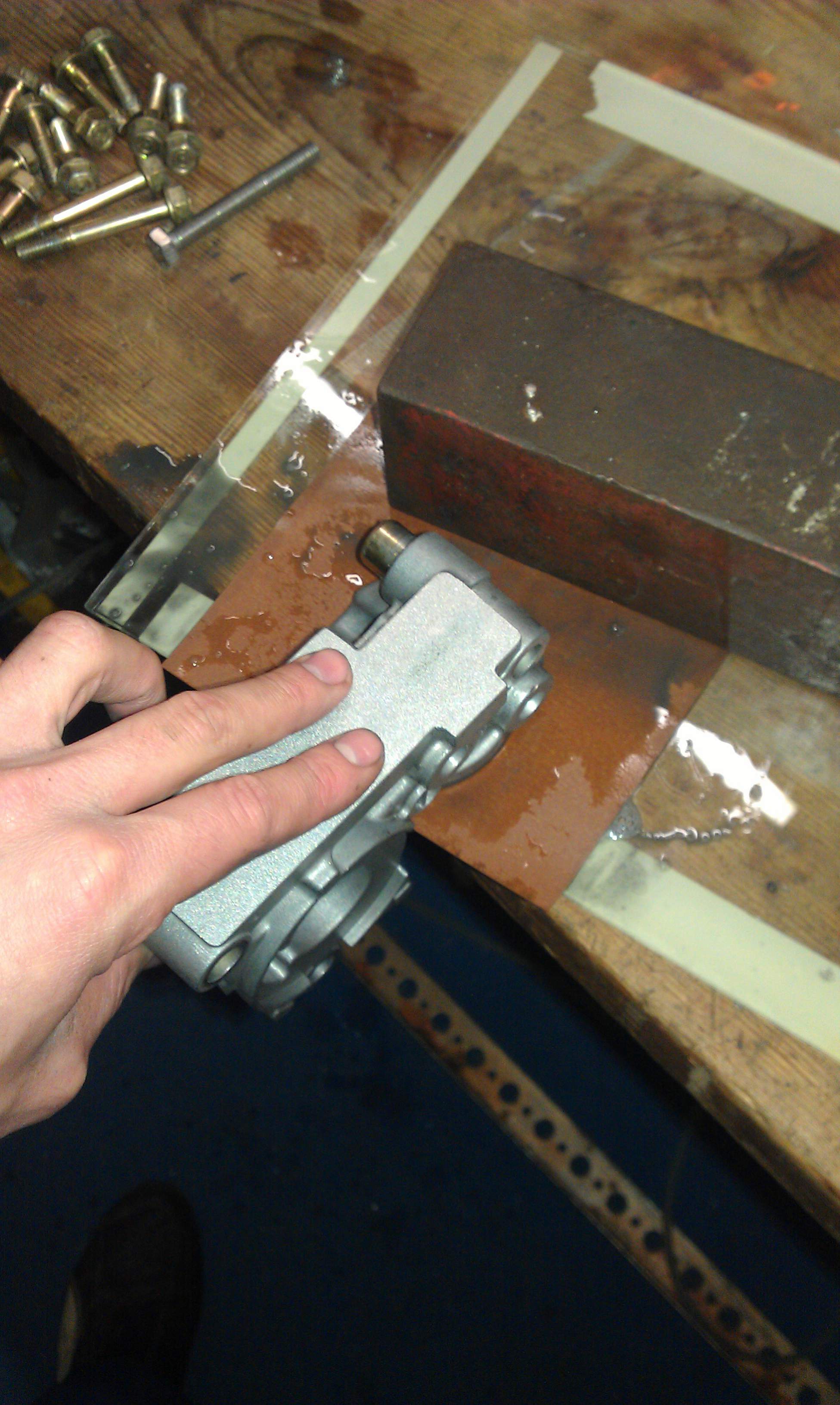

Speaking of which: I was trying to shim out the gears today (and will have measurements soon), but was unable to do so with the differential gears. No matter what, the final drive gear is too wide to let the pinion gears ever get in full contact with the side gears. They can always move about way too much. I will wait for the new parts and see if they fit better, else they will have to be ground down to get tighter together.
I'm still completely lost why there's so much play by design in there.
I also sanded down the wear of the center case with 1200 mesh paper, then gave it a little polish. Looks good now! Great idea. Yes I left a barely visible ring on the pump side, but I lost motivation. :) Also, a tiny bit of roughness is good to keep an oil film on.
The underlying surface I use for my sandpaper is glass out of an old (as old as possible!) computer scanner. They're reasonably thick and of perfect flatness, and free. I didn't sand the pump or motor, but carefully deburred the edges of their kidney ports with an oilstone. Maybe this helps in not eating up the center case faces.
I tried to remove the two valves from the center case with a neodymium magnet and some strokes with the back of a screw driver. They came out no more than 1.5mm and had scratches, looking down into the center case. So I pushed them back in, still unsure of their function or if they even should come out.
