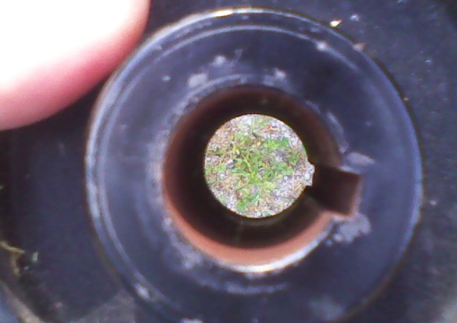

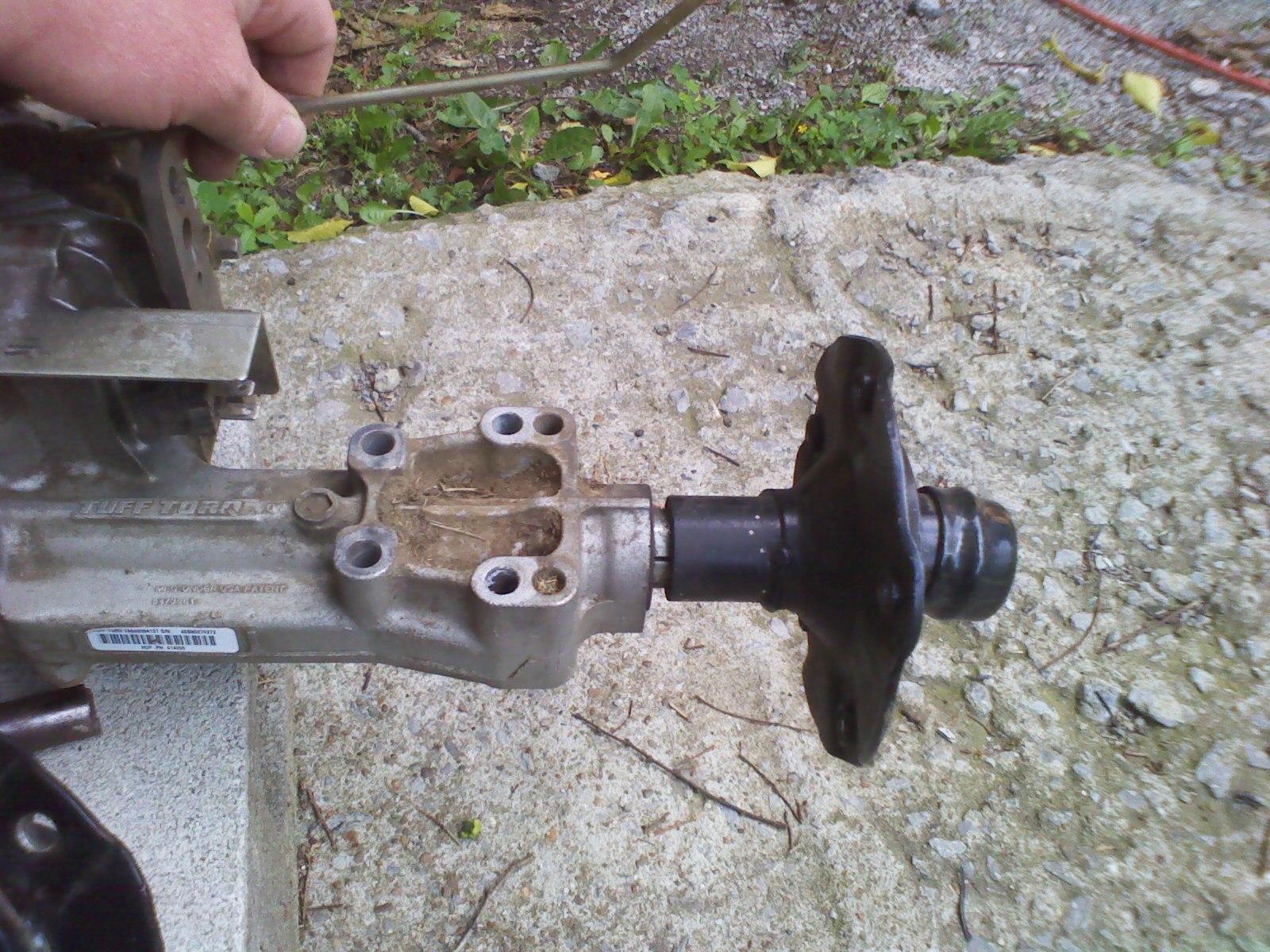

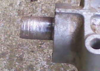

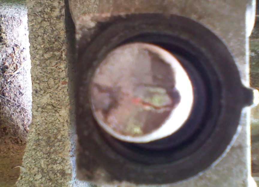

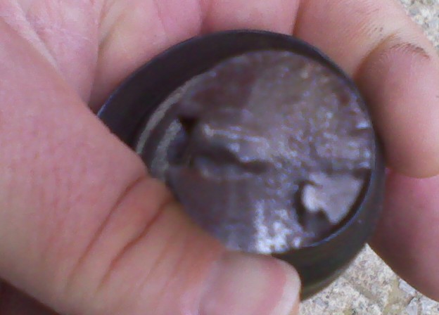

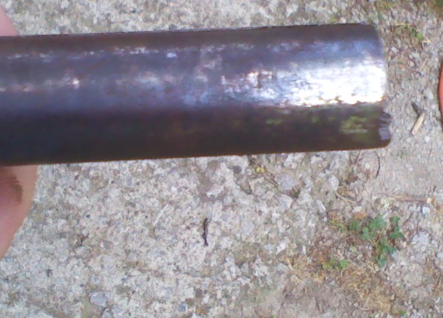

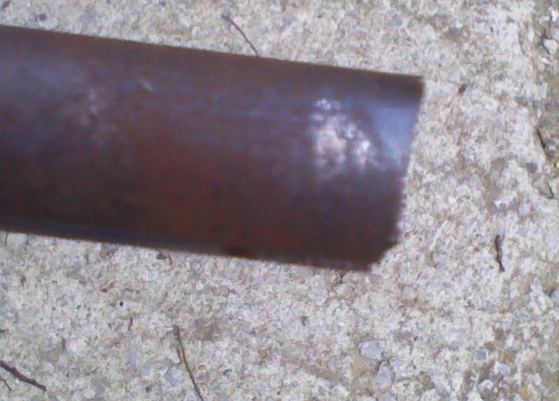

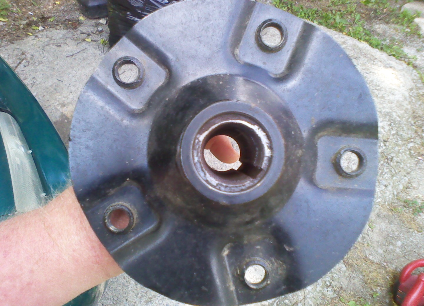

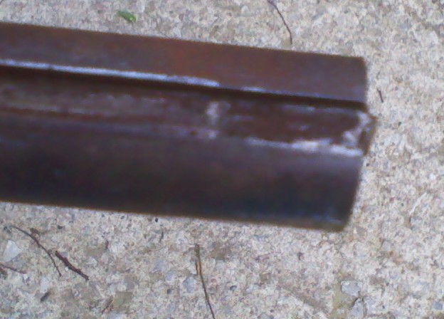

I have some problems with a Husqvarna LGT 2654 Lawn Mower. I have a Tuff Torq K46BN transmission. The problem is that the axle broke on the left side. It has the wheel hubs and broke inside the wheel hub. I called Tuff Torq and the directed me to Husqvarna. Husqvarna doesn't want to cover it even though its a factory defect. They want to push it back on the Tuff Torq. Its my girlfriends parents mower and they are wanting to get it fixed. I am not happy with the situation at all. I told them today. They don't have to worry about me ever buying any of their products. The mower was purchased at Lowes. The mower was made in 06 according to the manufacturing date that is posted on the serial number at Partstree.com. The mower was bought in 08. Tuff Torq will not admit or even look at the pictures of the transmission. I could understand it was a pump or something due to wear and tear going out.
The guy at Husqvarna customer service was implying that they didn't take care of the mower. Gee I don't think an axle is a maintenance part. It has signs of not being a clean fresh break all the way through. So thanks to Tuff Torq and Husqvarna. I have 3 options or 4 actually. 1. try to get it welded, 2.replace the manufacturing defective axle $80 plus the hub assembly that sits around the axle, plus S&H and time, 3. buy the transmission assembly for anywheres from $616.81 plus shipping and handling to over $868.87 plus 15% on shipping and handling, or 4 buy a new mower. Definitely will not be a Husqvarna. We have a Toro and I am glad to have it. We also have a Cub Cadet Model #2185. I have had no problems out either of those mowers. The Cub Cadet has had some work done, but to be expected since it was built I think in 1994. I really hope that if any you out there buy a new mower. Look at your warranty. You would think that it being a manufacturing defect and having several people who weld for a living and know what they are looking at tell me this. You would think that they would honor the warranty and make a happy customer. I will send some pics when I get it figured out for you to see for yourselves..... 0603131104a.jpg0603131104b.jpg0603131104c.jpg0603131104d.jpg0603131106a.jpg0603131106c.jpg0603131107c.jpg0603131110a.jpg0603131110b.jpg0603131110c.jpg0603131111a.jpg0603131112c.jpg0603131112a.jpg0603131111b.jpg0603131112b.jpg
I'm no metallurgist, but it appears to be a defective axle. Warranties suck. That's why I've started to buy used at bargain prices, and service myself. Forums like this have really helped me with finding parts and rebuilding hydrostatic transaxles.

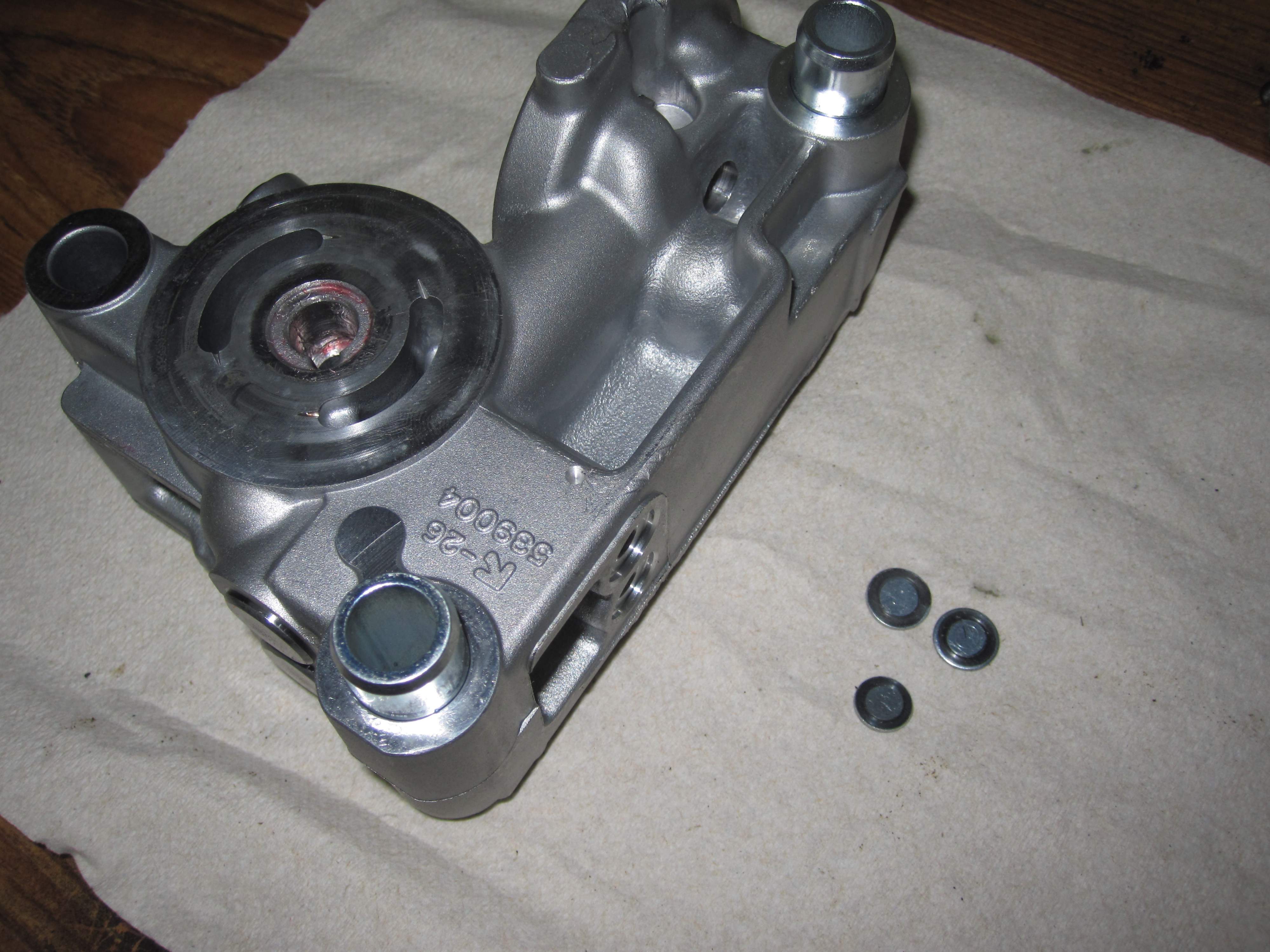

I need help. I'm in the process of rebuilding a K46. And I have 3 shims, shown in the picture. I know one goes on the end of the motor shatf and another goes on the end of the pump shaft, when the go into the center case. But I don't know where the 3rd one goes. 2 of them are larger than the 3rd one.

Sorry to ask, but are you sure this is a K46? I've never seen those parts on pictures, nor on diagrams, parts list and not in my K46(AM).
