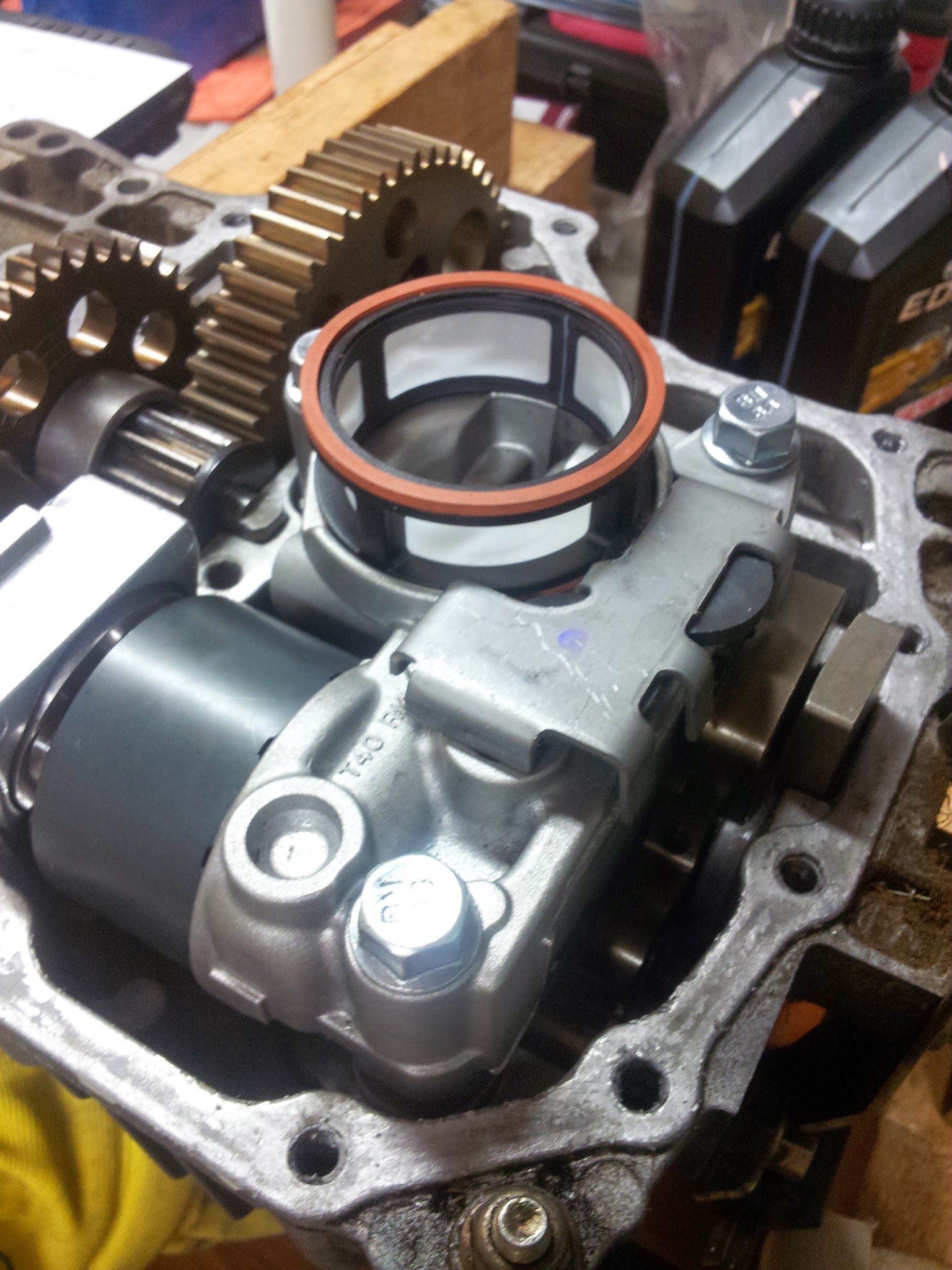

So, I've read all these posts and watched a couple videos before tearing into my son's L110 mower transaxle. What I'm trying first is thorough internal cleanup and machining (sanding) the pump and motor and there corresponding mating surfaces on the center case. That all went well and the parts all smoothed out nicely. Although it took a good bit of sanding with 400 grit sandpaper and cutting fluid. I have it back together on the bench and I'm waiting for a new filter and filler cap. My question regards the oil to put in the unit. I was going to put mobil 1 5w-50, but I can't find it locally. In fact, I can't find anywhere local that has any brand of synthetic 5w-50. I can, however, get mobil 1 15w-50 locally. I'm thinking that the difference is negligible from 5w to 15w, as it's at the cold viscosity end of the oils capability and he won't use this mower in cold weather anyway. Am I wrong on this, or is the 15w-50 "close enough"?
   / TuffTorq K46 Repair Guide with Pictures #902
In my local "Reiley's" auto parts store I couldn't find it either - there must be 50 brands and 100 different viscosity ratings on one wall:) Had to ask and sure enough they had some 5-50. The biggest requirement is "Full Synthetic" - the viscosity not so much. Synthetic will hold up much better taking the heat. Using the 15-50 should be fine as long as you do not live in a real cold climate.

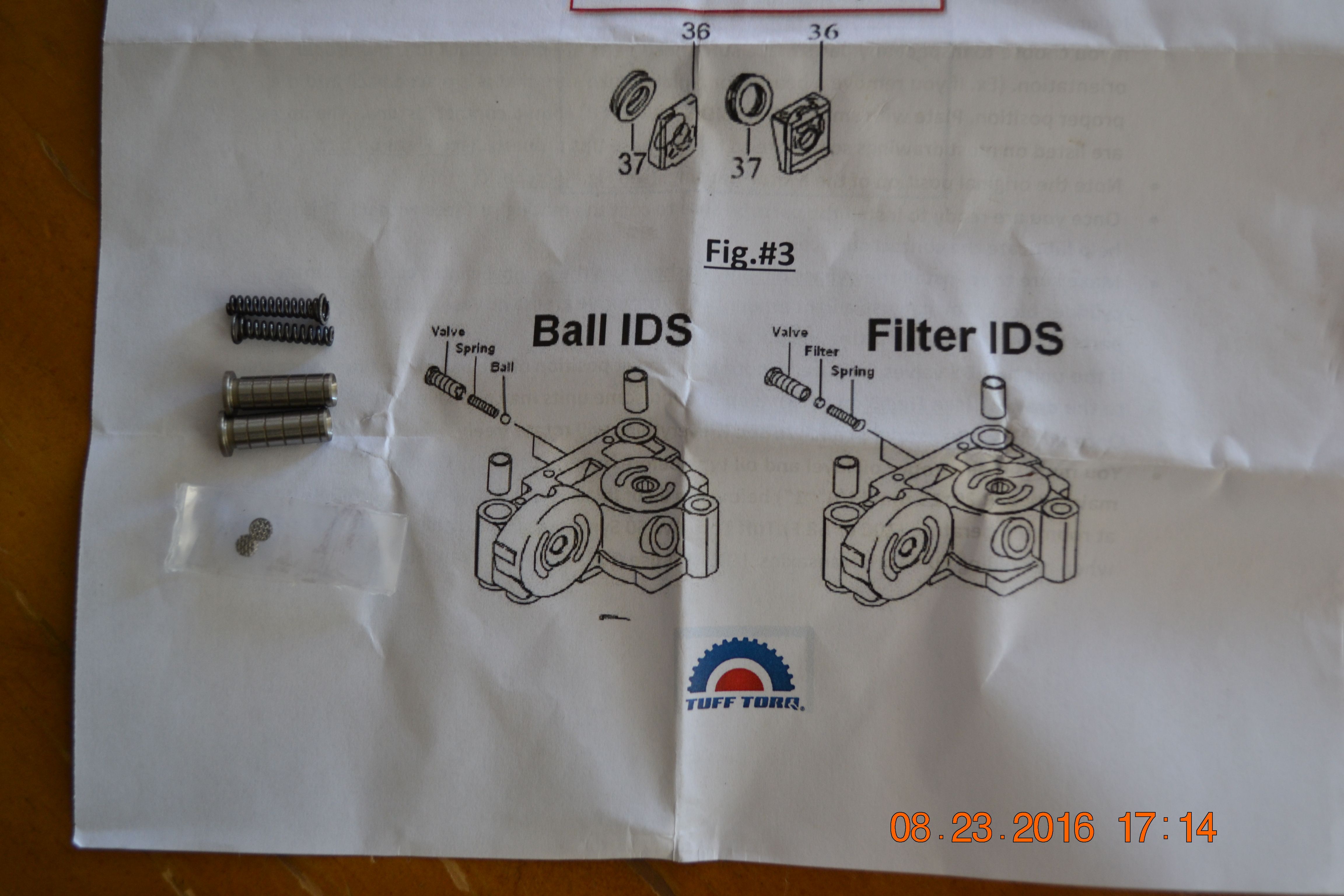

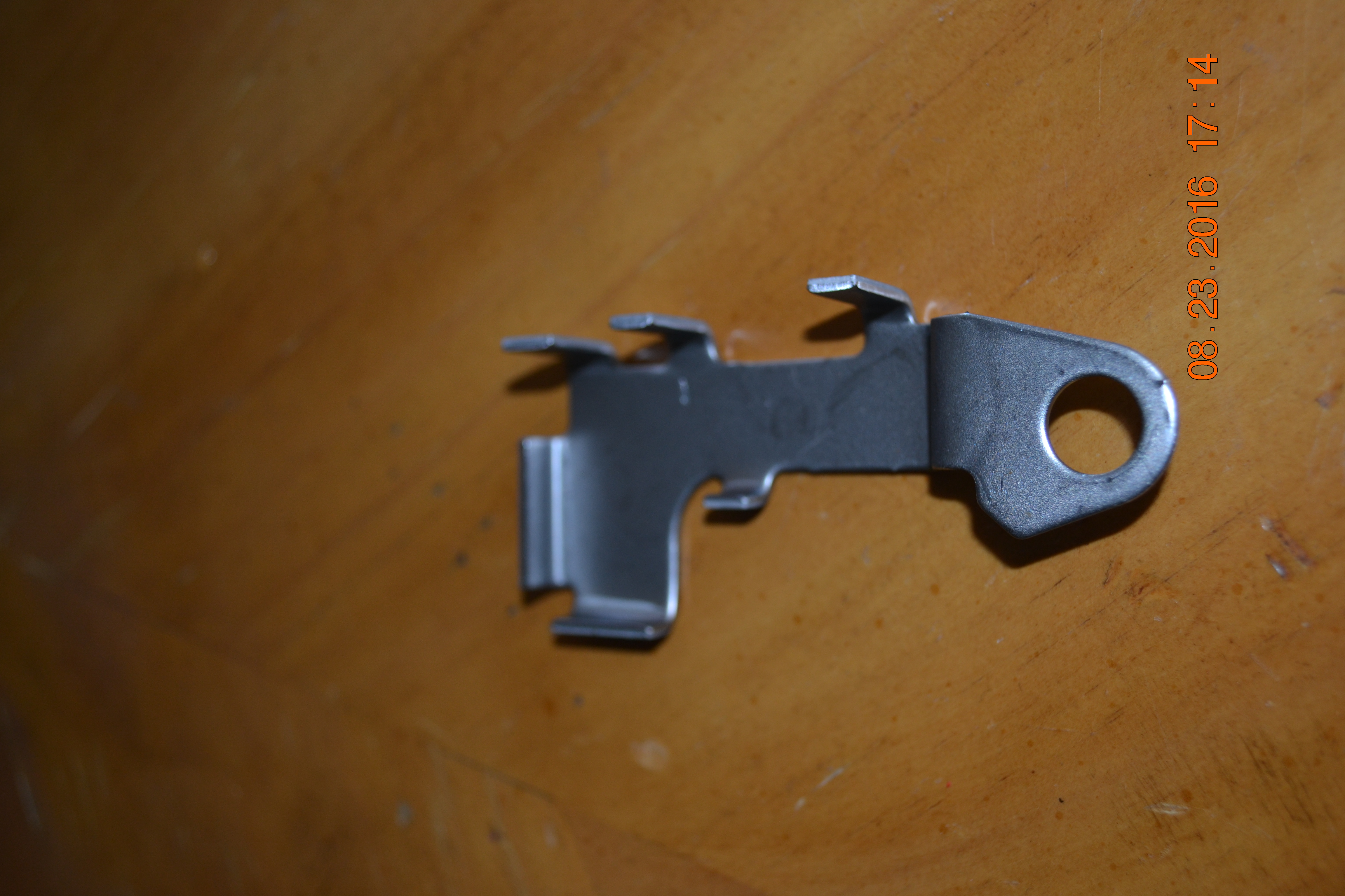

I just ordered some parts from Tuff Torq to repair my 2002 JD L110 (K46V-0144099).
What is the silver bracket piece?
Should I replace my plungers with the different piece (plunger->filter->spring) or keep the ones that were in it (plunger->spring->bb ball)?
I didn't know if the one was a newer improved version? I have the ball IDS, they sent filter IDS parts.
Thanks!!!
   / TuffTorq K46 Repair Guide with Pictures #907
It may be too late, but this is where the bracket goes:
I've tried both IDS designs, but didn't notice any difference between them.

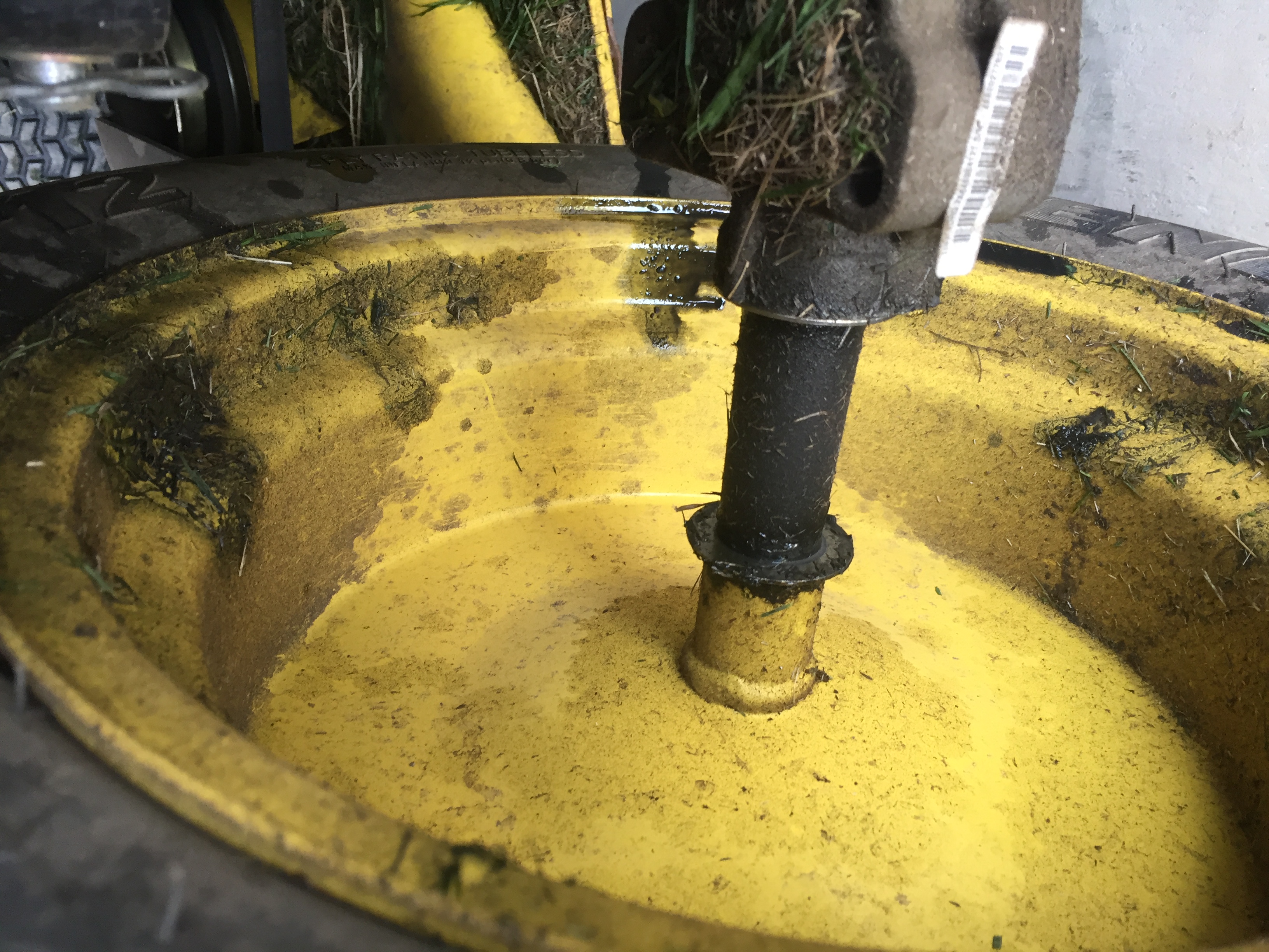

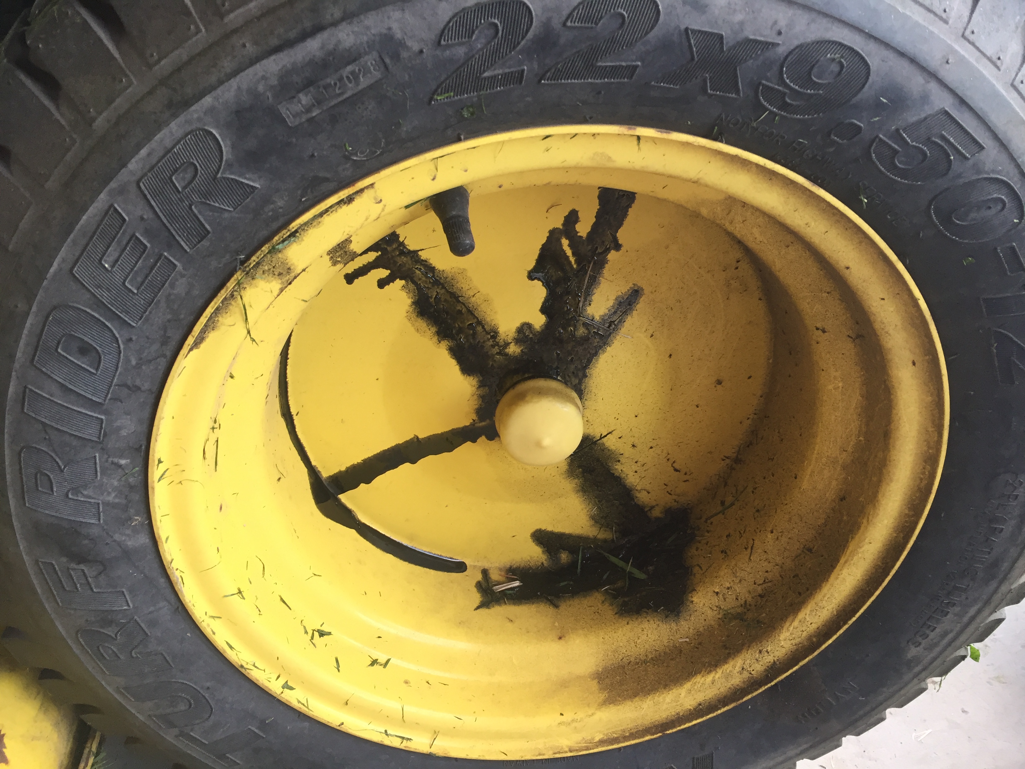

I have a JD D170 Lawn Tractor. From what I can tell it has a K46 transaxle and my case it's leaking from the left axle.
Reading this thread would lead me to believe that I can just do a seal replacement:
https://www.tufftorqservices.com/in...epair/K46_T40_TLT200Axle_Seal_REPLACEMENT.pdf
vs paying the $1500 my local repair shop wants for a brand new transmission.
Can anyone confirm if I am on the right track here. I figure I have nothing to lose to try other than my time and what should be small cost for the parts.
