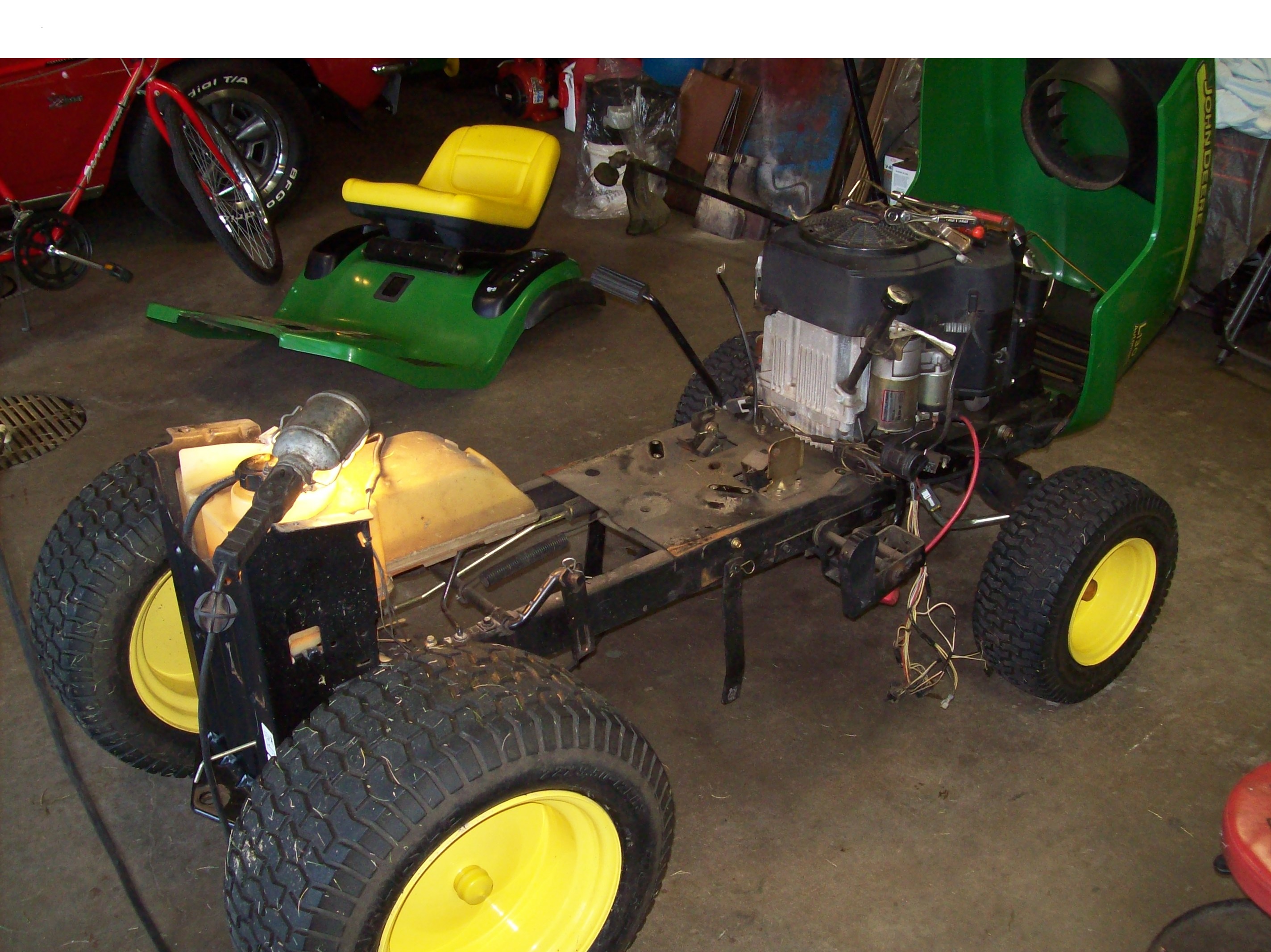

Couple comments for anyone looking into this. John Deere L130 mower with the Tuff Torq k46. Changed oil and cleaned out the shrapnel on mine at 300 hrs, pretty much shot at 500. These transmissions use the same oil for the hydraulics as in the differential. Way different application there. And those differential gears are some sort of powdered/pressed metal. Seems to make for an early failure when the metal starts flaking off and contaminating the oil, destroying the hydraulic unit. Just a cheap Chinese throwaway gearbox. Can't believe that undersized unit I saw in mine - with a 23 horse twin Kohler engine. large wheels/tires, and the 48" triple blade deck. Replaced my hydro with a Peerless 2000 unit that at least has separate hydro oil and gear lube. Not sure how this unit will last, hard to compare ratings and applications.

Will do. Install was mostly a matter of making mounting brackets, reused and modified the originals, and cutting/shortening the shift linkage. Did slot the frame holes to move the new unit back just a bit in order to use the original drive belt. Axles were about 3/4 in shorter than the k46, no real problems there, cut the spacer sleeves. I started out by taking all the sheet metal and plastic body off the tractor, cleaned and lubed everything while I could get to it. But now I see that Surplus Center has the K66y Tuff Torq hydro trans in stock for $349. Might be a good way to go if this doesn't work out. I do have a spare set of wheels with the 1 inch dia. keyed centers. And they have a Hydrogear unit that looks promising for $269. That Peerless unit that I got is labelled Silent Track, sure not very silent that I can see/hear. Lots of differential gear noise. Time will tell.
   / TuffTorq K46 Repair Guide with Pictures #930
Stripped down except for gas tank.
