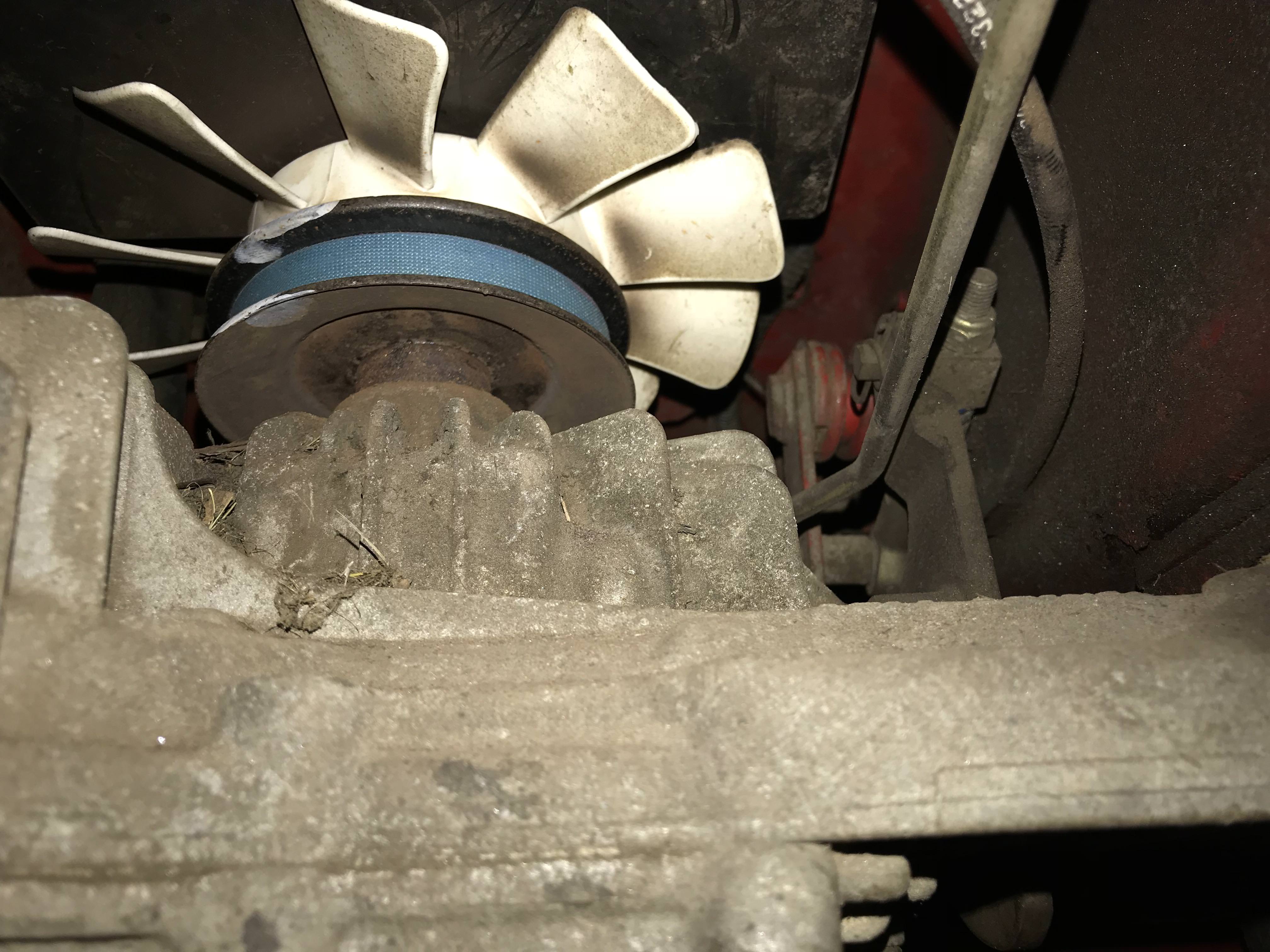

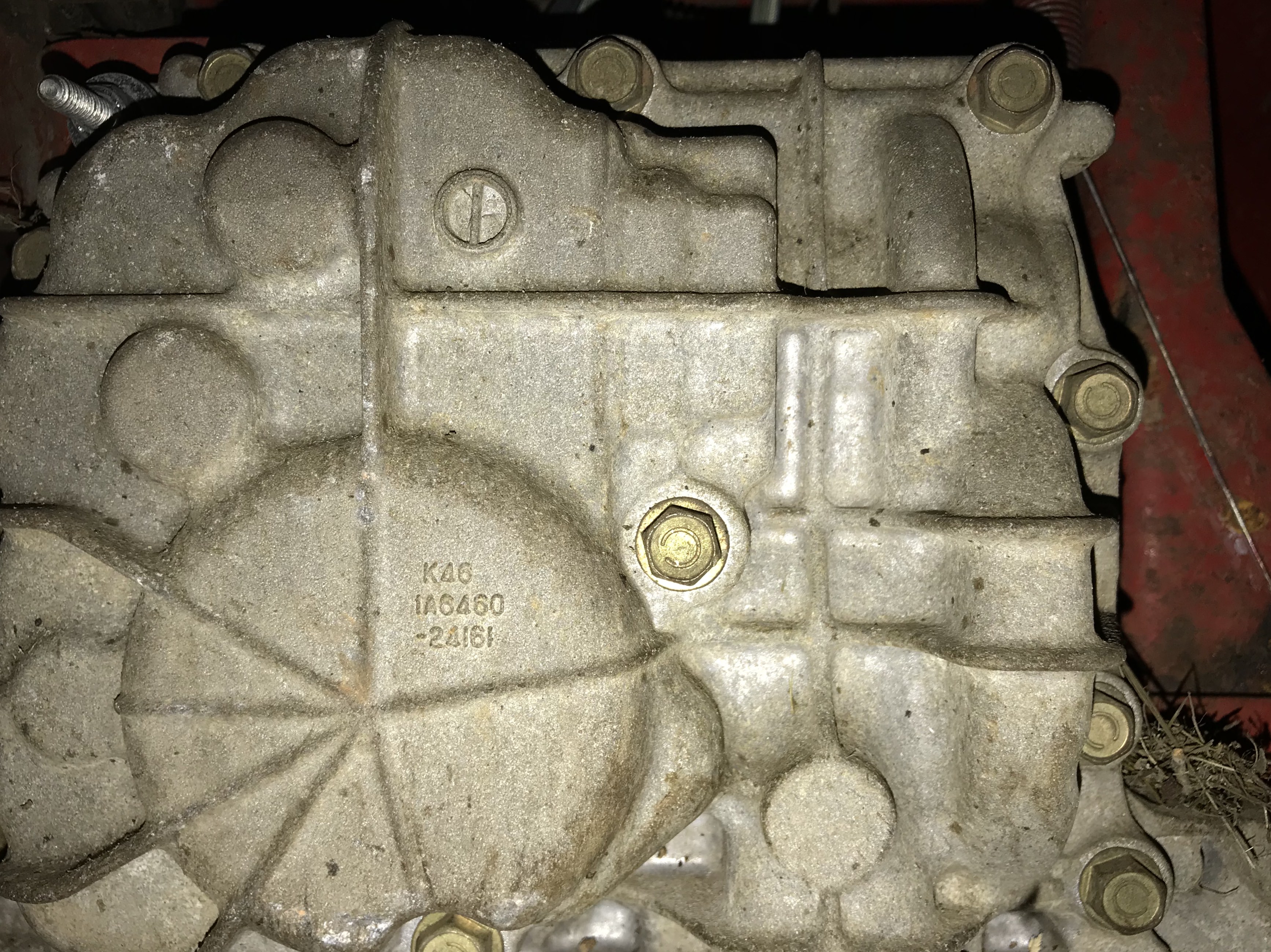

Hey guys I am new and I have been reading this great thread.
I discovered my grandfathers old Snapper LE14.5 38 mower in an old garage and figured it would never start. Turn the key and it started right up. The problem is when I engage the transmission it makes this loud racket. The pulley seems to be loose. I will attach two pictures but what I am really wanting to know is if the two bolts on the bottom of the transaxle are drain bolts?
Here is a picture of where the drain bolts are if has them or you want to drill your own. Sorry for the late reply but was not getting notifications.
That is interesting...are the raised boss's there to be drilled & tapped? Maybe there is a way to get a tube up to the seat with a dipstick and/or fill tube.
ETA...Just looked at my K46ac...it has those raised boss's that can be tapped.
Problem is the fill port, it is right under the fan and also not easy to remove. Something might be done to rig a fill tube or there are some K46's that have a reservoir tank. But it is easy to remove and turn over to drain so not worth the mod or drain plugs, for every 3 years or so.
