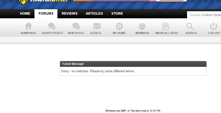

Please forgive my stupidity, but: How do I search for "P901"s posts to this thread? Many thank this user for their inputs and I'm trying to find - but having to go page by page by page. With 97 pages...
Thanks for any help.
Jay
   / TuffTorq K46 Repair Guide with Pictures #967
   / TuffTorq K46 Repair Guide with Pictures #968
   / TuffTorq K46 Repair Guide with Pictures #969
Not sure what I was supposed to see on this link, but, it didn't come through:
Opps I guess a i the thread search can't be sent.
If you type the username in the search menu of this thread (between Thread Tools and Display) you can see what I sent.
   / TuffTorq K46 Repair Guide with Pictures #970
I did that. But, after doing it again, I clicked into the threads of others who'd Replied to P901 and found the posts that way. Thank you!!!!!
