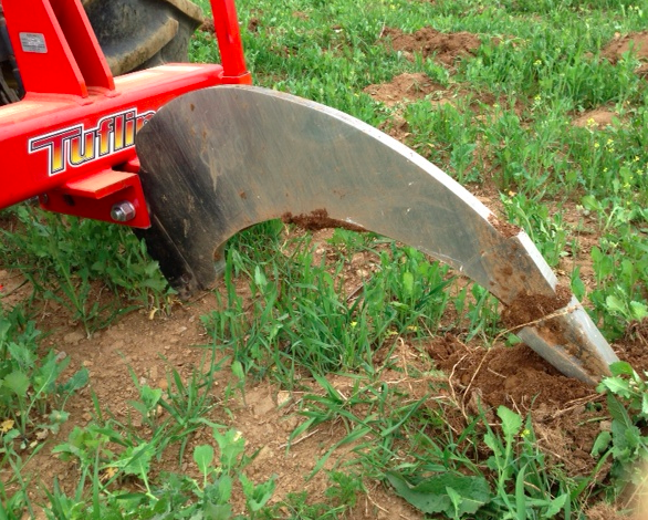

I bought a Tufline 1S-28 (Cat 1, Single Shank, 28") from my local dealer for $800, not a bad price. I needed it to rip the vine rows (15 rows @ 475 feet each) prior to planting my vines. I have about 10" - 14" of loamy top soil, then a clay layer from 15" to 25", then a sandy loam further down. The top soil and clay layers have rocks of all sizes. The goal was to open up the clay layer to improve drainage and root penetration.
I planned to use it with my Case DX33 Hydro (33 hp) with R4 tires. Tufline calls for 30 hp minimum, so I wasn't sure what was going to happen. I did several test rips, and to my pleasant surprise, the DX33 was able to rip at full depth - as long as I didn't hit any big rocks. Small rocks were no problem, but bigger rocks (10"+) stopped the tractor with the wheels spinning. It is definitely usable with a 33 hp 4wd tractor.

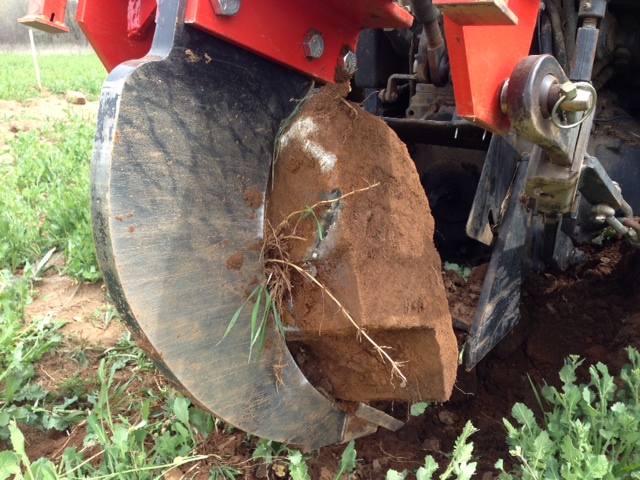

A friend has a JD 5200 45hp full size tractor with ag tires and offered it to me. Bigger is better, right? I decided to use it to have a power margin. The good news is that it was able to easily pull the subsoiler, and extract large rocks bigger than 10" in the process. The Tufline does a good job of ripping the soil. The bad news is that I discovered what happens when an unmovable object (deep, giant rocks) meets an unstoppable force (the JD). Pictures below. Maybe I should have just used the DX33.
Overall, the Tufline did a great job. I'm thinking about other uses next - burying wire, irrigation lines, etc.
Rock Extractor! Yea!
Deep rock, never saw it coming!
Shear bolt did it's job!

Glad to see that the shear bolt worked!
I have the 1S-24 and use it with my JD 3520 (37hp). I loaned the subsoiler to a friend with an older JD 5000 series, and he subsoiled 15+ acres with it. Fortunately, we haven't encountered any unmovable objects yet. I can barely pull the subsoiler at max depth with my JD 3520 in 4WD with R4's. I need more weight.
Have been very happy with the Tufline. It is built rock-solid.
