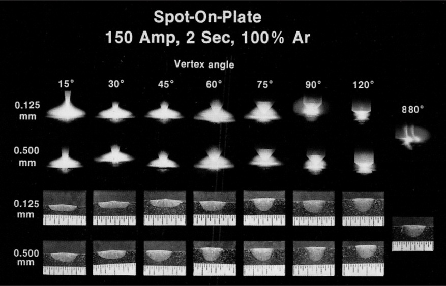

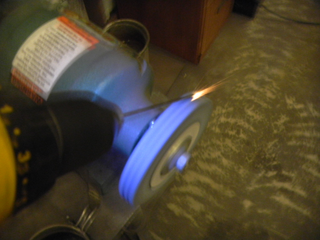

Zap over on Welding Web posted how he uses a drill motor to sharpen tungsten. For years I did just like Gary, and used the side of the wheel. But after seeing how Zap does it, I started doing it that way.
Someone posted this chart on different ways to sharpen for penetration, I guess I've been doing it wrong all these years.:confused3:

The reason you don't want to sharpen it sideways is the small grooves left from grinding will cause the arc to jump off the side of the tungsten and not travel down to the point of the tungsten. By grinding it inline, your electricity will follow the grooves down to the end of the tungsten and give you a very nice weld puddle without arcing off to the side.

deereman, morning.... If you sharpen thoriated tungsten, thorium is a radioactive element..... I use the drill motor, sanding belt method.... 60 deg or so works for me...

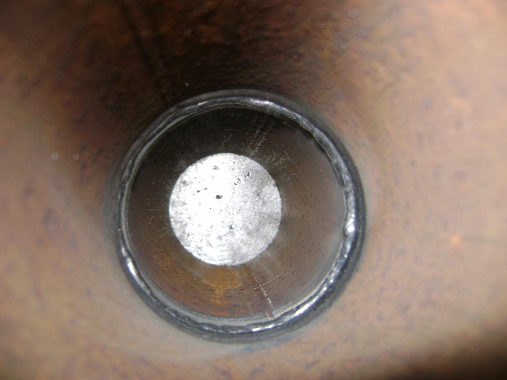

That chart is just the opposite of what I found to be actual use on root passes. Sharp point as in first photo produces highly crowned bead inside of pipe where as blunt angle as in far right photo produces a flatter root pass. It may be as the photo suggests for flat penetration into the base metal
That has been my experience too. Only Tig welding I've done on pipe is for testing. Here on the west coast the pipe fitter's unions are very strong. It's not real healthy to get caught welding on pipe when you belong to another union!:eek:

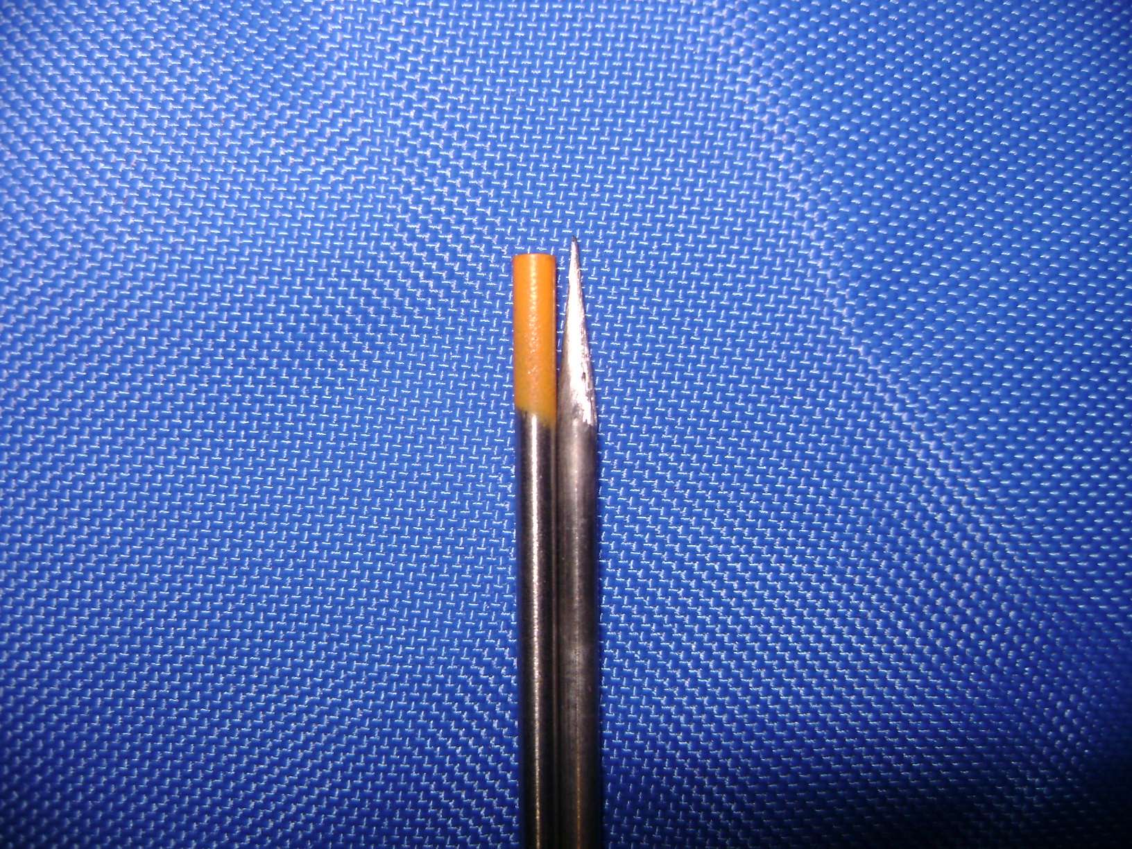

This is how I sharpen tungsten for the root pass on pipe. I like 37-degree bevels, knife edge, with 3/32-inch gap, run around 95-amps using 1/8-inch filler. For the hot pass I'll go up no more than 10-amps and switch to 3/32-inch filler. This is the best way I found to avoid suck back.
That is the same with me, it produces a nice rounded bead with a little rise to the center.
