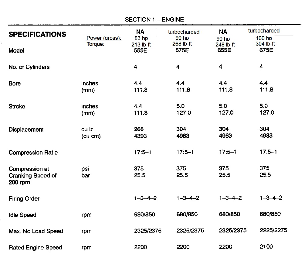

I put together some engine specs on my series backhoe you might find interesting. Note the 4 different engines are very similar with the 575E, 655E, and 675E being identical in displacement and compression ratios. The turbo 575E has the same HP as the NA 655E with a little more torque.
The shutdown procedure in my operator's manual says to idle the engine down to 1000 RPMs for two minutes before turning it off.
