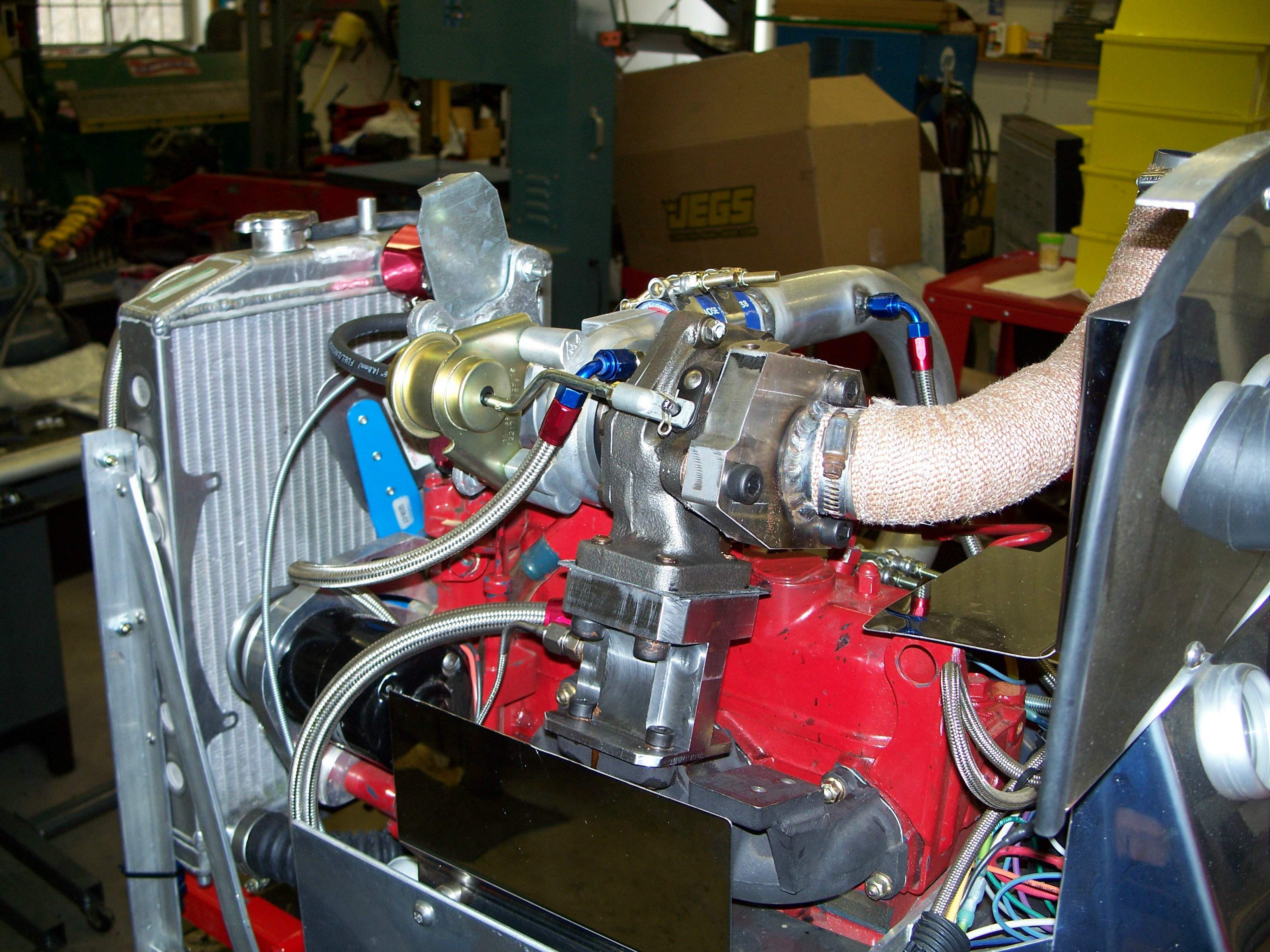

I've done a lot of work on D1105 engines which is what is in your 1100. Have about 6 of them here now. Not sure on room in your engine compartment but Kubota made a D1105T which is a turbo version of your engine. If you want you could look at the factory manifold and turbo setup and see if it will fit. They are in some Bobcat mini excavators.
We make CNC adapters that will allow you to put a good little Mitsubishi twin scroll turbo on a stock D1105T manifold. Yes there are piston and some other differences internally on the D1105T but we have found in a mild perfomance setup the non-turbo pistons hold up better than factory turbo pistons.
