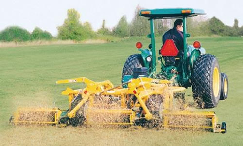

I have a couple attachment questions regarding turf/lawn care attachments:
#1 If you wanted to seed a new lawn wit h your tractor, what would you use?
I have seen these huge (and expensive) "Seed Drills" that can be used for primary seeding or overseeding: 2010 LAND PRIDE APS1572 Other For Sale At TractorHouse.com Can you use just a standard PTO broadcast spreader like this to seed a lawn or overseed? Land Pride Fertilizer Spreaders
#2 Does anyone make a 3-point hitch mounted dethatcher? I've searched and the only thing I've come up with is a "pine straw rake".

Like Mike said, it depends on how much you're planning to do with it and what type grass you're planning on taking care of.
They do make powered de-thatchers, but most of them are for large acreage and are usually self propelled. Do a search for "verti-mow" or vertical mowers.
Here's one that is 3ph.
