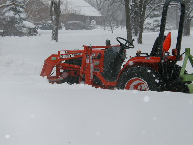

don't think the ags will help u. have used ags with the old ford 2n , needed chains as the back end was so light because of the weight of the fel. snow on ashphalt is not a problem with clogging up the threads, it is a matter or weight(mass) and power. my b 2400 with 4wd no chains and not loaded has moved all kinds of snow, doe is slip ? yep. bu ti just take a smaller bite and keep workin. ags would not help. i use the fel for 90% of snow removal and the BB for the rest. and we do get a lot of heay deep snow up here. will post a few pics from last years storms, all taken care of with b2400, R4 tires(not loaded) and no chains. u make the call

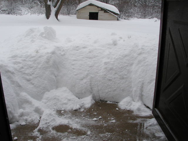

this one is a shot of the snow out the back door, could not open it had to go out the front and walk around and shovel enough away to get the door open

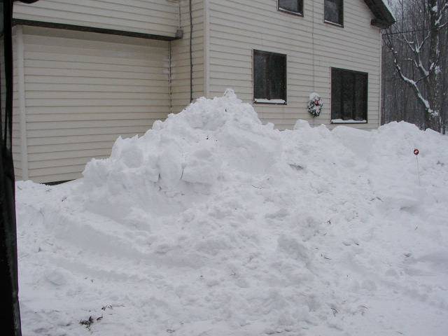

this is part of what i moved

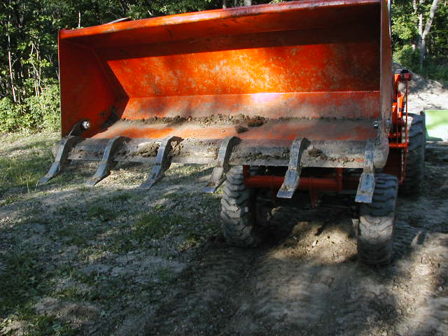

Now rest assured, the R4's will work in dirt also see attachment. all types of tires will work better than others in certain situations, no one tire is best for all, but for me R4's rule.
   / Turf or Ags on asphalt for snow? #15
You shouldn't open your mouth so wide........ /forums/images/graemlins/grin.gif Your teeth need brushing and flossing!!!!!!!!
