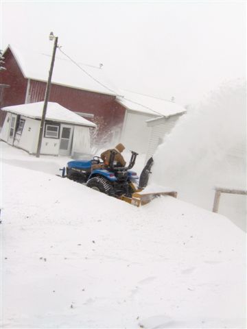

   / Turf or Industrial tires #29
There are things to look at that clear a lot of the questions up. Normally snow removal equipment means the tractor is not on deep snow which is where farmers use chains. The turf tire gives you the maximum amount of rubber to the surface so they will under most conditions give you the most traction. To have a paved driveway turfs will far exceed any other type tires traction. With other types at best we recommend a road type chain to keep the rubber on the surface. Don't worry about a little wheel spin! Enjoy!
^^^agree...turfs in action: snowblower1.jpg
