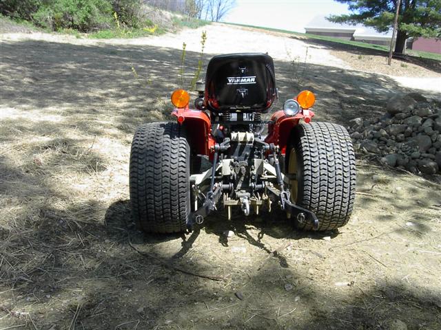

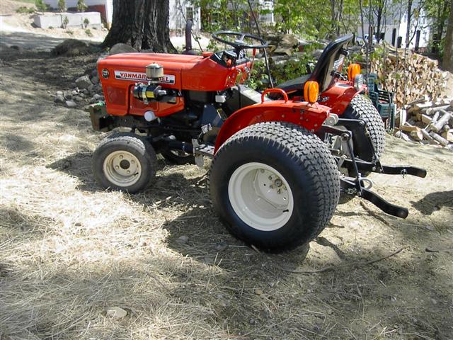

Well, it finally dried up enough to take the tractor out last weekend. I tried driving with the front axle engaged over soft dirt, and the front tires left tracks... indicating to me that the overall gearing with my front turfs is off a bit. It did go into, and out of four wheel drive without any problems though. I suspect i will have to come up with a front tire that is a bit taller.

I must add how much more stable it feels with the wider footprint. Its nearly 60 inches wide in the rear now! Its taking a little getting used to..... having to pay a bit more attention when driving around obstacles. I need to get my belly mower cleaned up now that i can drive on the lawn without digging it up.
Chris.... thanks for the 186D tire info. I assumed wrong. The 186 and 187 must not have shared the same gear ratio ! Whoda thought ??!!
