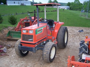

In your picture it looks like the rear tires are pretty close in diameter to the ag tires that were on it. You front wheels look way too small. What I did on mine was rather than look for a set of tires for a particular tractor, I measured the diameter of the ag tires and got turfs the same diameter.
