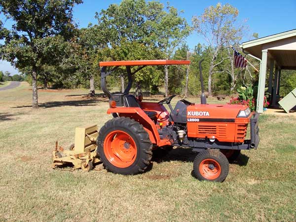

I DO I DO!!!
Only a 2wd though. the fronts will still leave something if you are moving fast, but I don't know how they compare to the 4 rib ags, these are all I have. Only about 10 minutes to change the rears with an inpact.
If they are a different size you will do zero damage if you keep it in 2wd. In 2wd the shafts freewheel. In 4wd you may have a problem.
