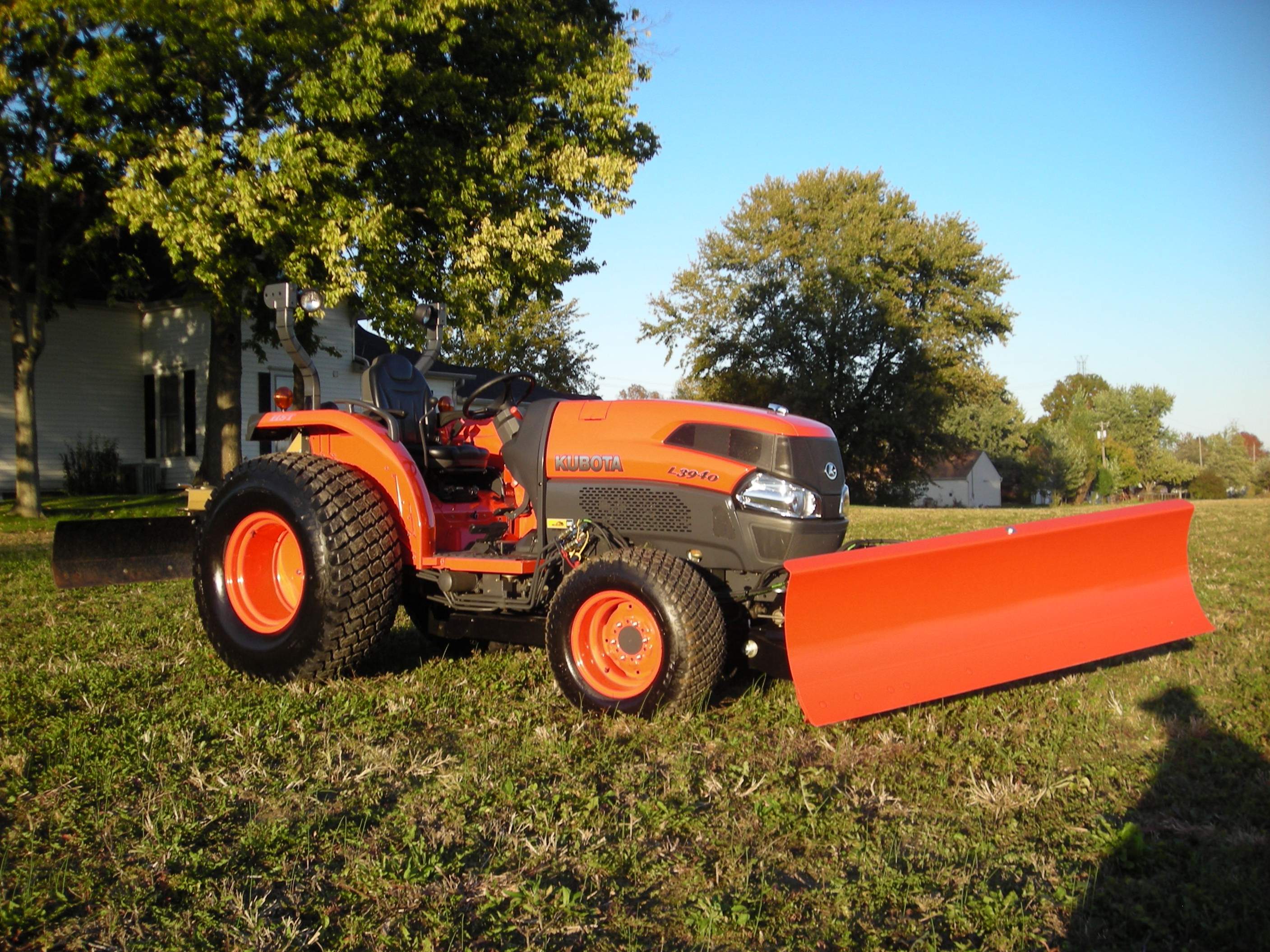

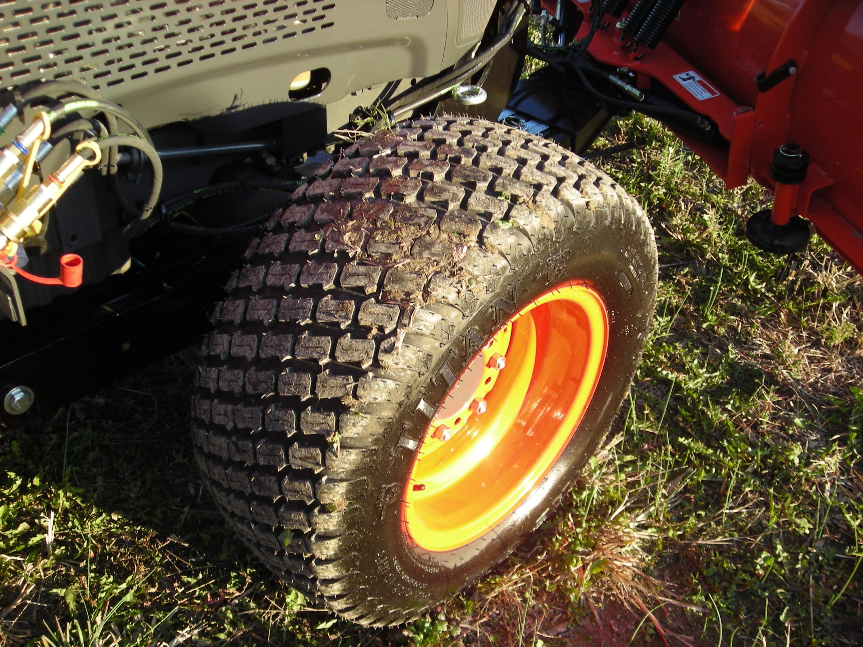

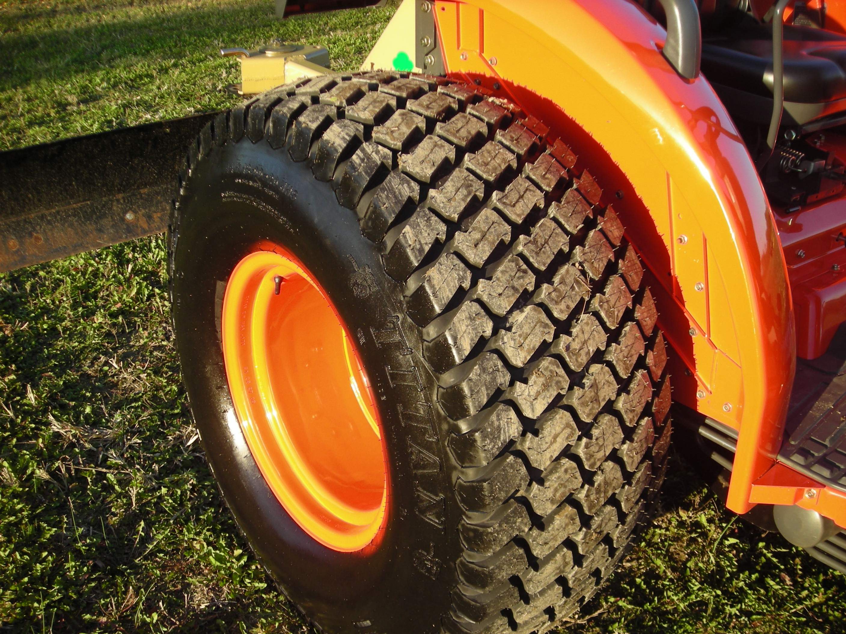

Here is pic of tractor with both blades and tires I was speaking of. Philip.

   / Turf tires - traction? #22
Your rear tires look to be the same as mine. Same tread pattern as the turfs on the B7610 that I had before but the lugs are about twice as deep. They hook up pretty well in most conditions.
I have seen photos of the galaxy turfs, looks like you could float across most anything with those but better not try pulling too much.

I agree completely with my L3940 and turfs. I push snow on blacktop, and the smallest amount of ice causes problems. May not be apples to apples, but I used to move snow with Ford 8N and R1 tires, this set up was not good on black top. I added chains to the R1's and it was unstoppable, but it scrapped the heck out of the blacktop. With the L3940, I only had to put it in 4WD a few times. Philip.
