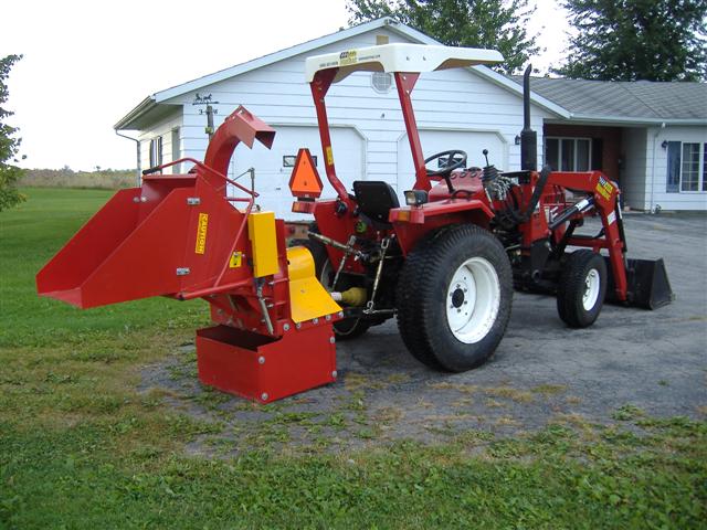

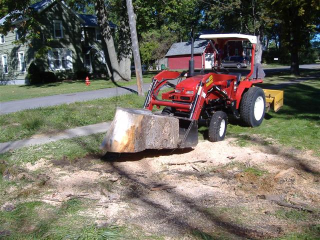

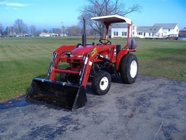

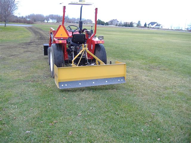

I have the R1 tires that my NorTrac 254 came with. I bought the Turf Tire set for it, at the same time. I can change them out in 30 minutes. Not a big issue. I find that the Turf Tires do a better all around job than the R1. I use my tractor to Mow the front 4 acres,plow the driveways, built a driveway, and logging firewood. Tilling the garden works better with the R1 than the Turfs. Open ground, R1 win hands down. I love the fact I got both sets. The only thing I can't coment on are R4tires. I've only used them on Skid Steers. That's a whole nother animal.
