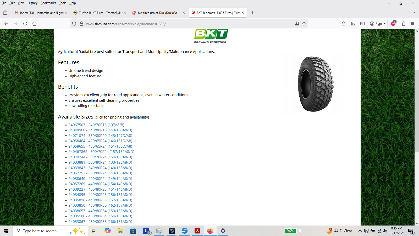

Most of my life all I ever used were R1's, we tried R4's a couple of times as far as we were concerned R4's are just an accident waiting to happen on fields and woods.
My little Kioti has R14's on it and I have been impressed with there performance.
Last year I went with completely different tire on one tractor, I have been amazed at these tires capabilities. They are BKT Ridemax. For some reason the BKT website is acting up for me tonight.
BKT Ridemax IT 696 Tires | TiresUSA.com | Glendale, Arizona

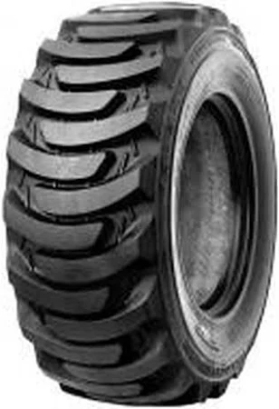

A quick look at R4s brought up these
A bit different than most.

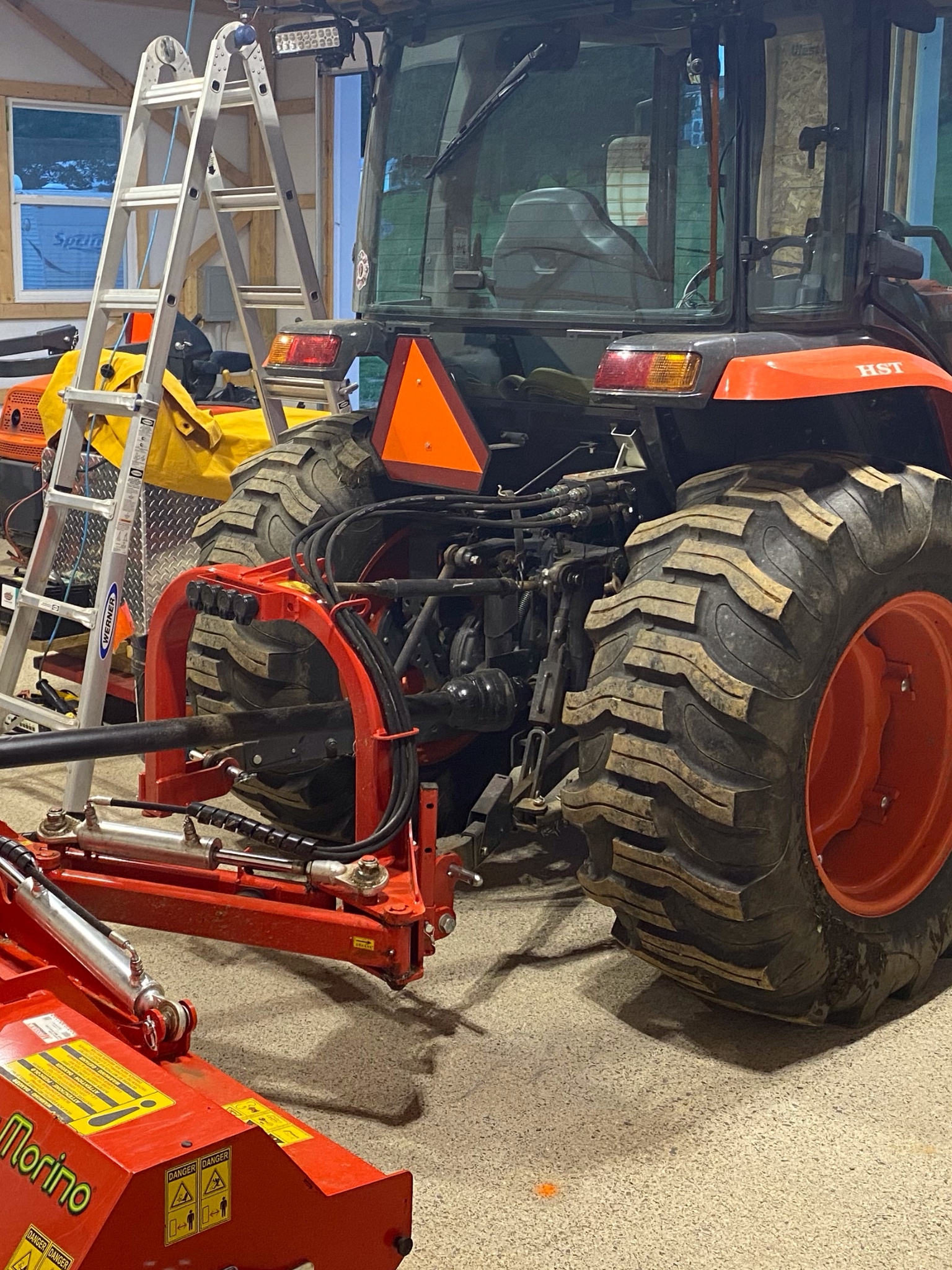

How wide is your flail?

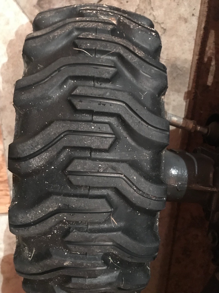

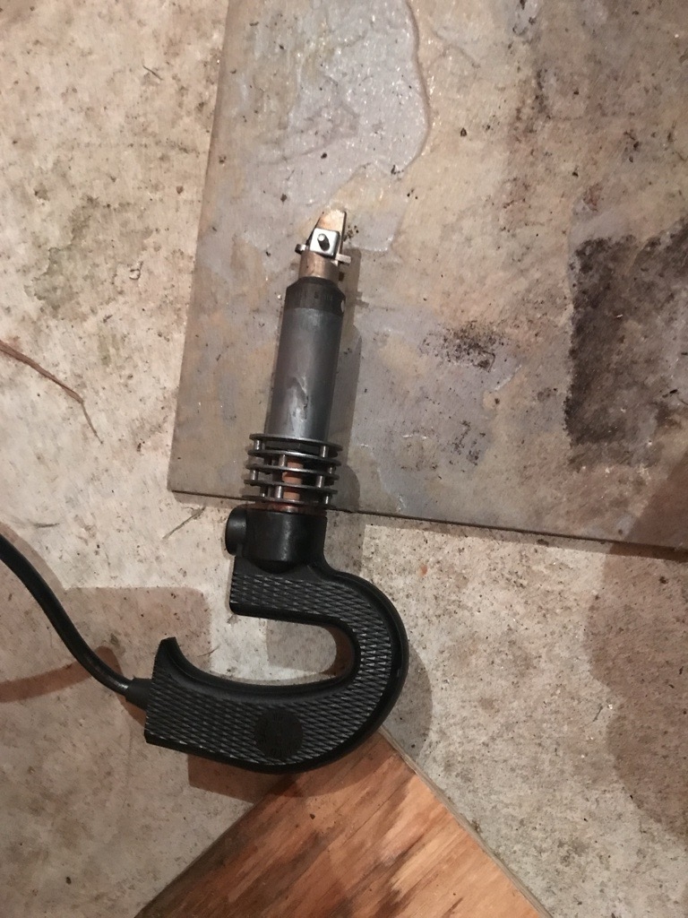

I will say, without chains, R4's are absolutely appalling in snow. T
I can't confirm or deny.

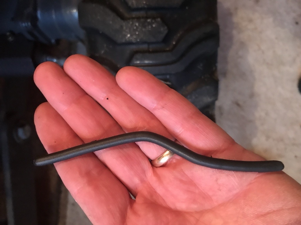

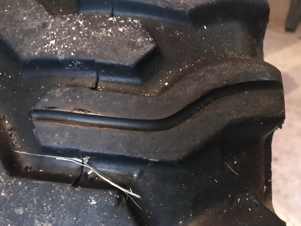

My tractor came with R4s, and before the first winter, based on threads here, I grooved them front and rear.
I had bought Euro-style chains, and bought/installed 2" spacers to provide clearance, but never put the chains on. I have a paved driveway that has some very steep sections and had no trouble whatsoever (in 4WD). Granted, there have been times when I would have to make a second run, but it never felt like I was in danger of getting stuck.
That was 8 years ago. Since then, I have put the chains on 2 different years. They allow me to use only 2WD most of the time, but still need 4WD depending on conditions. I do keep the driveway bare, by using salt, so I never have a buildup of ice or packed snow underneath.
Bottom line, I have not used stock R4s, but with the grooves I have been extremely happy with them.
Additionally, I have in the past loaned out the groover to users here on TBN, and am happy to continue doing so. I only ask for the cost of shipping and that it be returned within a month.

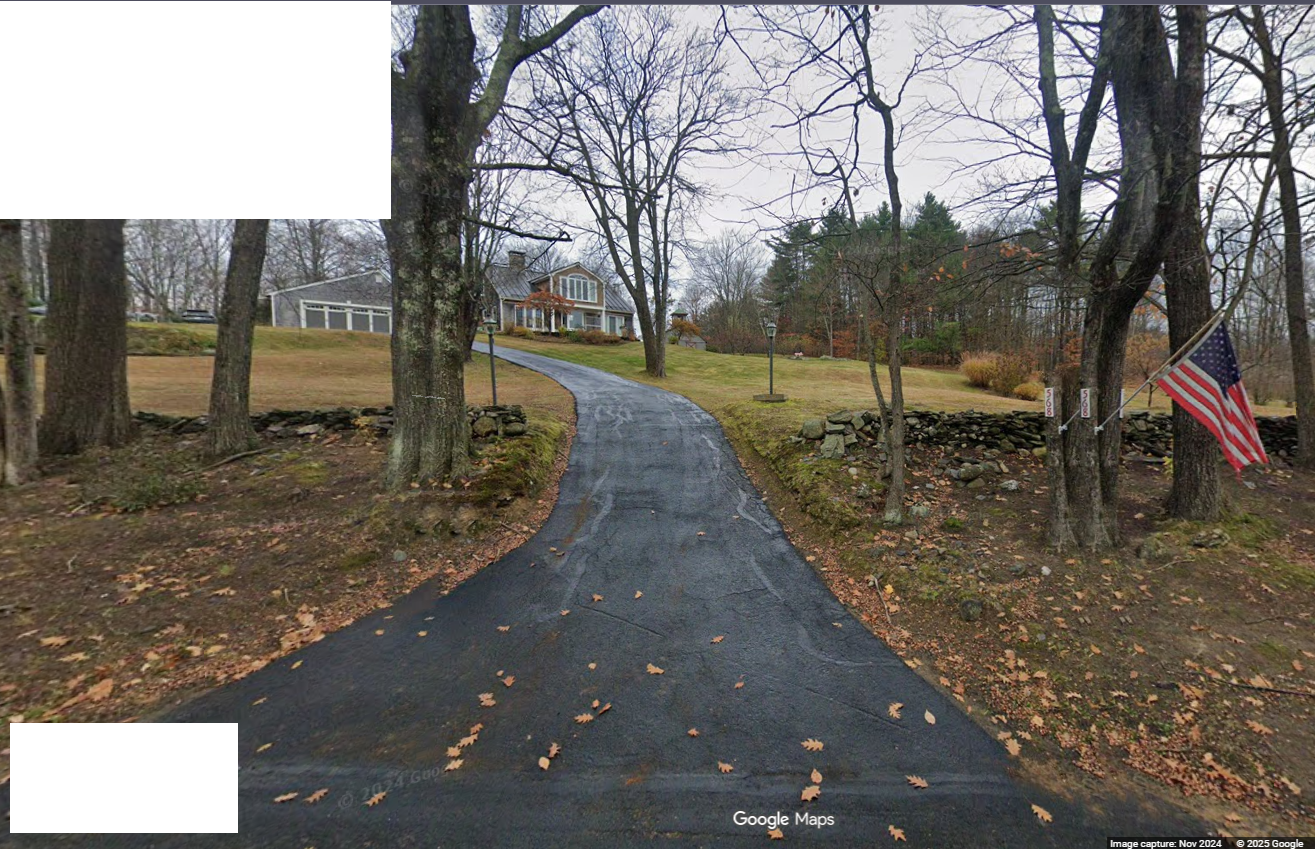

   / Turf to R14T Tires #19
My driveway. Steep enough that I can't pull our Aistream up because it bottoms out at the back.
