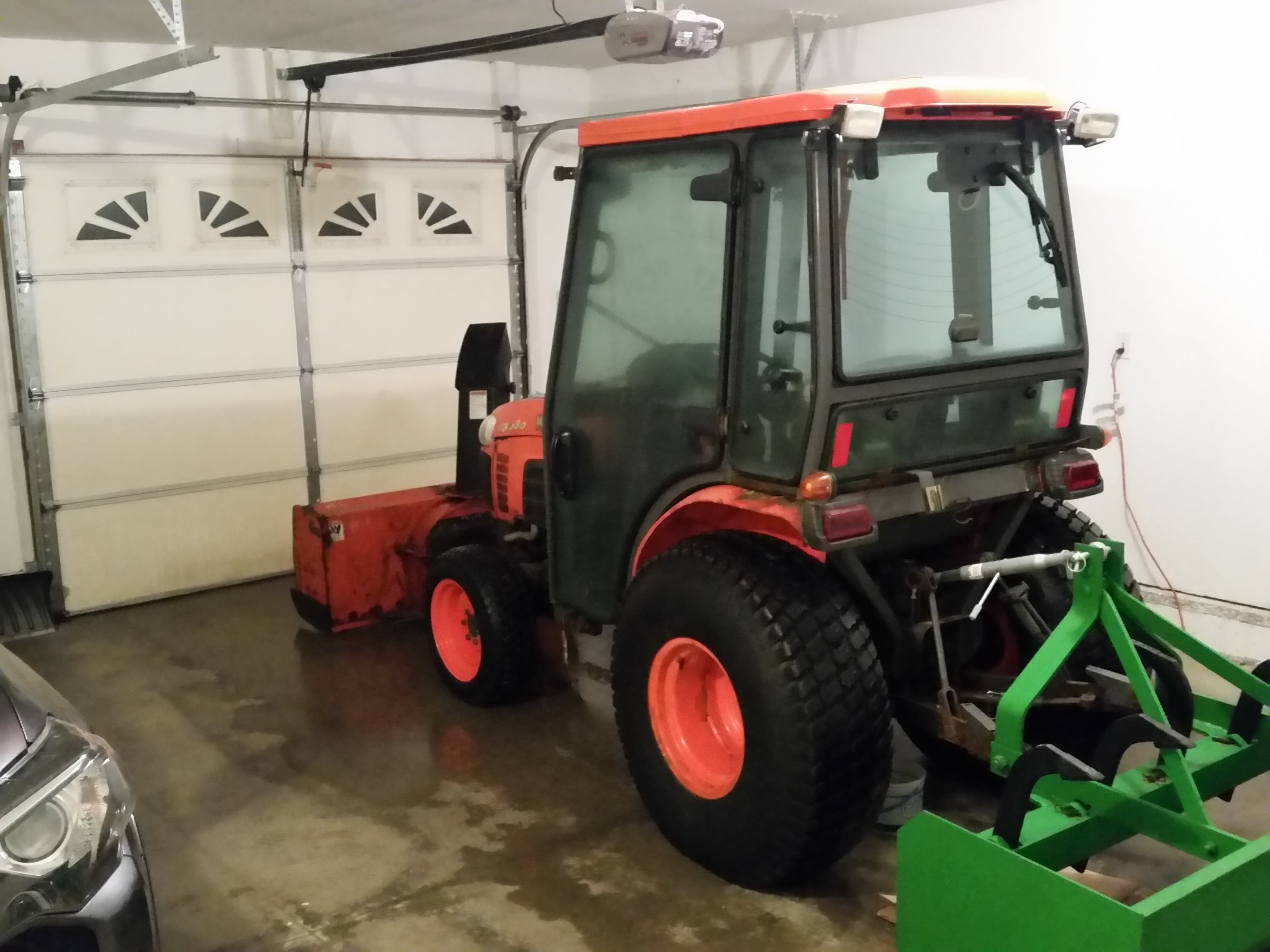

Another turf tire user in winter. As already mentioned, the turf tires of today are not the diamond tread of years ago. The turf tires on my Kubota are a deep "S" shaped tread pattern that work very well in snow. They also work very well on the hard packed snow after I snowblow. The rear tires are loaded with Rimgard beet juice which helps. 20180413_220705.jpg
