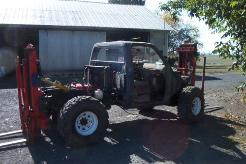

I say why not, if you can make use of it give it a try. I think I will end up using an old 3/4 or 1 ton 4/4 for some kind of utility vehicle . Here is a pic of one I like that I found on Machine Builders Network Lot of good info on building things from scratch like backhoes and modifying things.

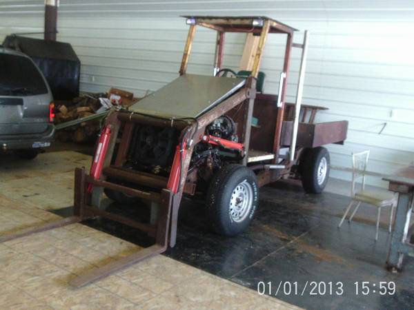

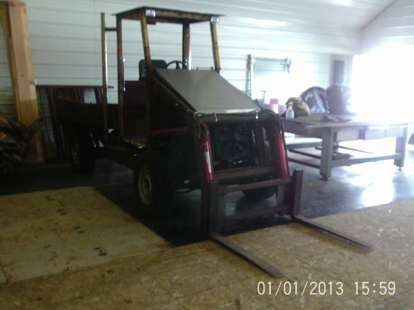

This is on Craigslist right now:
Blazer loader
