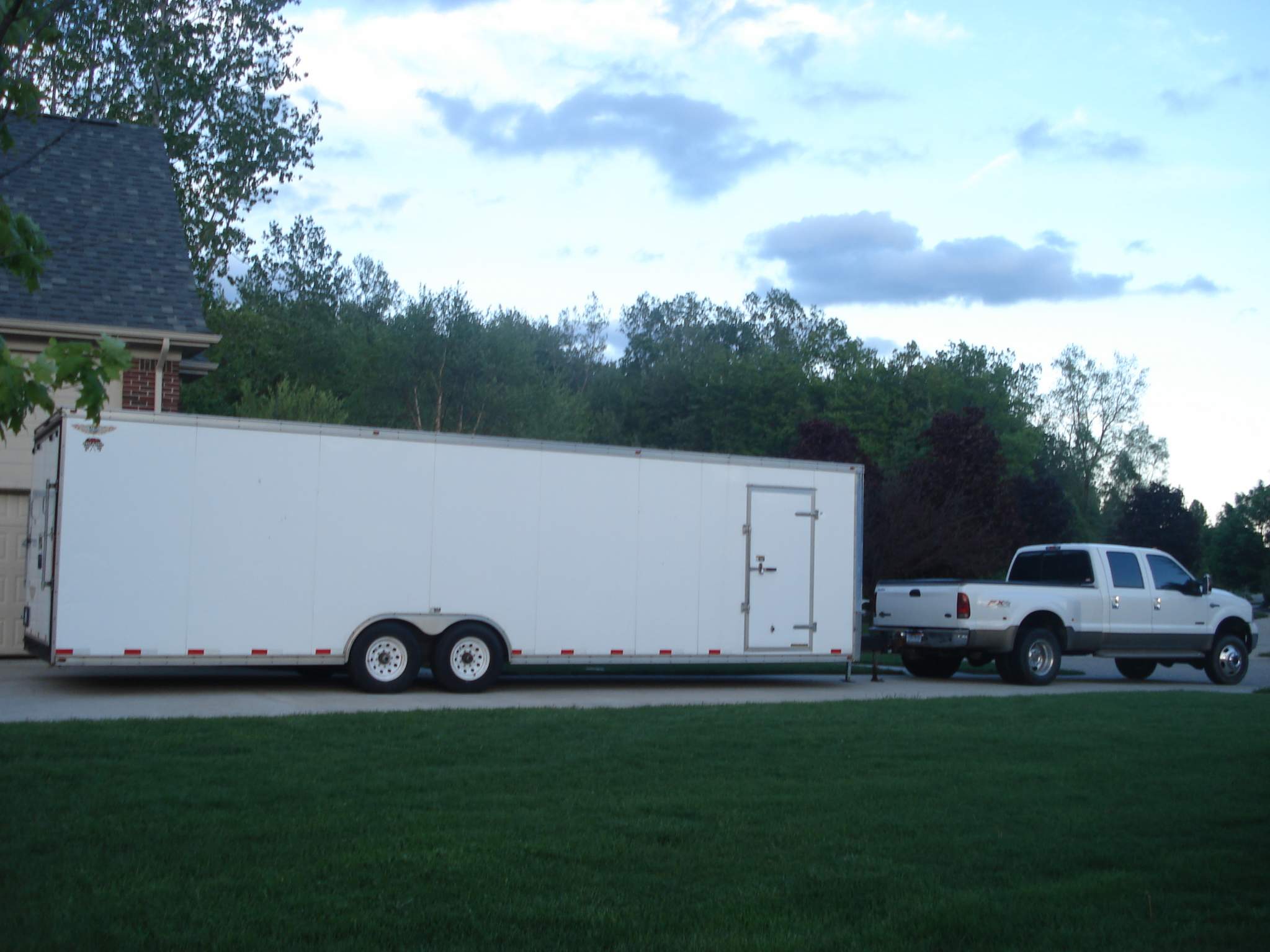

35 feet is a lotta trailer!
I have a CC dually 8' bed and a 30' enclosed trailer. Not sure about turning radius, but I will tell you it's better on secondary roads than with my 30' gooseneck trailer. The gooseneck turns inside the truck line, the first time I realized that I had rubbed up against a concrete post and put a nice "wave" in my hook rail on the trailer.....the day after I bought the trailer. :mad:
The 30' enclosed basically turns in the tracks of the truck, and I did my move from MI to Ohio last year with it, I think 5 or 6 trips.....mostly interstate, but secondary roads mostly in Ohio. Never had a problem.
But.....35'......wow! Can you give it a "trial run"?
pic for reference.
