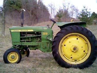

2010R.....this?
   / turnoffs and downsides to old iron-survey #35
Nice 2010. Is it an R? I always thot the R meant row crop - - a three wheeler. Mine has 2 front wheels very closely set. Are those 36" rears?
Larry
   / turnoffs and downsides to old iron-survey #36
Larry
"Row crop" doesn't have to be narrow front. All that really means is they have adjustable axles front and rear, and generally, a row crop tractor will have taller tires/wheels than a standard or utility. (USUALLY 38" rears)
