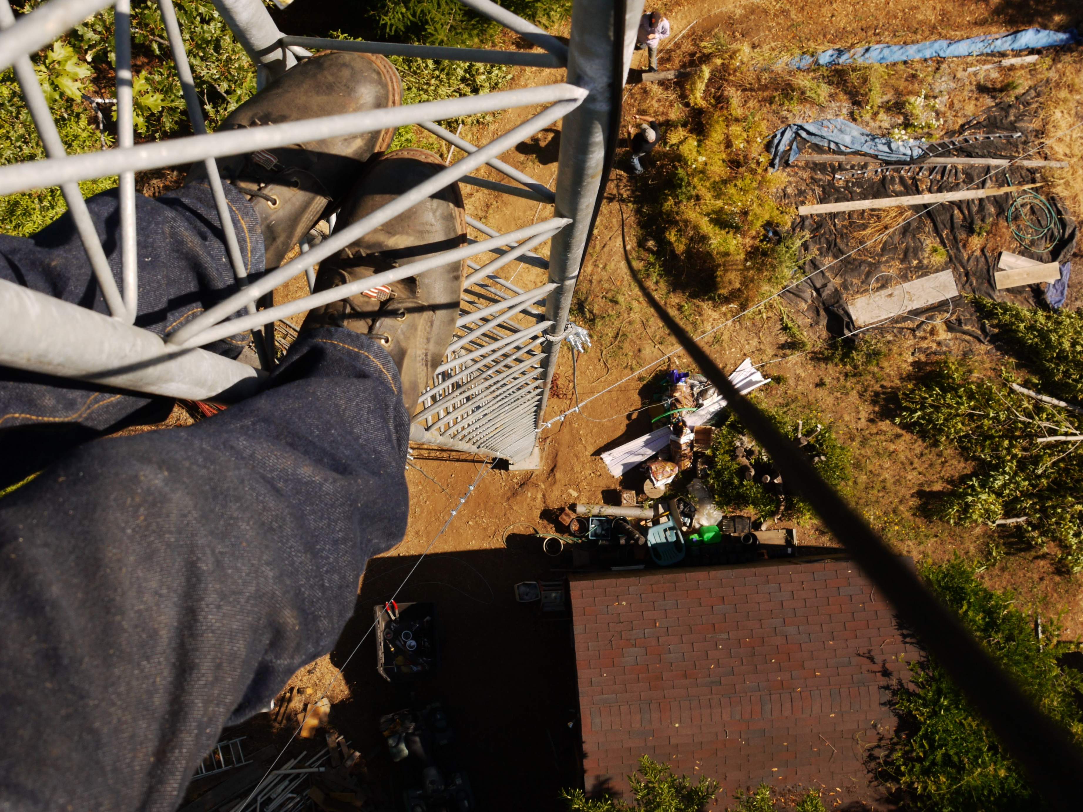

OK, thanks for posting this picture, now I've got the hee beee geee beees.
I don't know how you guys do heights like that, I just lock up.
I watched a video of a guy free climbing on the top of a 1400 foot or something silly like that tower, was worse than seeing poltergeist as a little kid, I'm still not over either event.
Joel
Joel
:laughing: I was thinking of posting that video here...

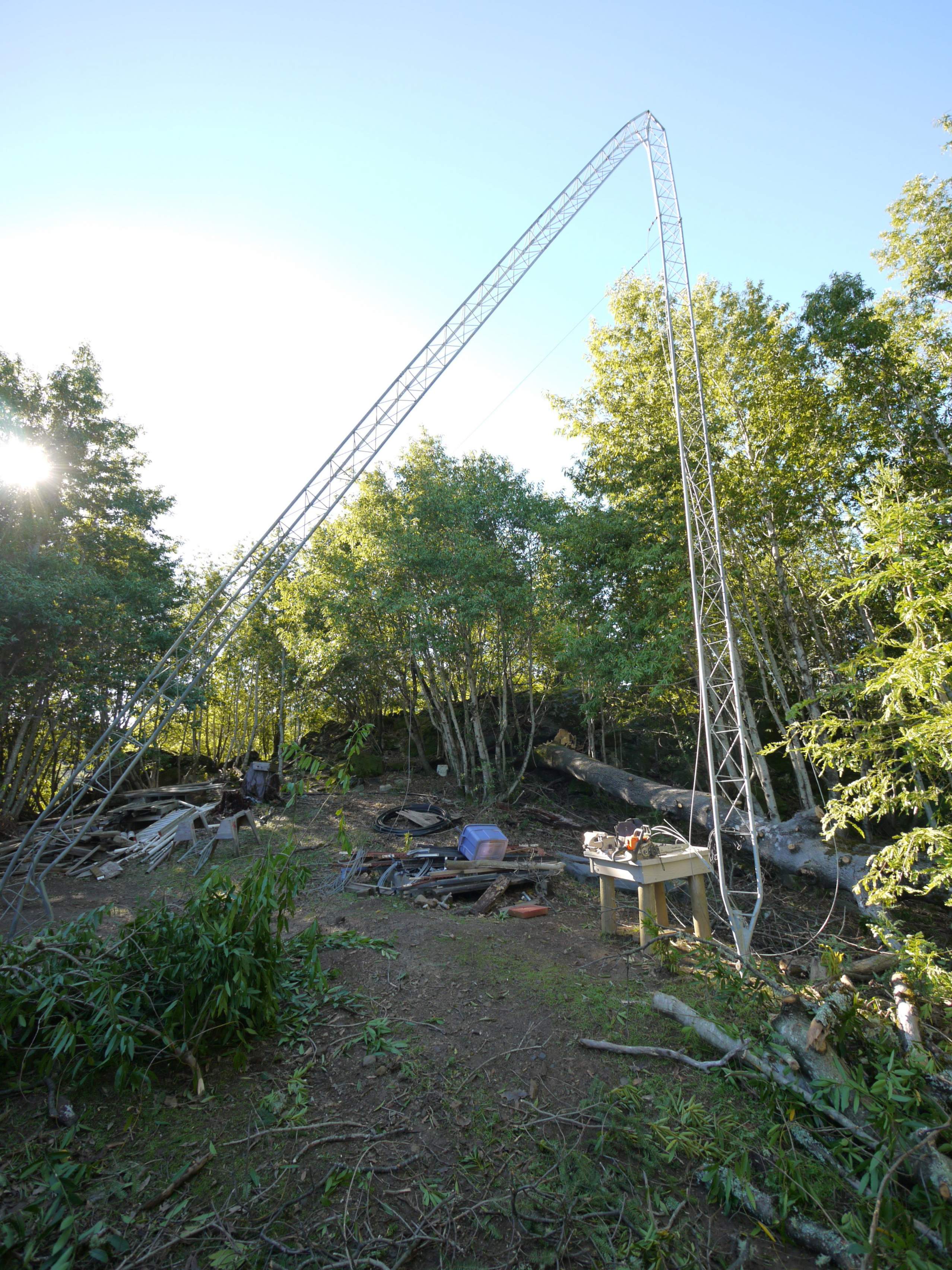

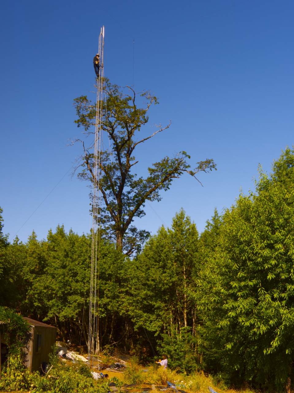

OK, I did gloss over the part where you said you want to take it down to re-set it someplace new for your own use. Thus, you will need a gin pole, and take it down one section at a time. Re-assembly also should be one section at a time. I have done it, and will soon do it again. I have 2 Rohn 25 towers, one is 60', and the other was 80'. It came down on Monday due to an adjacent 75' Oak tree which fell and hit one of the guy wires. I think I only lost two 10' sections, and I will be able to re-use the rest. It will go back up soon!
