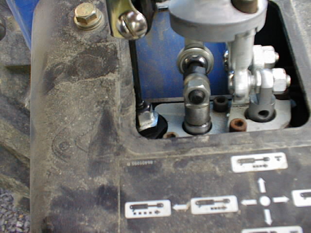

MikeBurr, my TC30 has the control valve in a different location than yours. I would bet it does not use the same valve either. For mine, I removed the control cover and found a jam nut and a small set screw that I turned with an allen wrench. I loosened the nut and turned the screw further in.

Could you post a picture of the screw for us other guys that have the 7308?? I am not sure I want to do it on my TC29D? I can lift my wheels up with not much trouble on mine. If not I put it in gear and move forward some as I push th loader control. Works everytime.

I adjusted my 7308 on a TC33D last night using the method first posted here. It took a little less than a half a turn inward to be able to lift the front without using the curl. Your tractor may vary.
I took a couple pictures while do it. Took about 5 minutes total.
Wrench is 1/2". Allen is just one that fit on one of those multi-size folding sets. When I loosened the jam nut the black seal paint came off, showing it had never been adjusted either.
