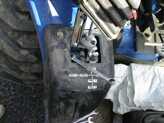

   / Tweaked FEL Output #21
Second Picture.

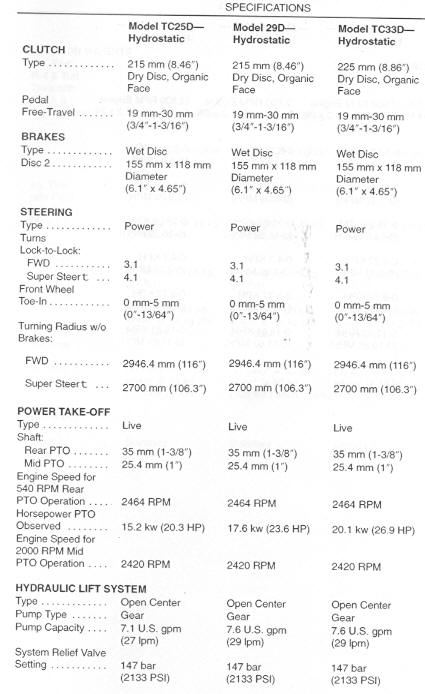

</font><font color="blue" class="small">( This was a low-tech method to adjust my pressure relief at the valve but, as the system main relief is supposed to be set at 2150 psi, I think it is safe from a hydraulic system stand point. The only question that remains is will the mechanical systems survive the additional abuse. )</font>
Mrwurm, I have attached a scan of a page out of my TC33D owners manual. It shows the 'hydraulic lift system' setting to be 2133 PSI. I believe this may be referring to the 3-point lift system and not the loader. I will attach a scan from my loader manual next.

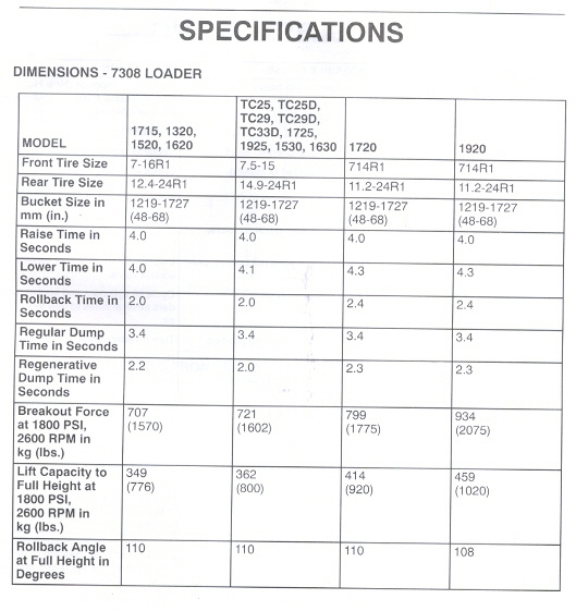

   / Tweaked FEL Output #26
Here is a scan of my 7308 owners manual specifications page. It is referring to 1800 PSI as the pressure that the FEL is rated at while at 2600 RPM's.

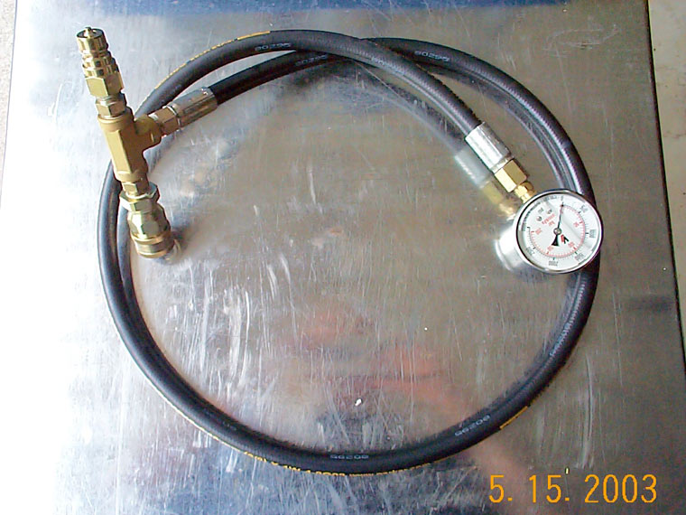

   / Tweaked FEL Output #27
I went out to my friendly neighborhood hydraulic store and got some parts today (see attachment).

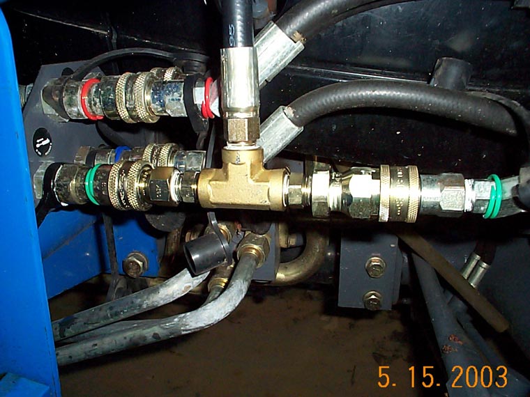

   / Tweaked FEL Output #28
Here is the gauge inline in my FEL lift circuit.

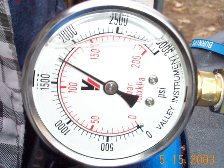

   / Tweaked FEL Output #29
Here is a picture of the gauge reading 1775 PSI at 2700 RPM (I forgot that the rated RPM was 2600 when I did this test). This is the way my system was set from the factory, I had not made any adjustments yet.
