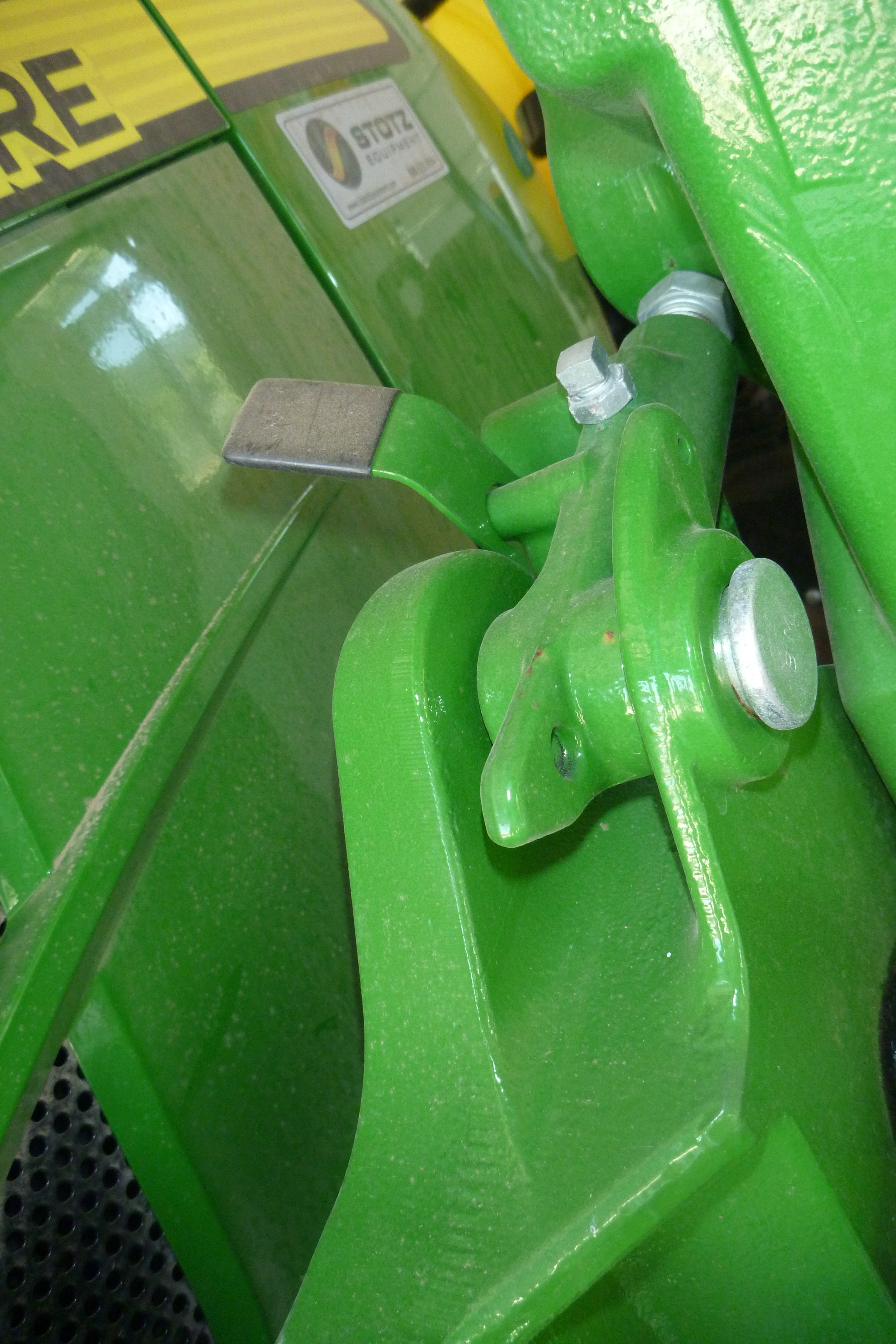

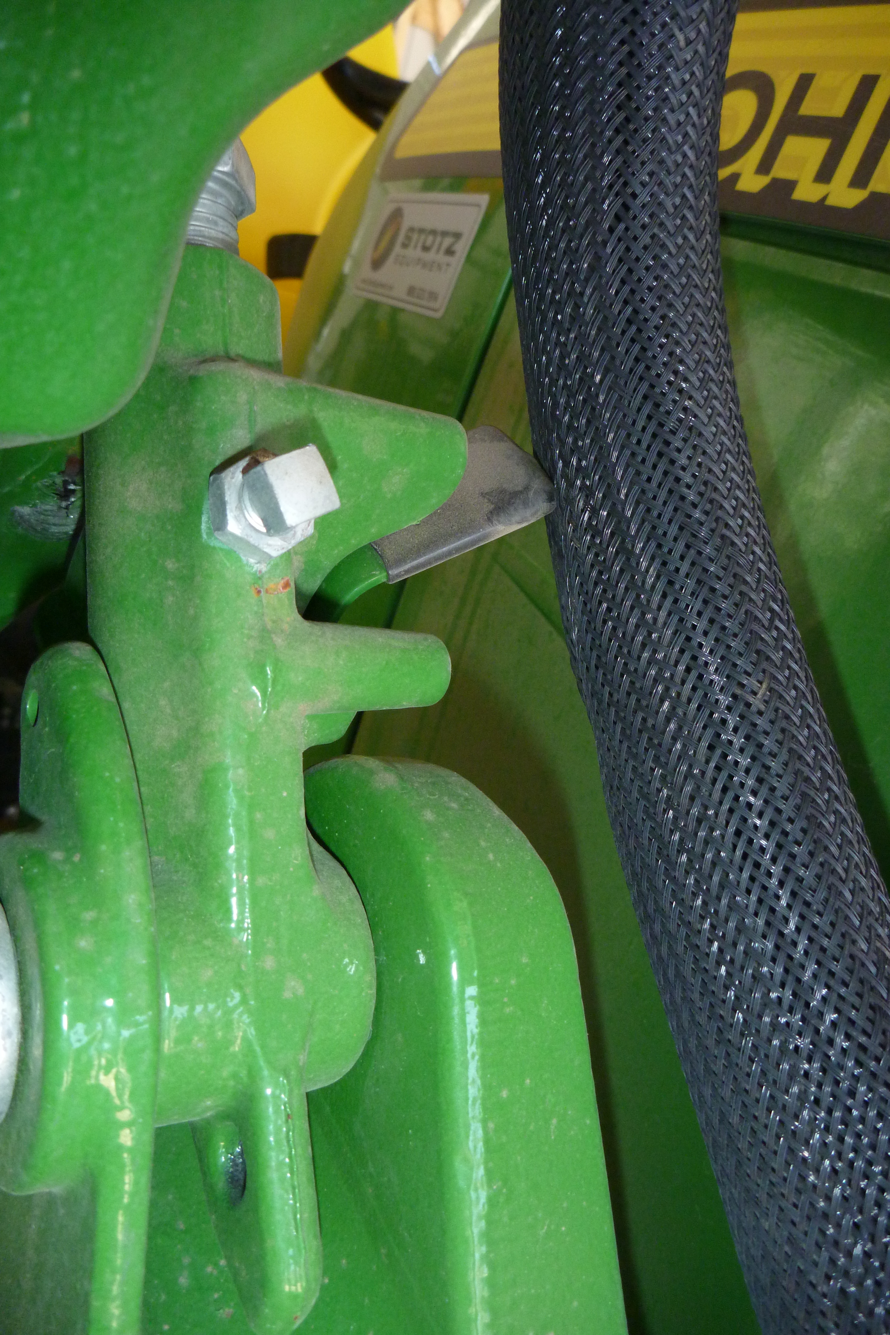

Here are pics of the disengaged right side and the normal left side. I would never think to take pics of something for future use like this; I have pics, but not close-up details. It's going to the dealer tomorrow.View attachment 562810View attachment 562811I guess I shouldn't have touched the lever as it removed the dust.
Sadly, it's obvious by the last two pics that the lock was engaged at one time. You can clearly see the skinned paint.
Why it unlocked is going to be the issue to be resolved. The dealer is going to have to be very creative with JD to get this covered under warranty. If he pulls it off I would be a faithful customer from this time forward. Including all fluids and filters.
If a JD warranty rep gets called in this isn't going to end well.
Side note and my opinion only. That lock system sucks!!! An "over center" latching device should never be used here. I'd have zero faith in it from now on...... :(

Looking closely at the OP's pic you can see how the latch moved up slightly which took away the "over center" protection. Then it continued to climb upward until it unlatched. Those signs would be my argument with JD. This was not operator failure to relatch. The forces involved unlatched it. That's why I have no faith in it. :(
^ ^ Looks like the through hole on that tab on the lock could be meant for a safety pin? v v

Whether or not you have to lift the front wheels off the ground first or not, those flippy levers look way too easy to get accidentally disengaged. Good design for simplicity, but bad design for what can go wrong and apparently went wrong here. Either that or the dealer never had the right side engaged and it was only on a full load where it became an issue. To the point of paint marks, there is no reason the dealer or factory could not have done that and still delivered the loader with only the left side fully engaged.
And as has been mentioned, maybe the loader is not tweaked or is only slightly tweaked if the loader is half off as shown in the pictures.

Hello, everyone. I took the tractor to the dealer yesterday morning. The service guys looked at it and said, oh, that's an easy fix. It was fixed and I was on my way in ten minutes. Good job Stotz service department in Bluffdale, Utah. The problem, as mentioned by some smart people above, was the quick-attach system on the right side had become loose, and once some weight was put on it, it become completely disengaged. The right side was too loose, the left side was too tight. The guys corrected this, showed me what to do, and how to check it. It's embarrassing, and I realize that tractors are tough and meant to be at least partially fixable by the end user. Thanks again to all who contributed to this thread.
