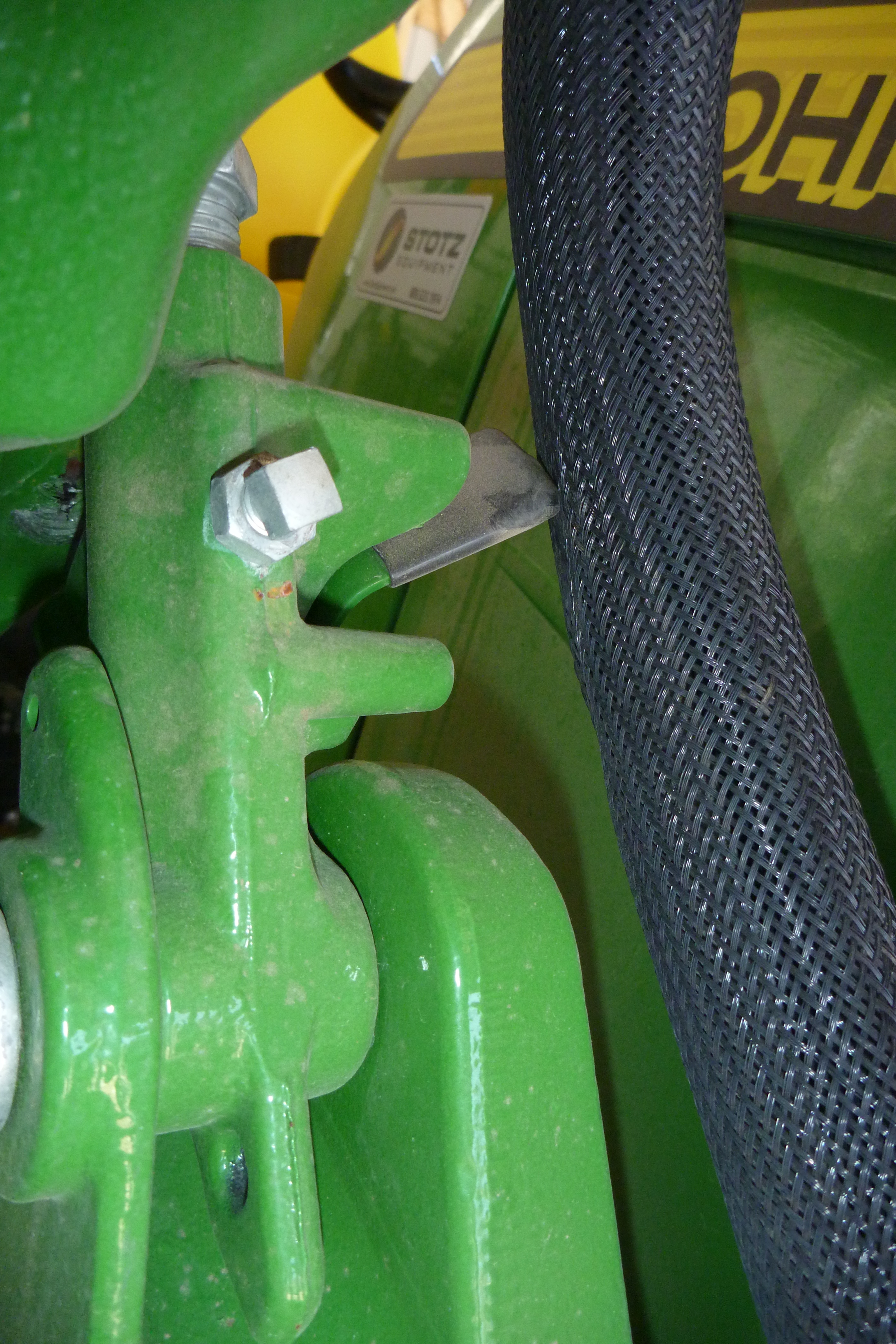

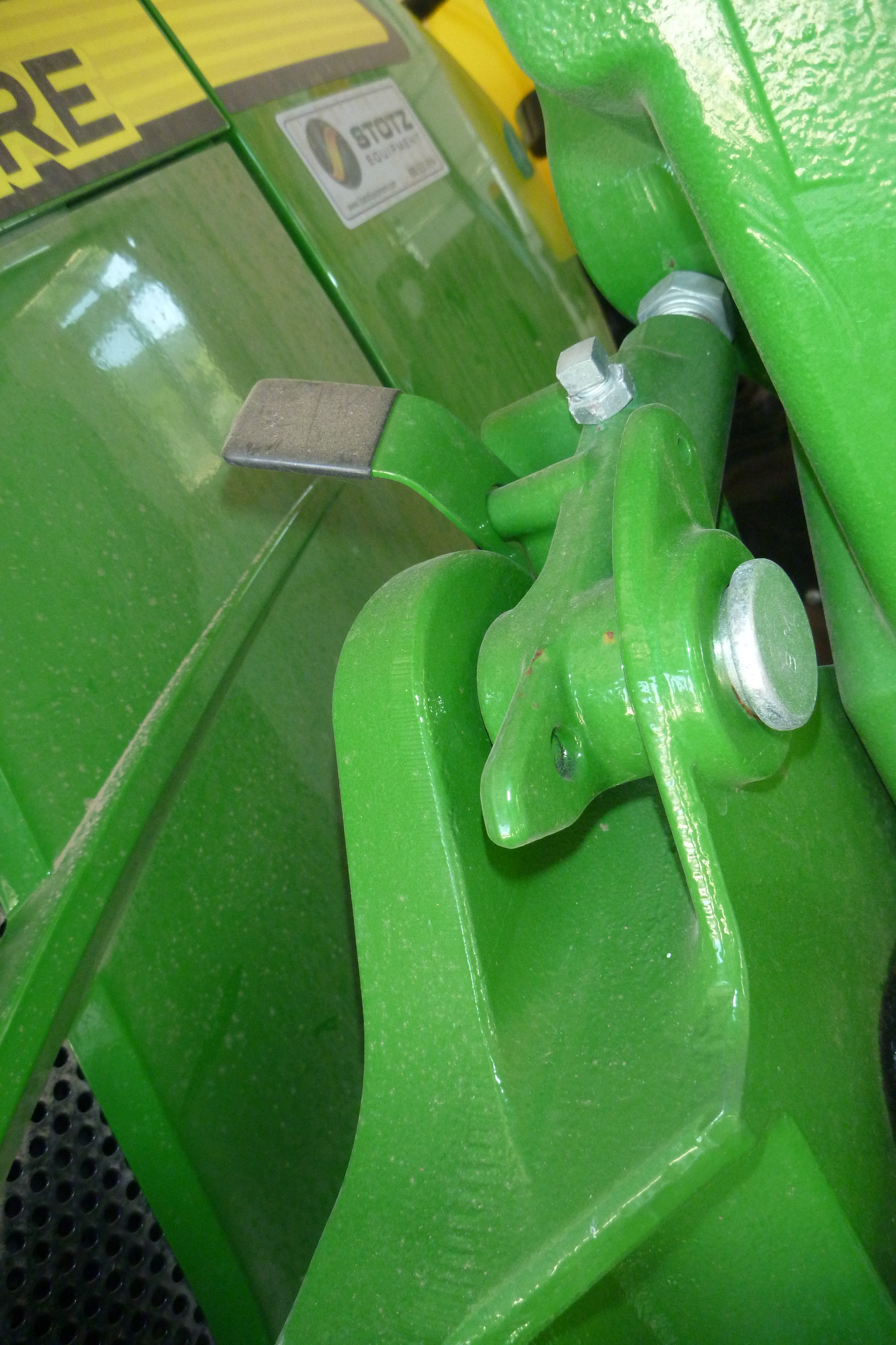

Here are pics of the disengaged right side and the normal left side. I would never think to take pics of something for future use like this; I have pics, but not close-up details. It's going to the dealer tomorrow. P1100218.JPGP1100221.JPGI guess I shouldn't have touched the lever as it removed the dust.

One thing I don't understand, is why so many people keep ignoring the fact that the OP already mentioned and showed pictures of the lock that was not fully seated causing the twisted arms.
If that lock had failed with the loader arms lifted all the way up, it could get seriously dangerous.

Exactly, this damage appears to have been caused by the lock that holds the lift arms to the loader frame becoming unlocked on the right hand side.
No abuse or impact would be needed to cause this, just trying to lift something that is heavier than the side-to-side resistance to torsion of the loader arms itself (which will be much lower than the lifting capacity of the loader).
