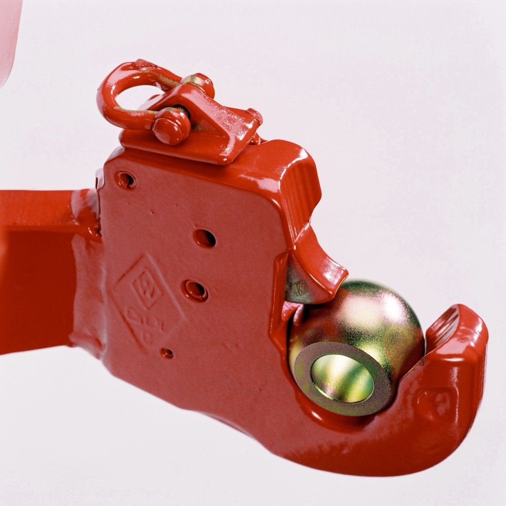

Quick hitches are oversold and overrated for tractors under 75 or so hp. Telescoping draft links and telescoping tubular stabilizers coupled with an operator that understands how to use hydraulics and simple adjustments rather than his (her) back will go a long ways.
For Northern NY a cabbed Kubota MX with the dual category hitch would be well worth a look.
I can certainly agree with that,
I have used quick hitchs and while they do make some parts of the hooking up easier at times, some times they are worse.
And if the implement in question has a PTO to be hooked up I absolutely no use for a quick hitch.
Trying to reach in or around a quick hitch to attach a PTO shaft is an exercise in aggravation,
not enough room for me and PTO with the quick hitch.
I much prefer either the telescoping links or even better the hook style lift arms;
Lift Arms-Quick Coupling
Attaching Implement
1. Adjust the lift arms to the hitching width for the specific implement by means of stabilizers (A).
2. With lift arms lowered, reverse tractor until the lift arm coupler hooks are below the implement hitch points.
3. Slowly raise lift arms until implement hitch points are engaged in coupler hooks and locked into position.

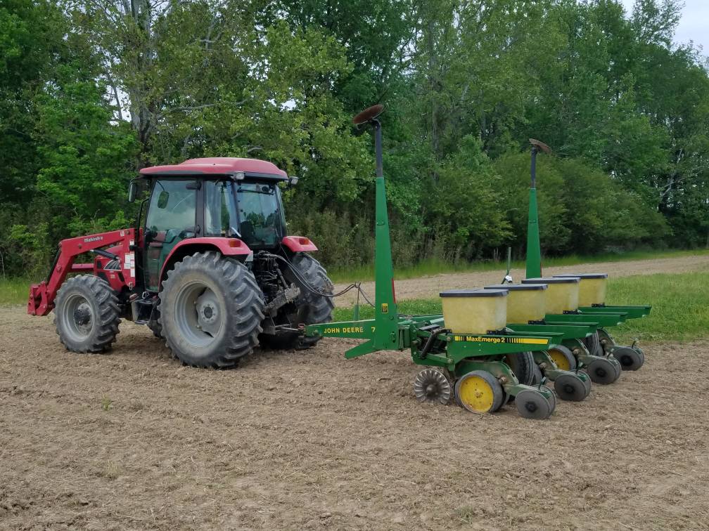

Unless your 2 tractors are similar in HP, each will need equipment sized respectively. Meaning, the big tractor will damage your small disc and the small tractor will not handle the big disc.

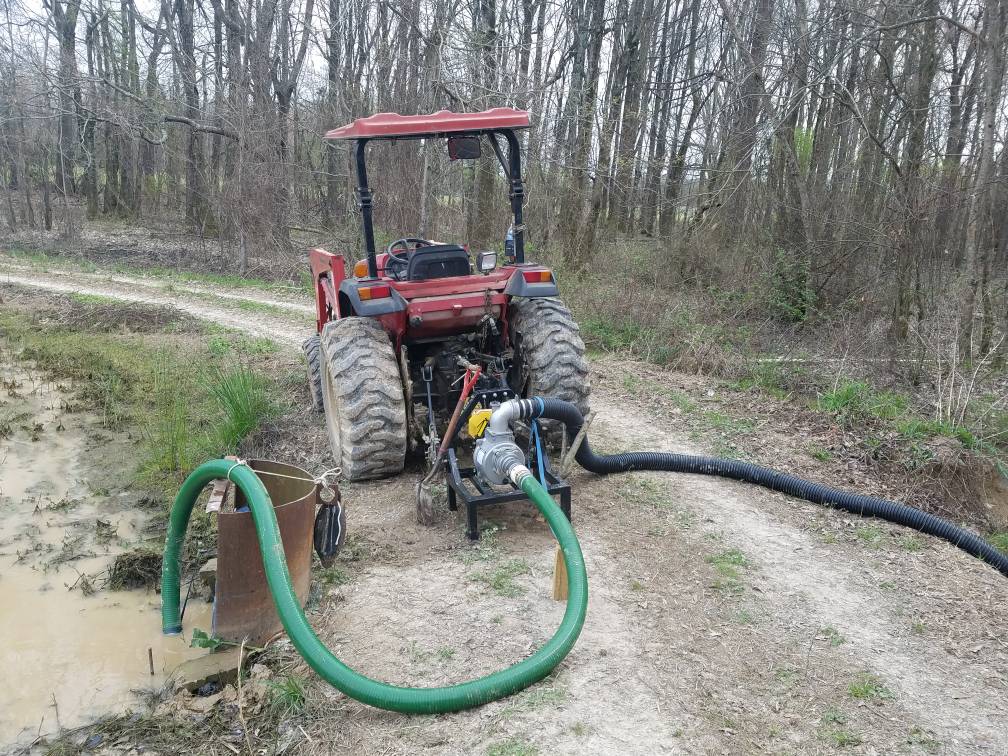

Myself, use a 35 hp with backhoe, 7' mower, boxblade, Taylor Pasture Dream planter and irrigation pump. None of this will transfer to big tractor.

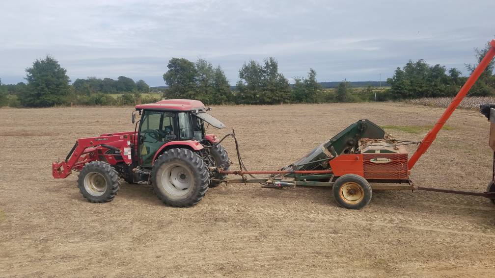

85hp has 10' mower, 8' disc, IH end wheel drill, 7200 drawn 4r planter, New Idea supersheller/gravity wagon and 2yd dirtpan. None of this will work on small tractor.
The only thing that is for both is a set of forks and brush bucket that is too big for small tractor and to light for big tractor.
I keep the yard around cabin mowed with small tractor, grade drive, move implements and mow a narrow levee around a duckhole. The bigger tractor stays in the shed until time to plant and harvest the fields, move dirt to maintain levees or moving big things with forks.
