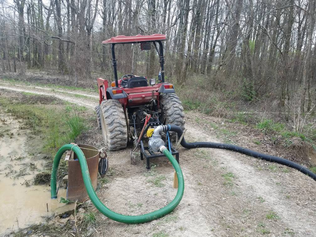

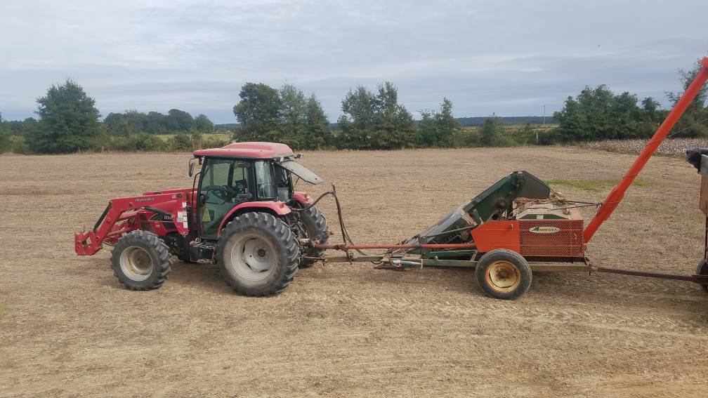

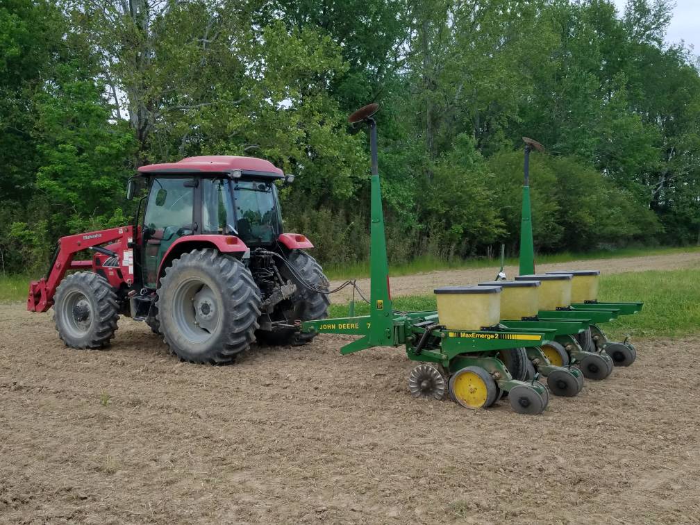

Unless your 2 tractors are similar in HP, each will need equipment sized respectively. Meaning, the big tractor will damage your small disc and the small tractor will not handle the big disc.
Myself, use a 35 hp with backhoe, 7' mower, boxblade, Taylor Pasture Dream planter and irrigation pump. None of this will transfer to big tractor.
85hp has 10' mower, 8' disc, IH end wheel drill, 7200 drawn 4r planter, New Idea supersheller/gravity wagon and 2yd dirtpan. None of this will work on small tractor.
The only thing that is for both is a set of forks and brush bucket that is too big for small tractor and to light for big tractor.
I keep the yard around cabin mowed with small tractor, grade drive, move implements and mow a narrow levee around a duckhole. The bigger tractor stays in the shed until time to plant and harvest the fields, move dirt to maintain levees or moving big things with forks.
