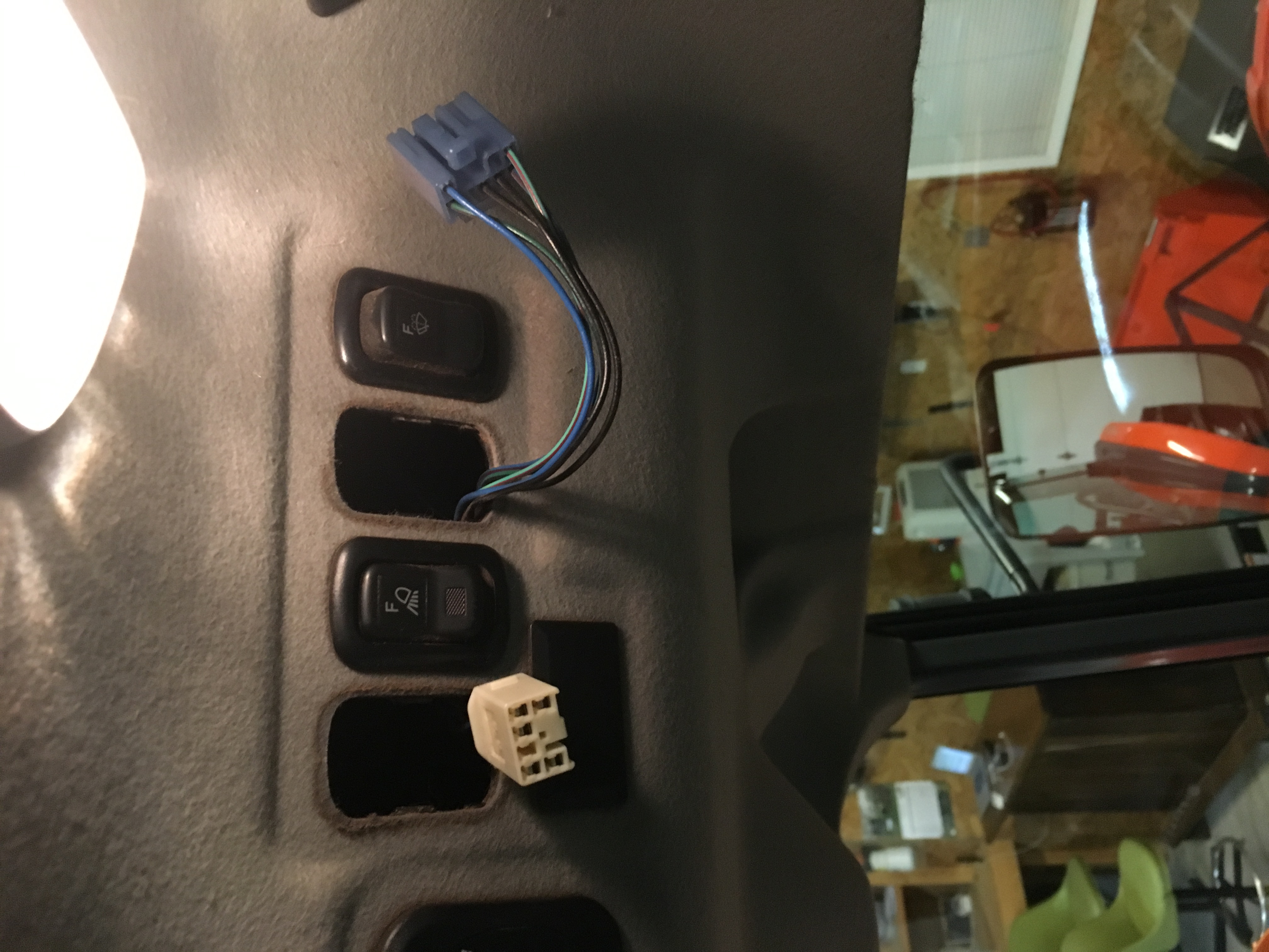

Oh yes....cool....I didn't even notice that they were so easy to remove..Here are the adapters I fished out of there.....I did read a few different manuals today trying to figure some things out to decrease all my newbie questions...But that is handy it is all wired up already. I'll definitely be adding some LEDs when I figure it all out....on my Lil Bx I ran a whole new harness. When sitting in the tractor...over my left shoulder there are two sets of female spade adapters and over my right shoulder there is one set of spade adapters. Both are in the interior of the cab.
Does anyone know what these two connectors go to?
View attachment 541719View attachment 541720
If you pull the roof off accessibility is far better you will see there is a relay missing for that circuit if I remember correctly.

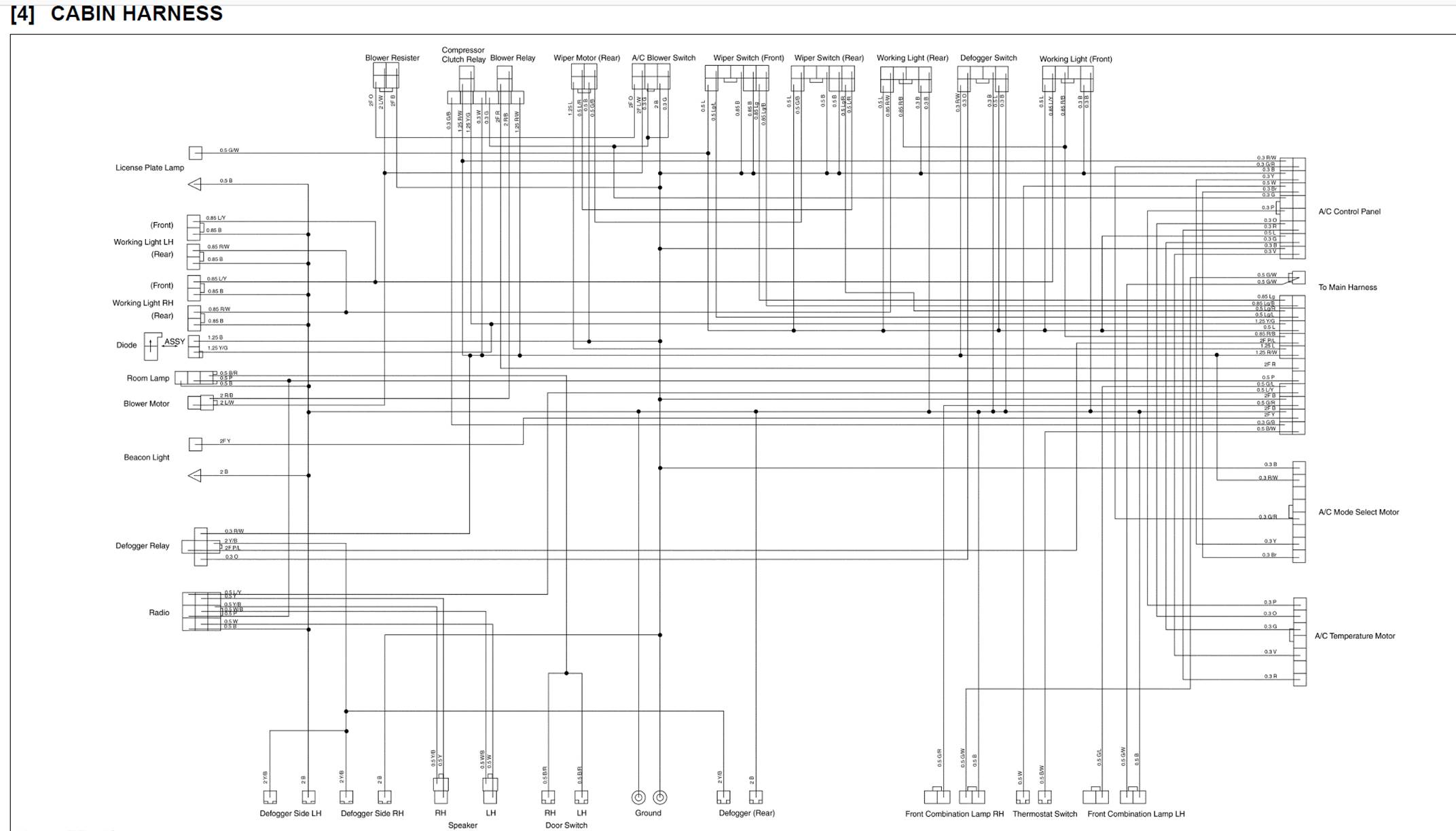

Below is the wiring diagram for a GL40-3 cab tractor. Hopefully this will help the OP and anyone else.
For reference this manual is from Feb 2015.

The other sets of wires.....I have not looked at this diagram yet but I suspect wiper blades and then defrost. I will study the schematic in a bit. I also ordered the dome light with the 48 LEDs on a pad. Lots of good reviews there. I hate not being able to see. I was really pleased with the forward and reverse LEDs I installed on my Bx but it does not appear like they will fit the mount where the factor forward up lights are...I will figure something out up there as there are plenty of threads on that.

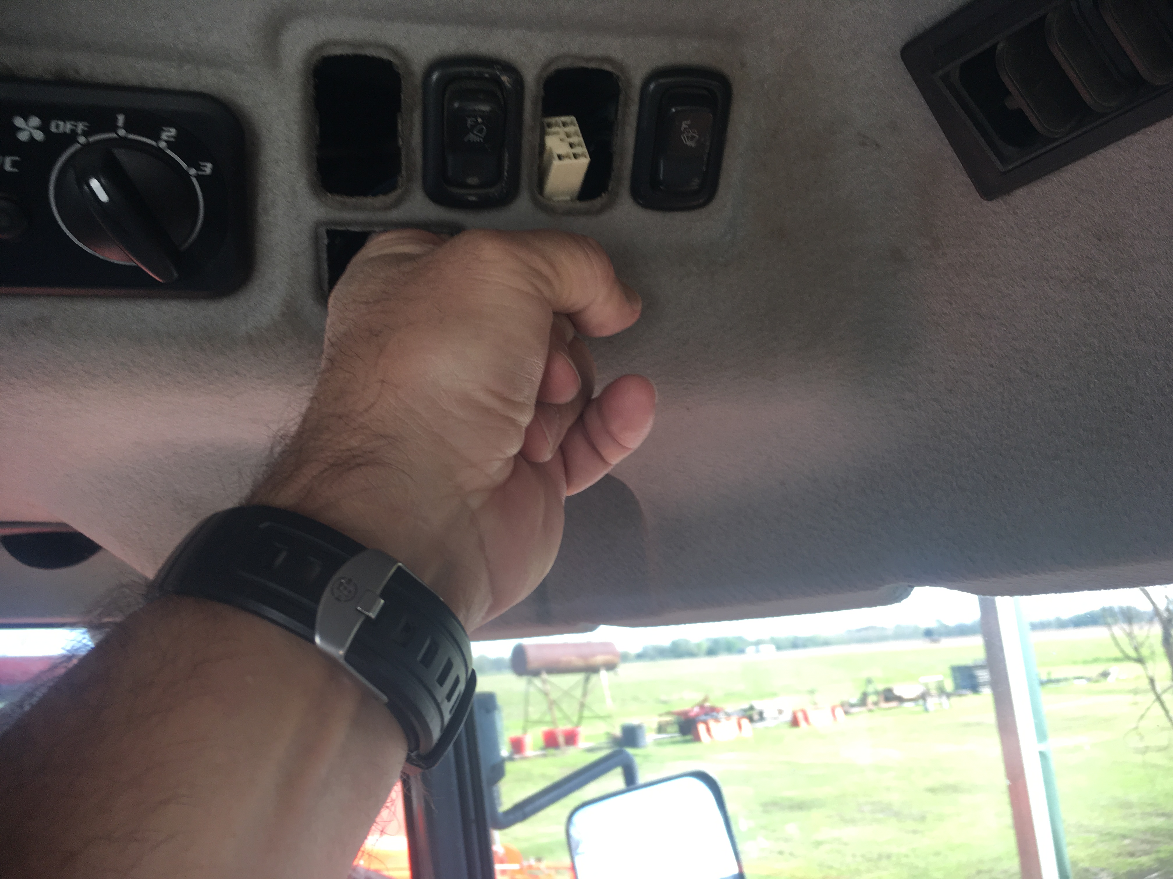

1. I found this connector behind the existing switched in the cab. There may be another, but I didn't see it. Is this the connector for the rear work lights?

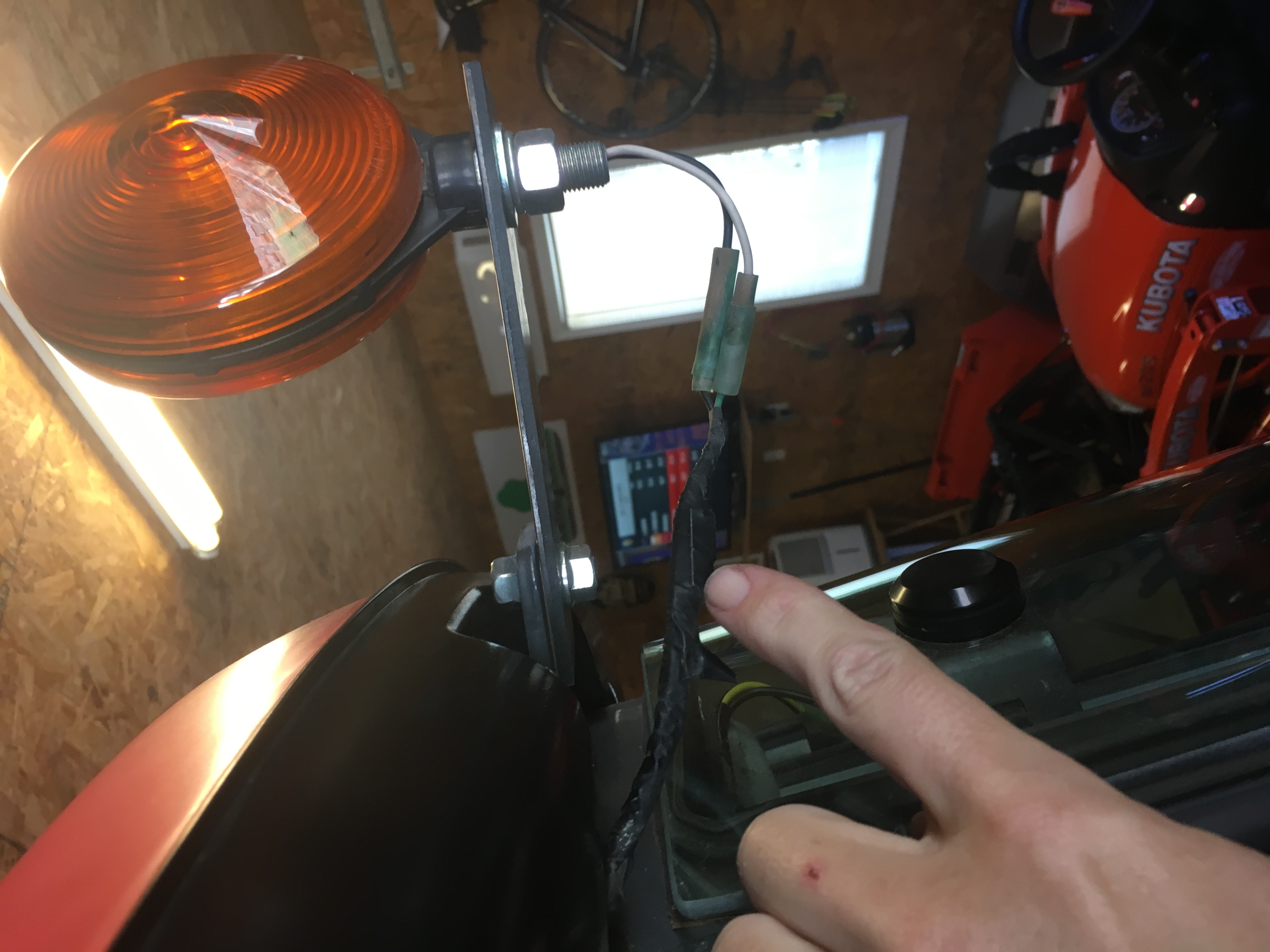

2. The next pic is from inside the cab and shows wires hanging out on the right rear corner of the cab. Are any of these wires for the rear work lights? Old Red said he found his work light wires taped to the flasher light wires. I have not looked there.

On my L4240 HSTC;the very left blank is the rear light connector;the wire for the rear lights connector is out-side taped to the caution light wire.I am guessing the inside connectors are for a rear wiper or window heater.There may be another connector located in the switch panel(not sure).
If you use after market LED's you will have to splice or find the correct connector to the factory harness.I would recommend LED's for sure.Check my link to SuperBrights in this thread.

Just so happens I just worked this project yesterday and this morning a little. My switch came in from Messicks yesterday.
The rear work lights wiring harness that you want to tap into so that you can install your rear lights....it is taped up in black electrical tape along with the rear lollipop flashing lights wire. Cut into that tape where it gets "fat" and that is your connector for your rear work lights. Secondly.....behind the switches you have there.....when you get your light switch from messicks....there is only one adapter inside there that will fit your new switch. There were 3 or 4 total wire plugs in there...You will find the correct one....and it is the only one that will fit your new switch.

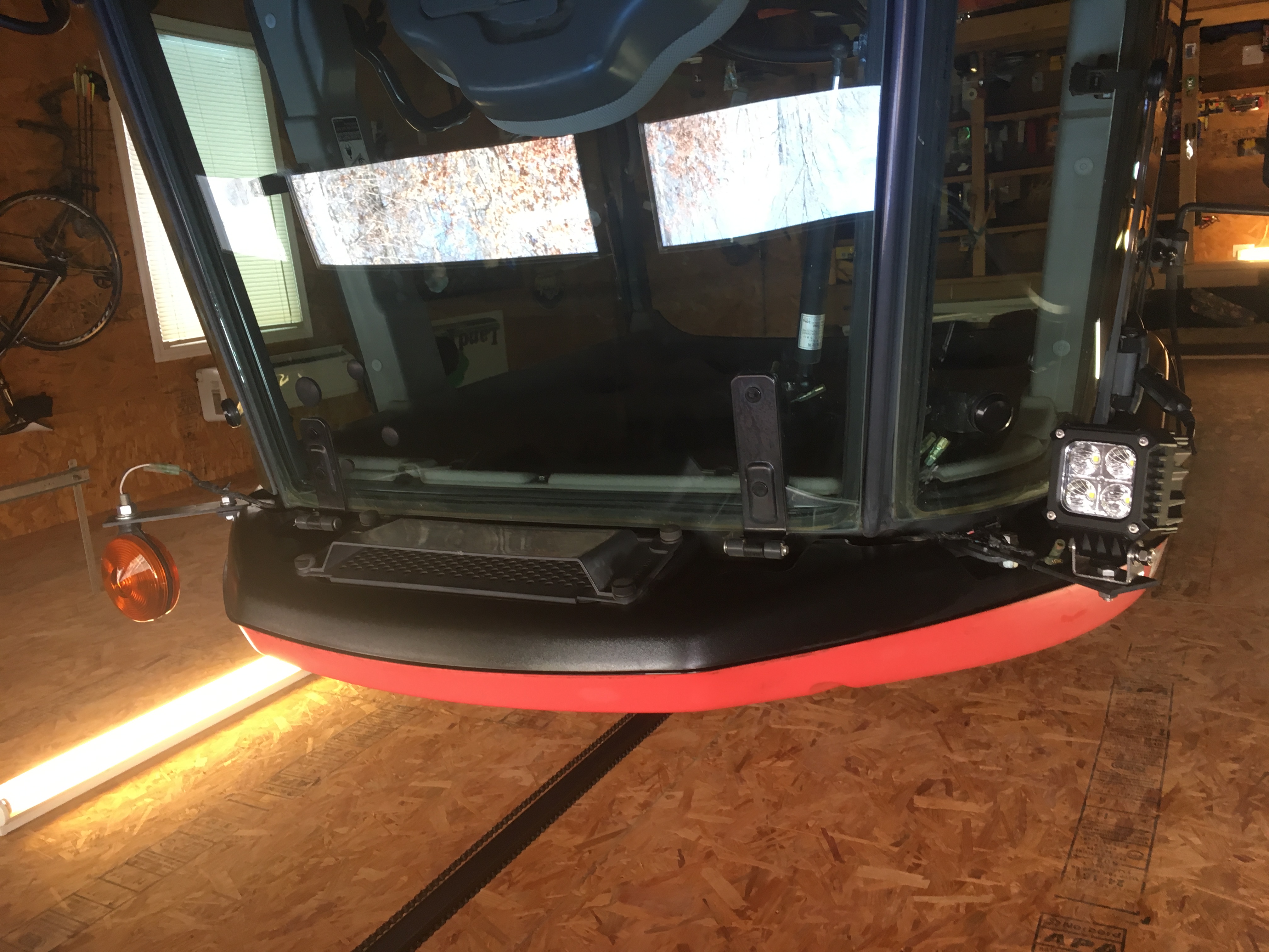

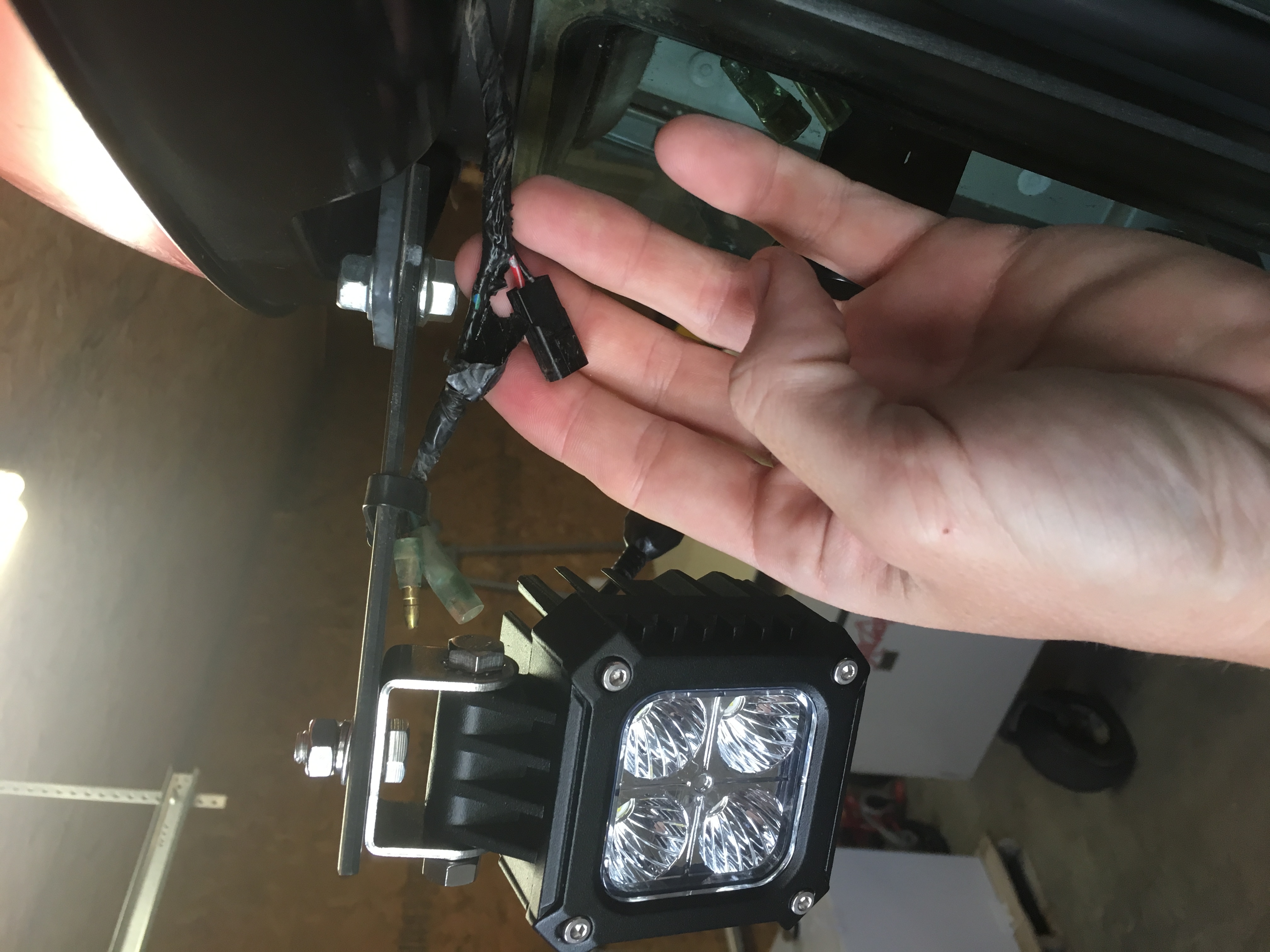

So I have decided to remove the "lollipop" lights and use that spot for my rear work lights. My buddy is a state trooper and he said I am still legal in KY on the road with my rear flashers that are on the fenders. Not that I drive on the road much.....and this spot where the flashing lights are is so dang easy to use. I am turning my LED rear work lights under as shown in the picture to minimize running into limbs.
When you click on these they will turn correctly.
