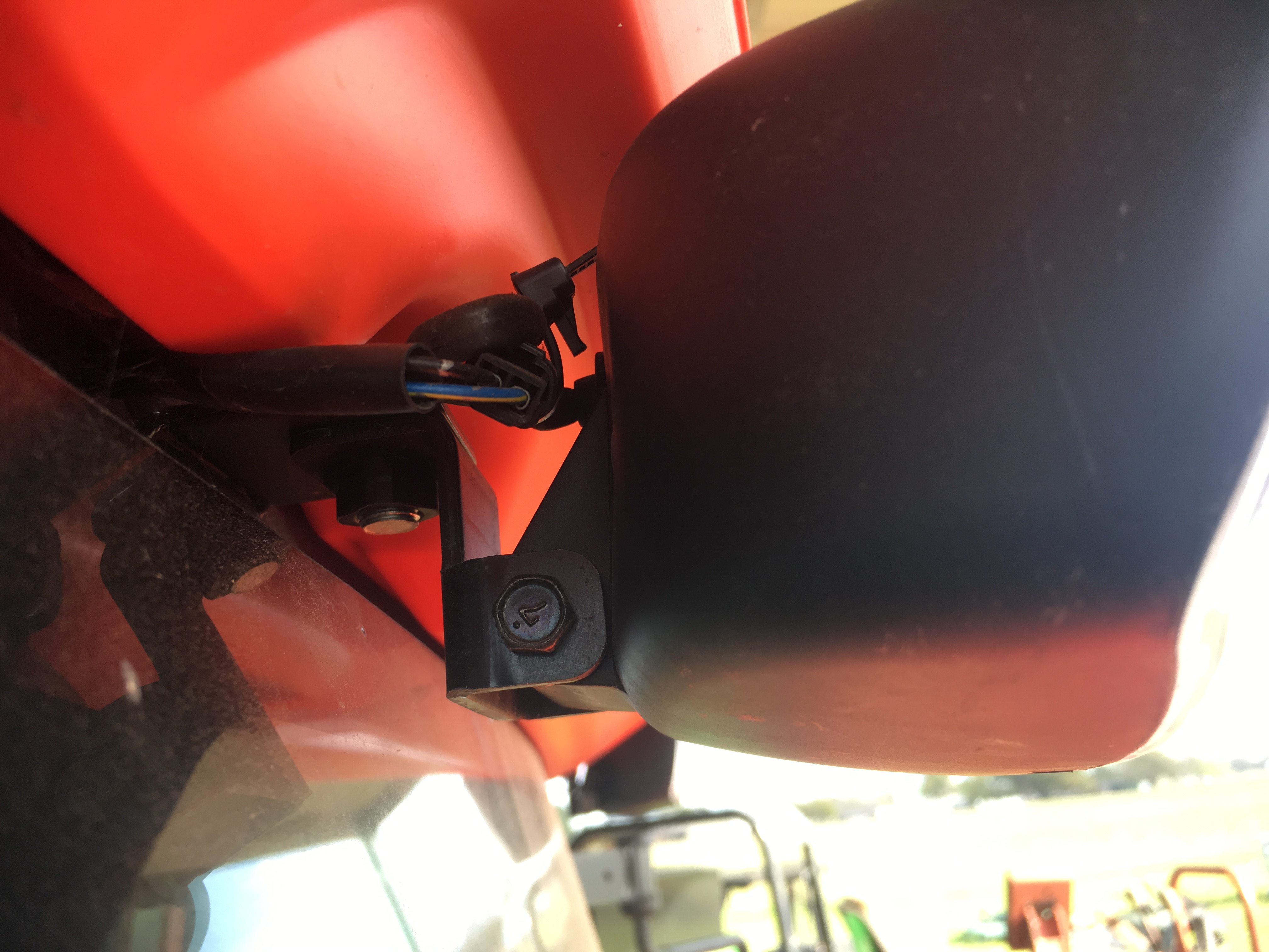

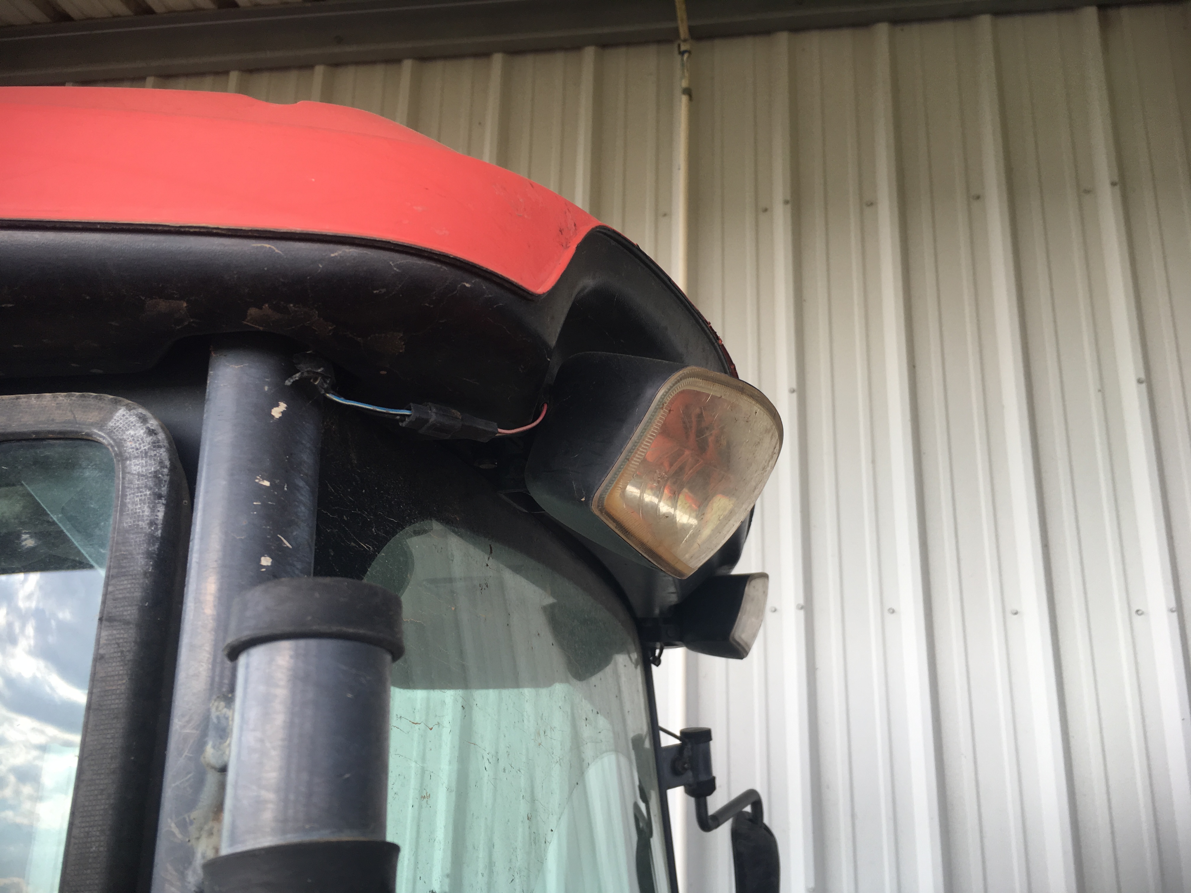

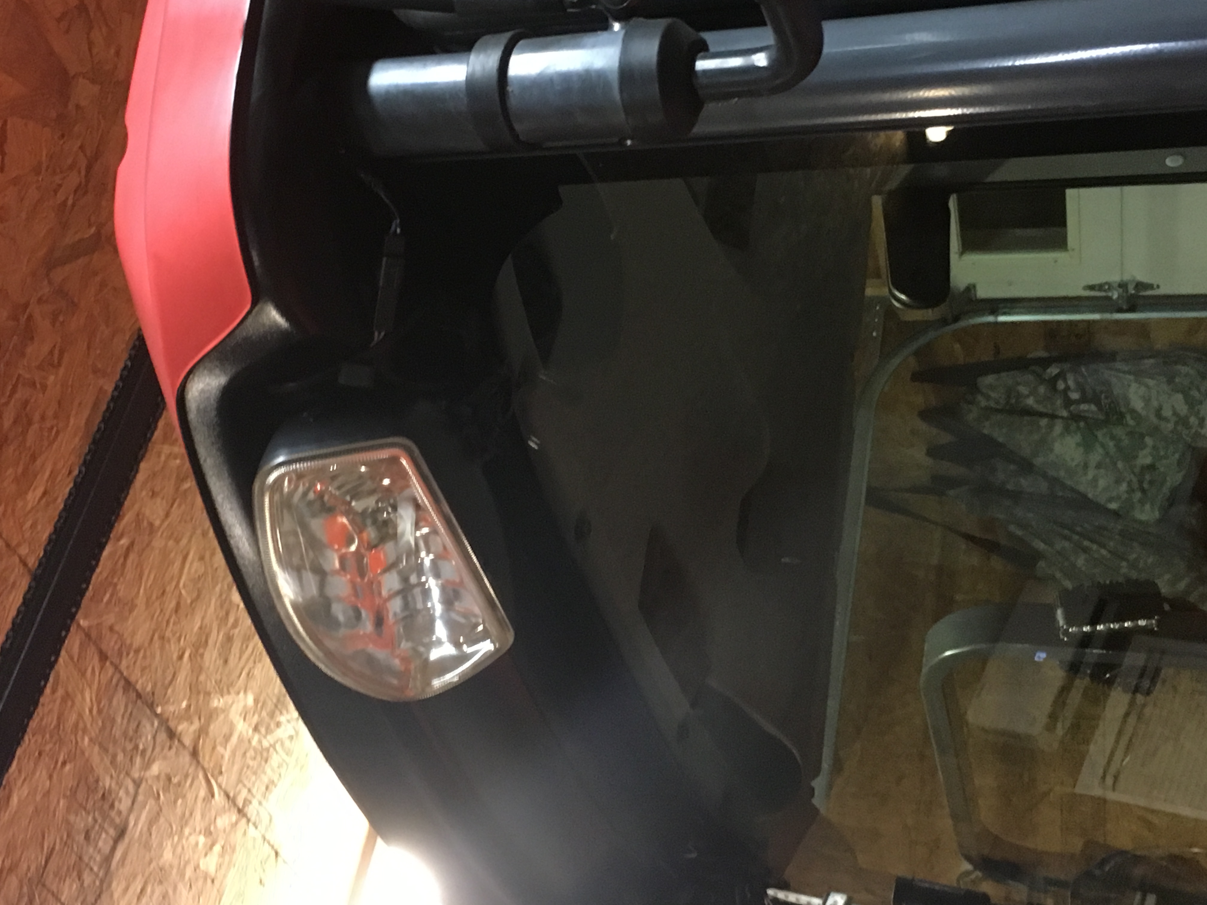

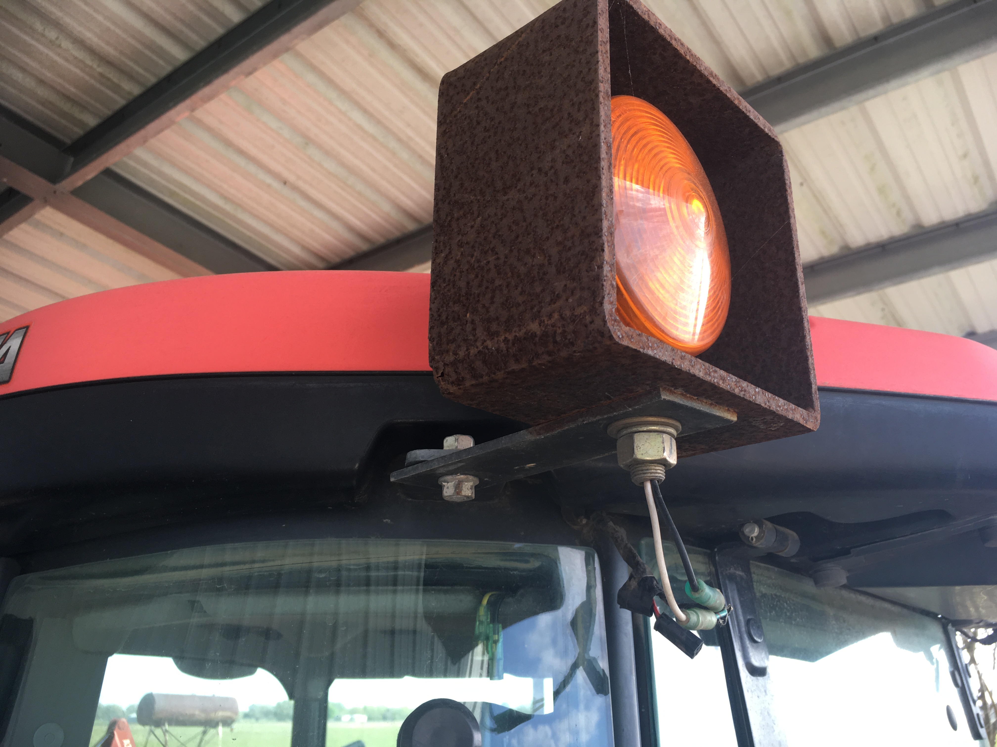

It looks like the light you reference in post 17 is the ONLY led light that might fit this application. I went out and took a few more pics of the way my lights are mounted on both my L5740 and my L6060. I think that for the rear, on my 5740, I could just put the LED's in the place of the caution lights. This is a pic of the rear of my 5740. I had someone make the box around the caution lights to protect from trees in the woods.

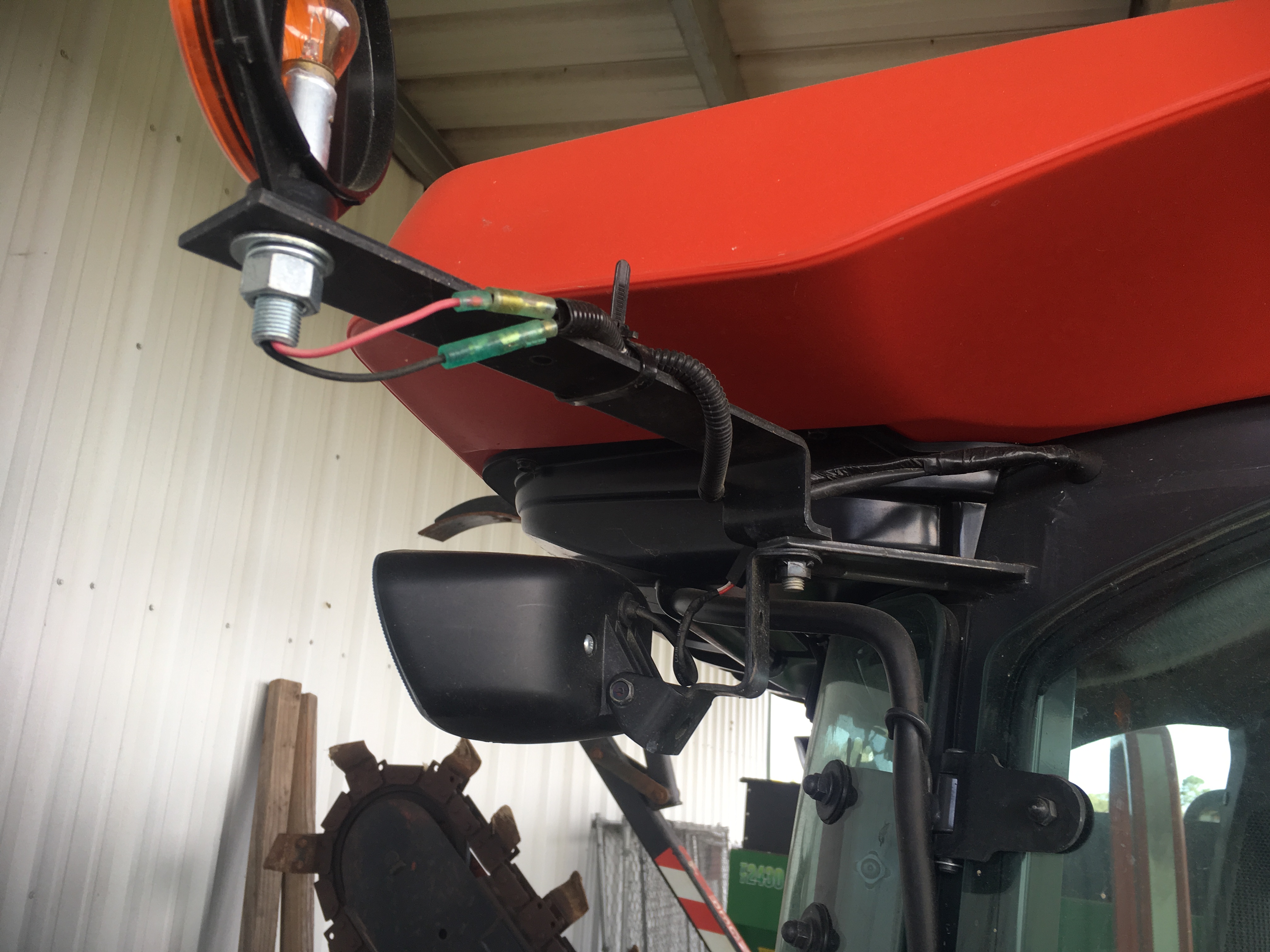

And, on the rear of the 6060, it looks like I may be able to use the factory brackets also.

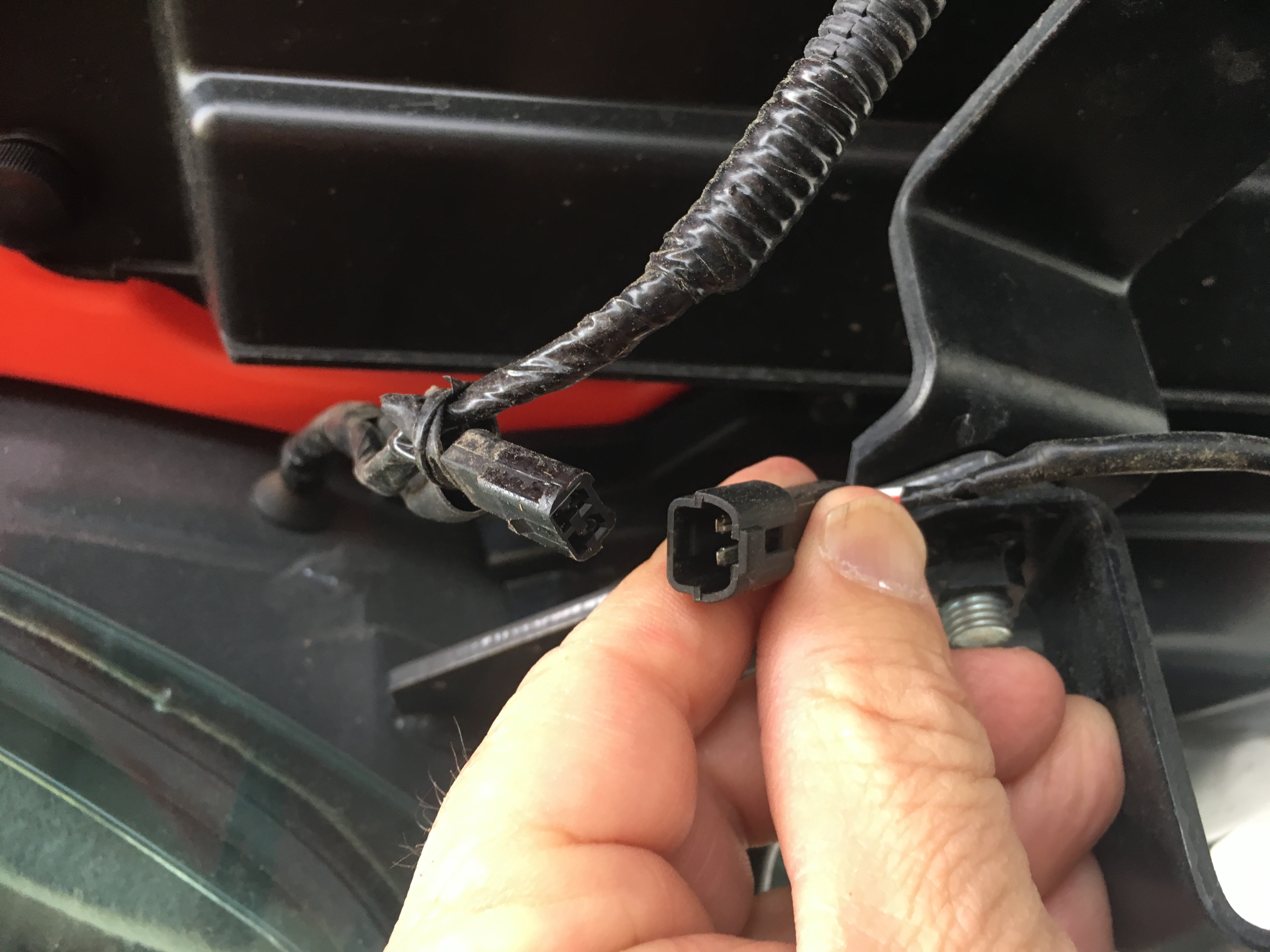

This is a pic of the connectors. Wish I could find some that would match up.

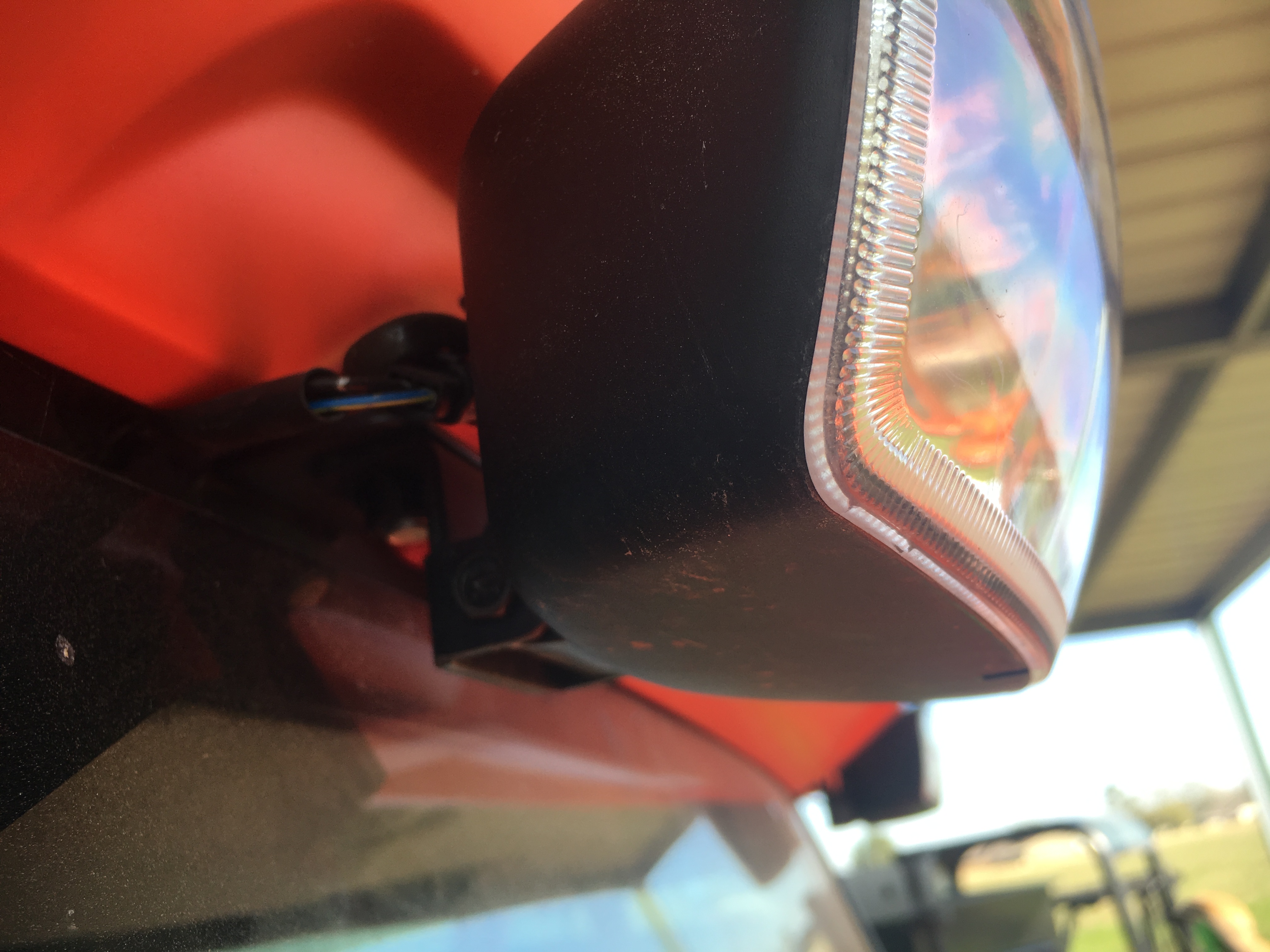

For the front on both the 5740 and the 6060 would be more difficult to install. I maybe able to use the light referenced in post 17
Kubota lights 11.JPGKubota lights 9.JPGKubota lights 4.JPGKubota lights 11.JPGKubota lights 9.JPGKubota lights 4.JPG

Sorry, I posted the wrong pic for the connectors.
Yes, you can....I said that earlier in this thread you can swap them out. It was post #20 as a direct reply to you.

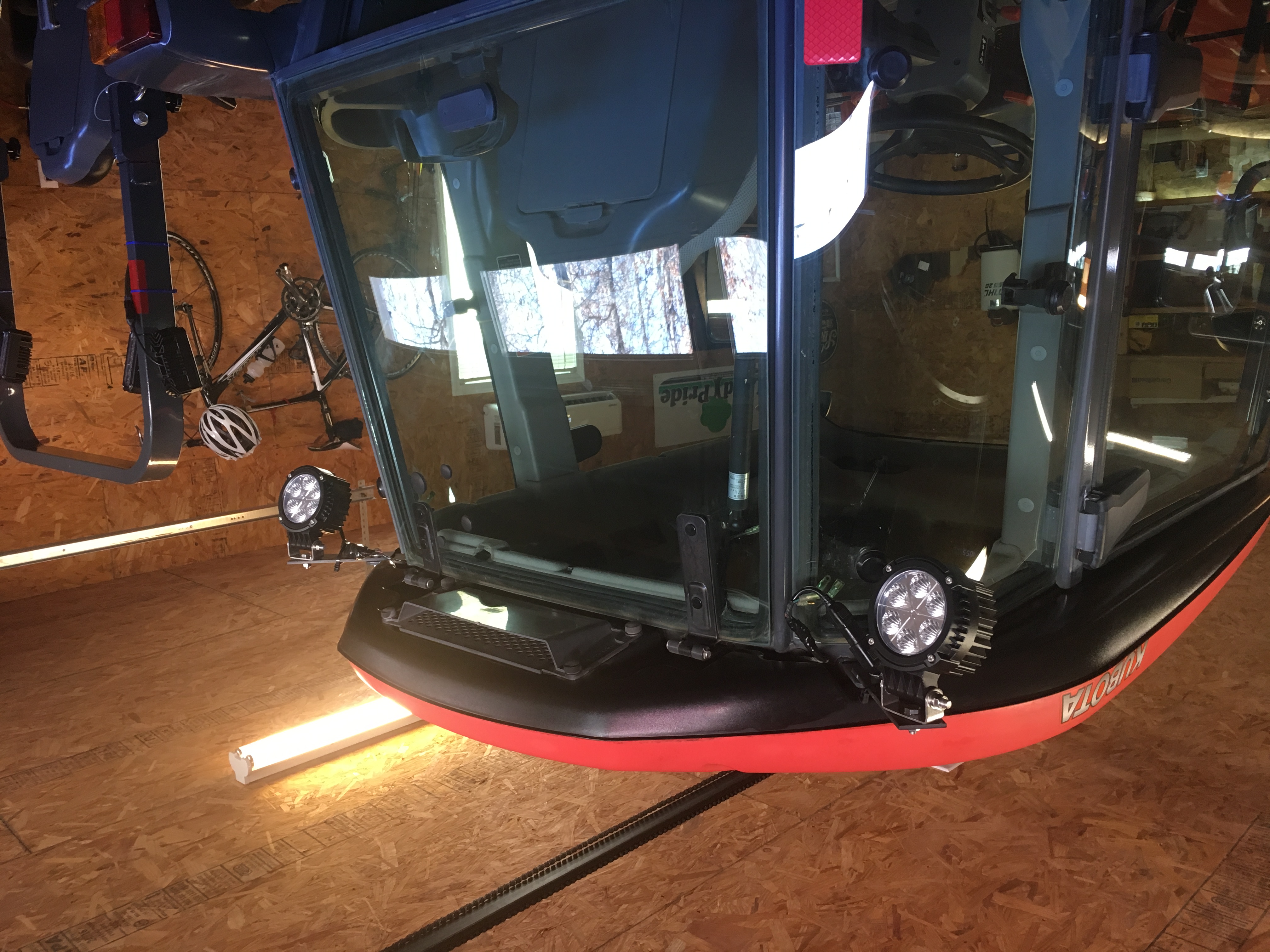

Here is the completed project of me swapping out my factory flashers for LED rear lights. Af first I used 20 watt cube lights but switched them out and went with round 30 watt round LED lights. Turned out great. I was able to smash the wires in there without having to cut the connectors off.

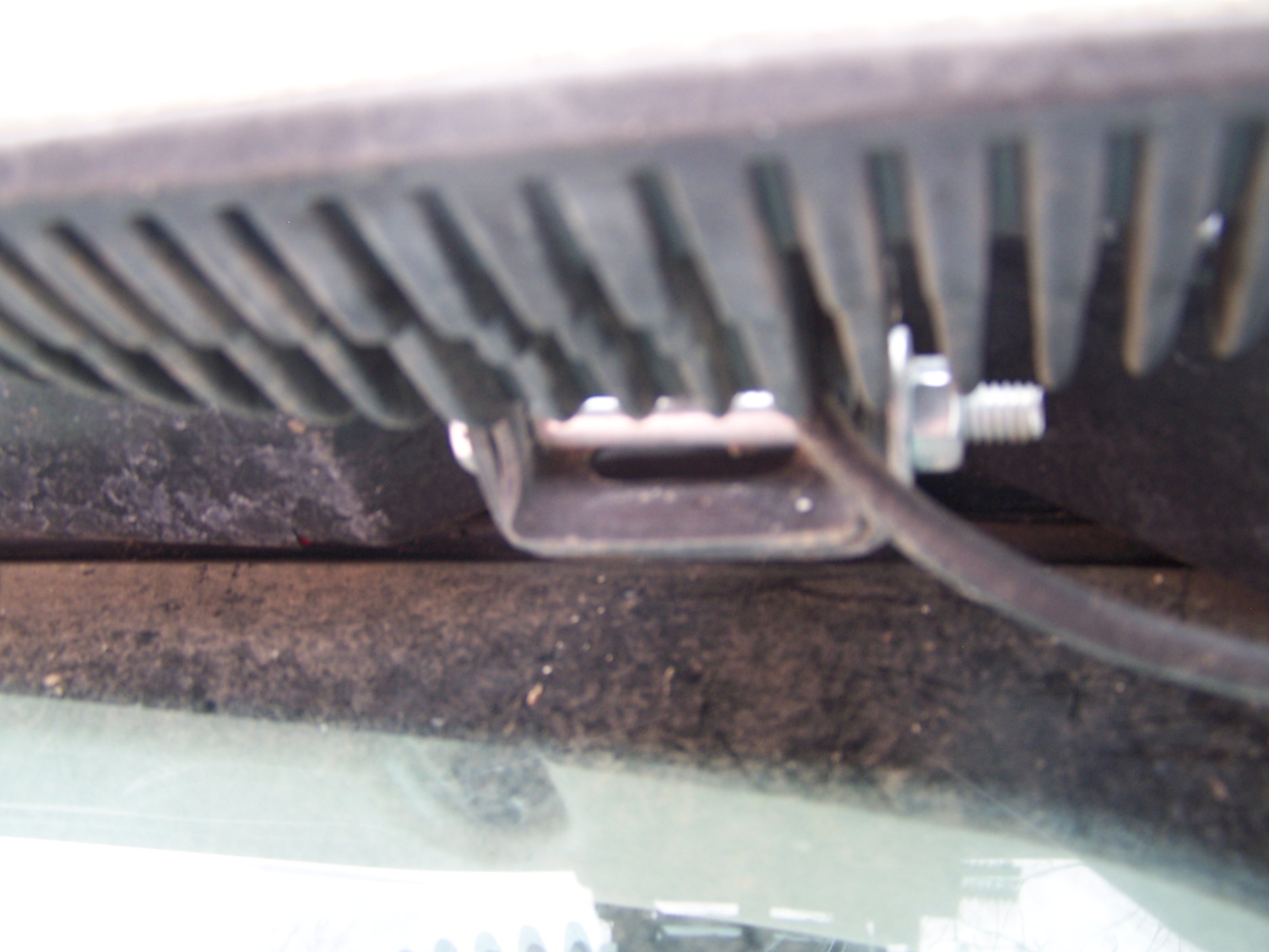

My front and factory mounting brackets both measure 1-9/16".Only had to spread a little for the LED's.
Again if you go to www.superbrightleds.com,find a similar light and they have all the physical dimensions.
I moved my factory halogens to the rear.

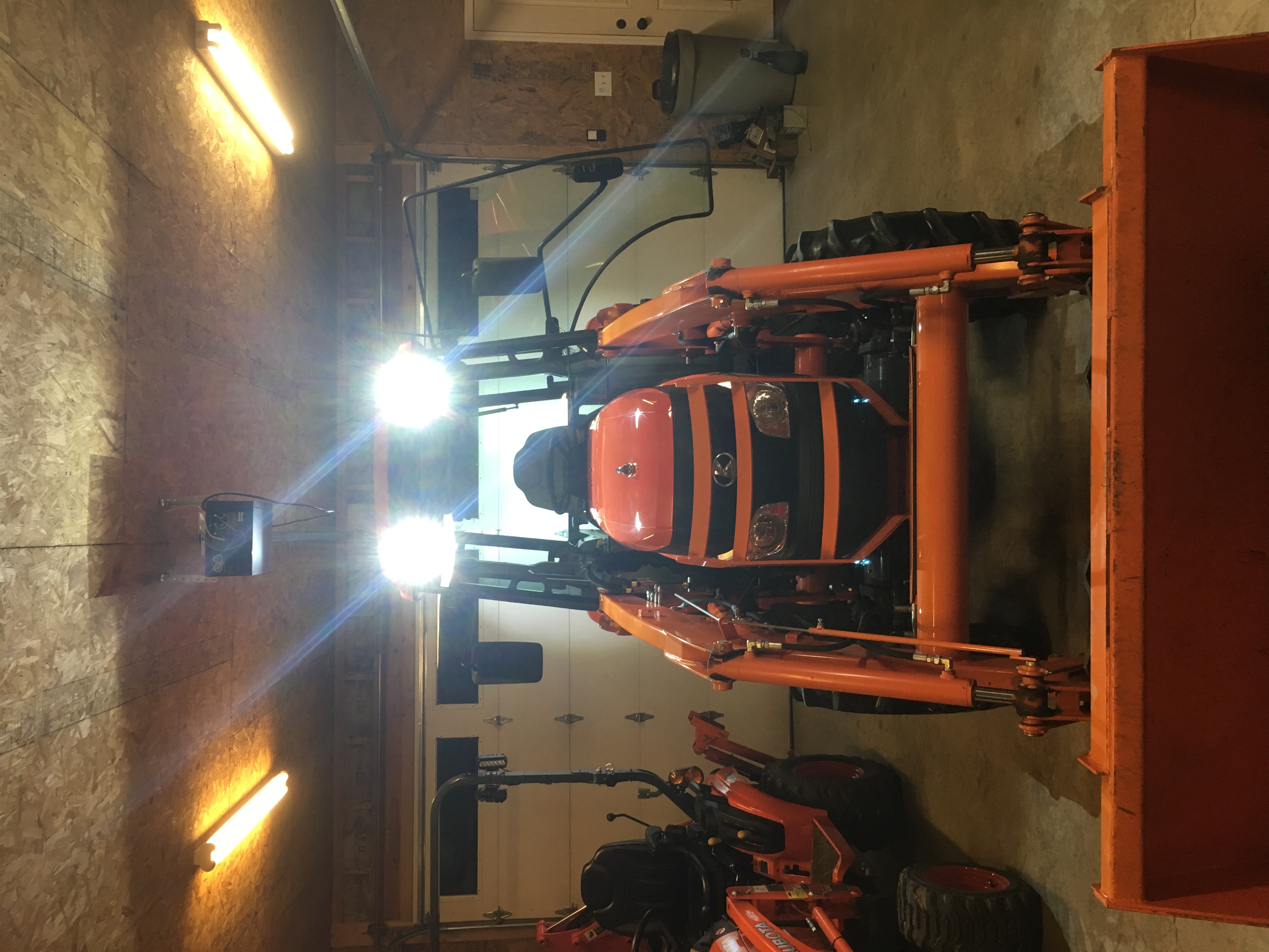

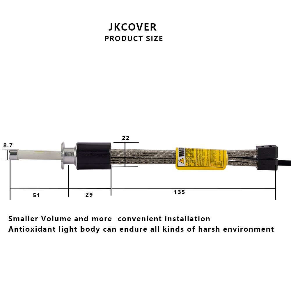

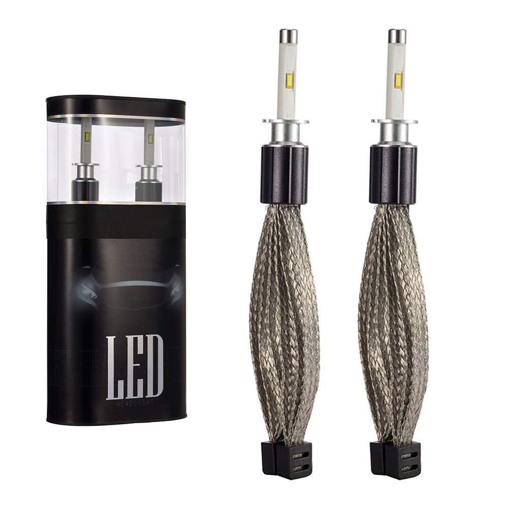

To the 1 or 2 people following this thread....I have FINALLY figured out a solution to the top work lights. If you all think this is worth posting in a another thread let me know and I will for future Grand Cab Owners. I origiginaly cracked open the factory housing and purchased some H3 LED bulbs for 19.99 for 2 bulbs. These did NOT have the fans or any type of cooling system. They were not very bright at all and within an hour they started making me pop fuses. I removed them and sent them back to amazon. Amazon.com: Cougar Motor H3 LED Fog Light/DRL Bulbs - CREE 5�W 5���K Bright White (Pack of two bulbs): Automotive. If you wanted some to color match a light bar that is in between your factory worklights...these would be 100% PERFECT for that as they require no manipulation and are simply plug and play...same LED color to match the led light bar you install.
Since the light output sucked badly I started looking for another solution but nothing will fit in the housing....It is just too tight a pace in there. So I ended up ordering some different H3 lights that have a fanless cooling system. usually the cooling systems means the lights are brighter than the sun...and these are like that. So what I did was drill out the back of the light housing and allow these light housing to poke through the back of the factory light housing and I let these big cooling flexible things come out and I just taped them to the back of the housing. It works like a freaking charm and I did not have to cut any factory wire......I only had to manipulate the factory housing...and I did that because had I ordered LED lights I would have ended up having to chuck the factory work lights anyway. So I have found solution that keeps the factory look for the front headlights and they are SUPER bright. They were 60 bucks on amazon.
So I have all that wire and stuff tucked around the back of the factory work light housing and zip tied up.
Next I bought some insane H4s with fans on them for the front lights on the grille. I am going to follow Paul and Kathy Short's video for the installation of them. I basically did the same thing for the work lights but went with a fanless system for the LEDs.
Amazon.com: JKCOVER LED H3 Headlight Bulbs with Advanced LED Chip and All In One Fanless Conversion Kit - 8W 6K 96Lm(4W 48LM Each Bulb)-1 Year Warranty: Automotive
61xGMGHv+aL._SL1000_.jpg 61DtUUEF2UL._SL1000_.jpg 2018-03-07 18.36.24.jpg2018-03-07 18.18.41.jpg

No you can't....they are completely ruined as regular factory work lights. I am not sure how much they are from Kubota, but since I was going to ditch them if I went with the little mini led light bars or cubes I just went on ahead and drilled a 1 inch hole in the back. In order to get a good photo I would have to take them back, off and I am just going to leave them on there.
These are definitely flood lights in how they operate. The front lights behind the grill are more spot.
