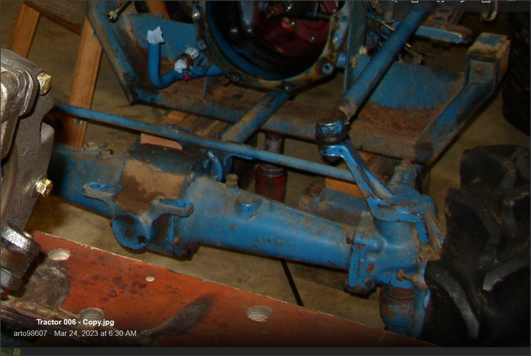

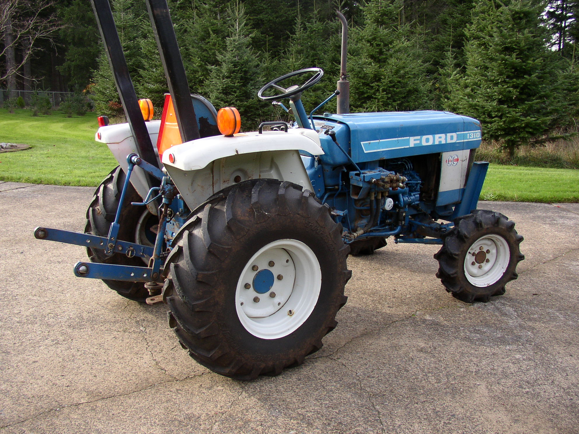

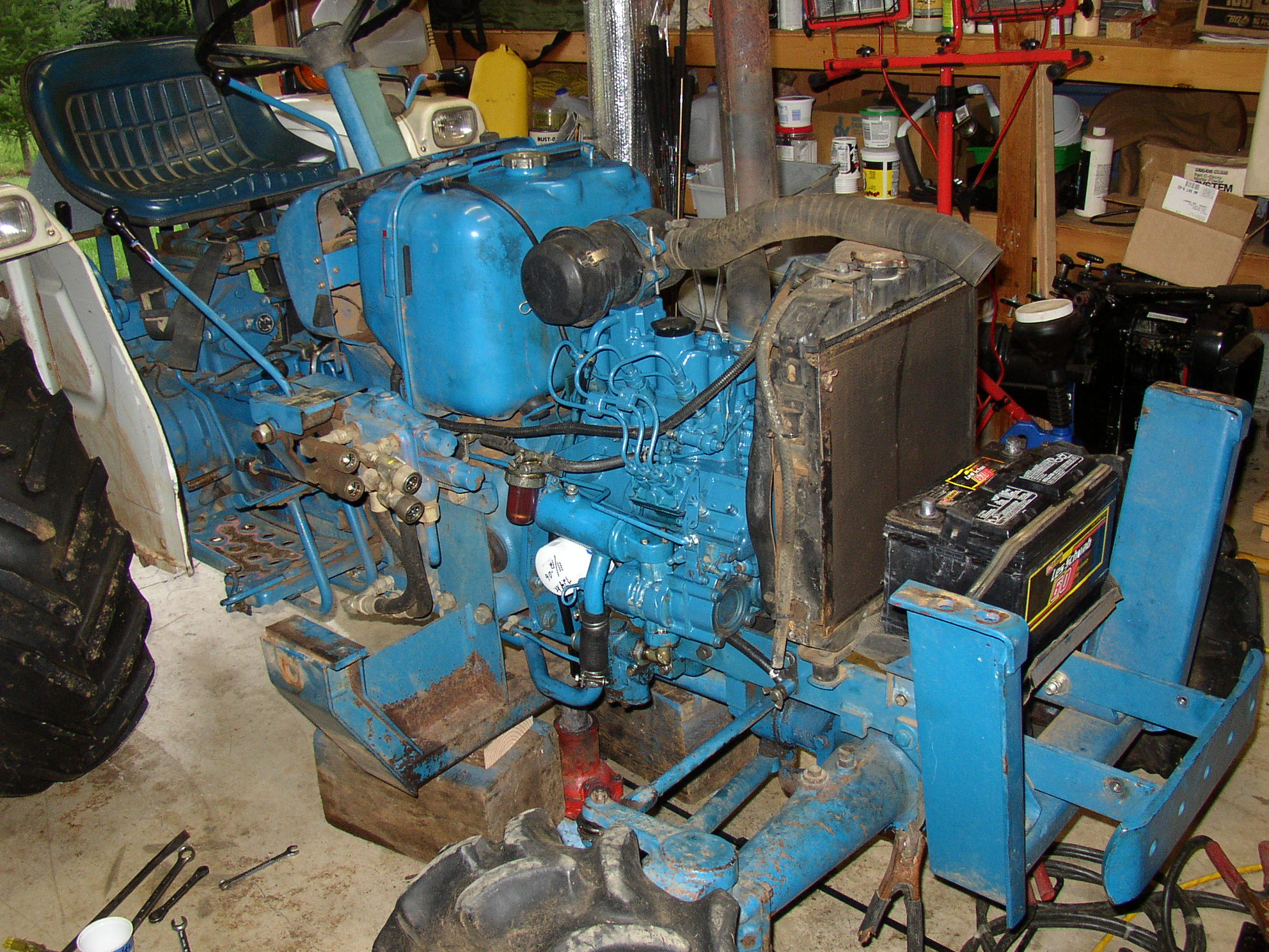

I took a similar design & vintage tractor engine out for some repairs over 16 years ago - here's few photos showing some of what's involved.
These will help: Metric hand-tools, wood blocks & wedges and engine hoist would be handy to have, but I am sure can be done without it also - it just makes the job lot easier.
Please note the clutch is pretty big for small tractor (19 hp) due to combination clutch for gears & PTO

Actually during the Ford 1310 disassembly only things sort of 'holding the front axle in place' were the steering link and the front drive shaft, as can be seen below in the zoomed-in section of my previous photo.
IE. The engine acts also as a frame towards the rear, but there is a separate heavy flat-bar type frame from the engine forwards front axle.
The flat-bar frame can partially be seen in one of my photos.
These 1980's design tractors are pretty simple to work on since the cast iron engine/transmission/differential are also the main frame of tractor.
