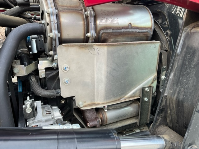

Hello, I have seen a few posts about the TY359 and I would like to put up my experience with the one that I have had for 2 years. First I am not doing a rant, All in all I really like the machine. I had a Kubota Grand L6060 before I got this and I liked it okay but I really didn't like pushing the hydro as hard as I was on my VERY steep driveway plowing. I also have a John Deere 5100E , JD 2520, Farmall M , JD60 and a JD 435... So I like to think I am fairly in tune with all flavors / types of tractors :) . So I will give my negatives first so I can end on a high note :)
Cons:
Heat Shield rattle ! O my gosh nothing gets on my nerves like hearing some heat shield rattling! I had to fabricate a new heat shield out of Stanless (I own a machine shop / fab shop so it was an option). The heat shield by the muffler was the first one to rattle. After that one was fixes about a month later the shield by the starter added in and I had to weld a stiffener on that shield. If anyone else is having this issue I am more than happy to show how I solved this.
Cons:
