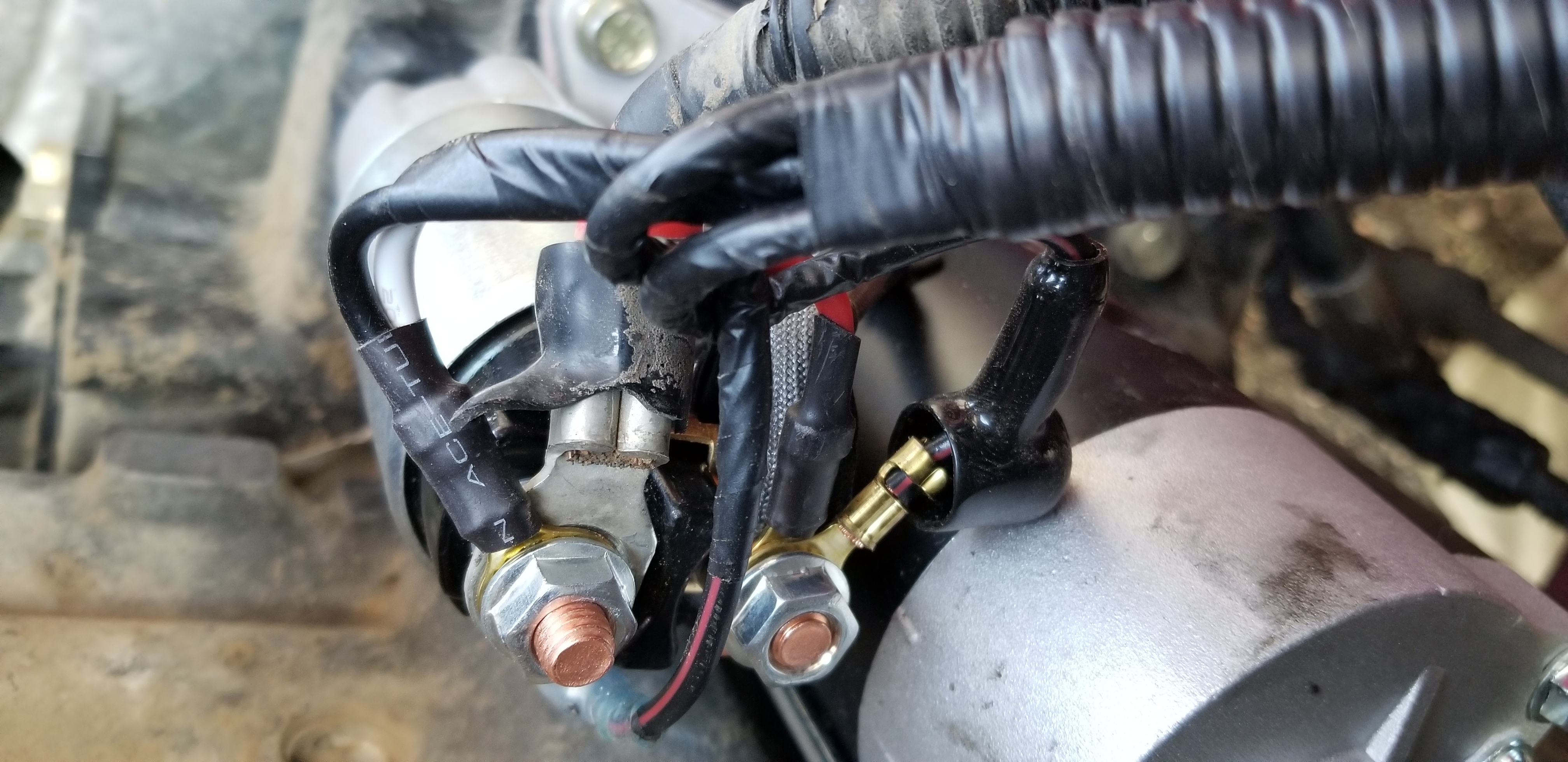

sorry guys my starter has 2 post that are the same size. One on top of the other and the side next to motor has a male spade terminal. If Im not mistaken. The lower terminal has a braided wire that goes right to the starter(itself) and the black/red wire with its own rubber boot. the top post had the battery wire. a black/white combination that also goes to the alternator, and a red wire. Just a little gun shy on hooking it all up and burning things up again. Thanks for all your post :laughing:
   / Tym 353 HST NEED HELP!!!! #12
Largest connection gets the big red. The white black and red black are paired to the connection to the right of large, (closest in picture). Single solid red is to left of large by itself. Hope that helps.

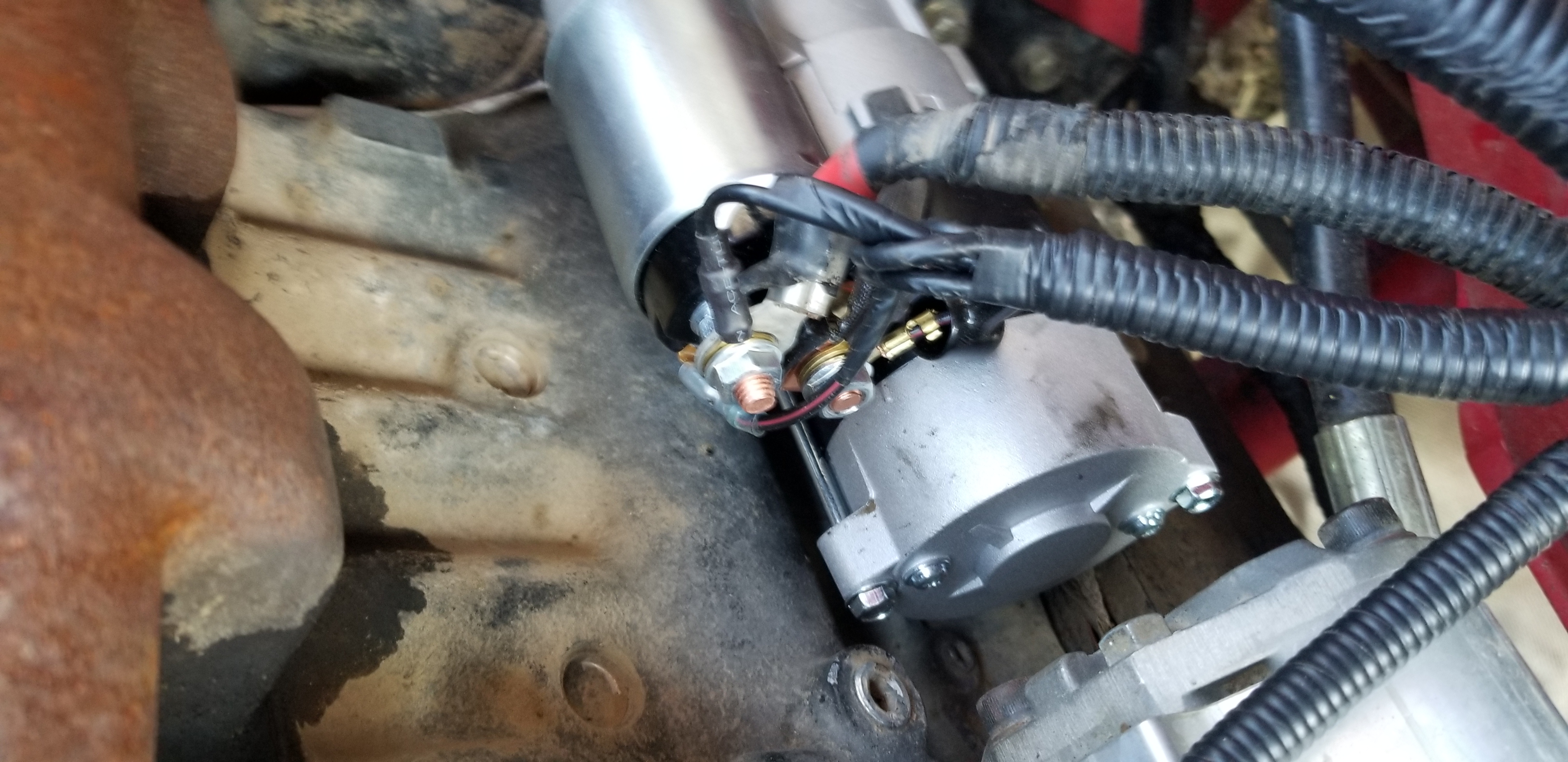

Ok guys does this look right 20180912_090647.jpg20180912_090655.jpg20180912_090647.jpg20180912_090655.jpg

Large battery wire and the comination black white going to top post. Red wire and black/red with its own cover going to bottom post.red/black with female spade connector goong to terminal on engine side of starter?

Ok everyone. I was correct on the wiring to the battery. After installing the 2 new harnesses i tried to start it and no luck. Then i installed the old key seitch and walla it fired right up. Thanks for all the post. I think the last time everything got burnt up it took out my new key switch.
   / Tym 353 HST NEED HELP!!!! #18
Don't you mean, you were right on the starter and solenoid wiring, and you're new ignition switch likely got fried by the recent harness burn?

Pretty much . I was typing from my phone . Sorry for the mis spellings.
