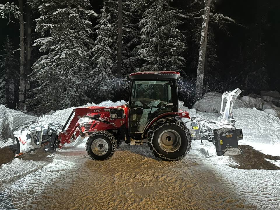

I too, love this particular picture! It brings me memories of my youngster life in Minnesota! This was the scenery about 7-8 months of the year!
