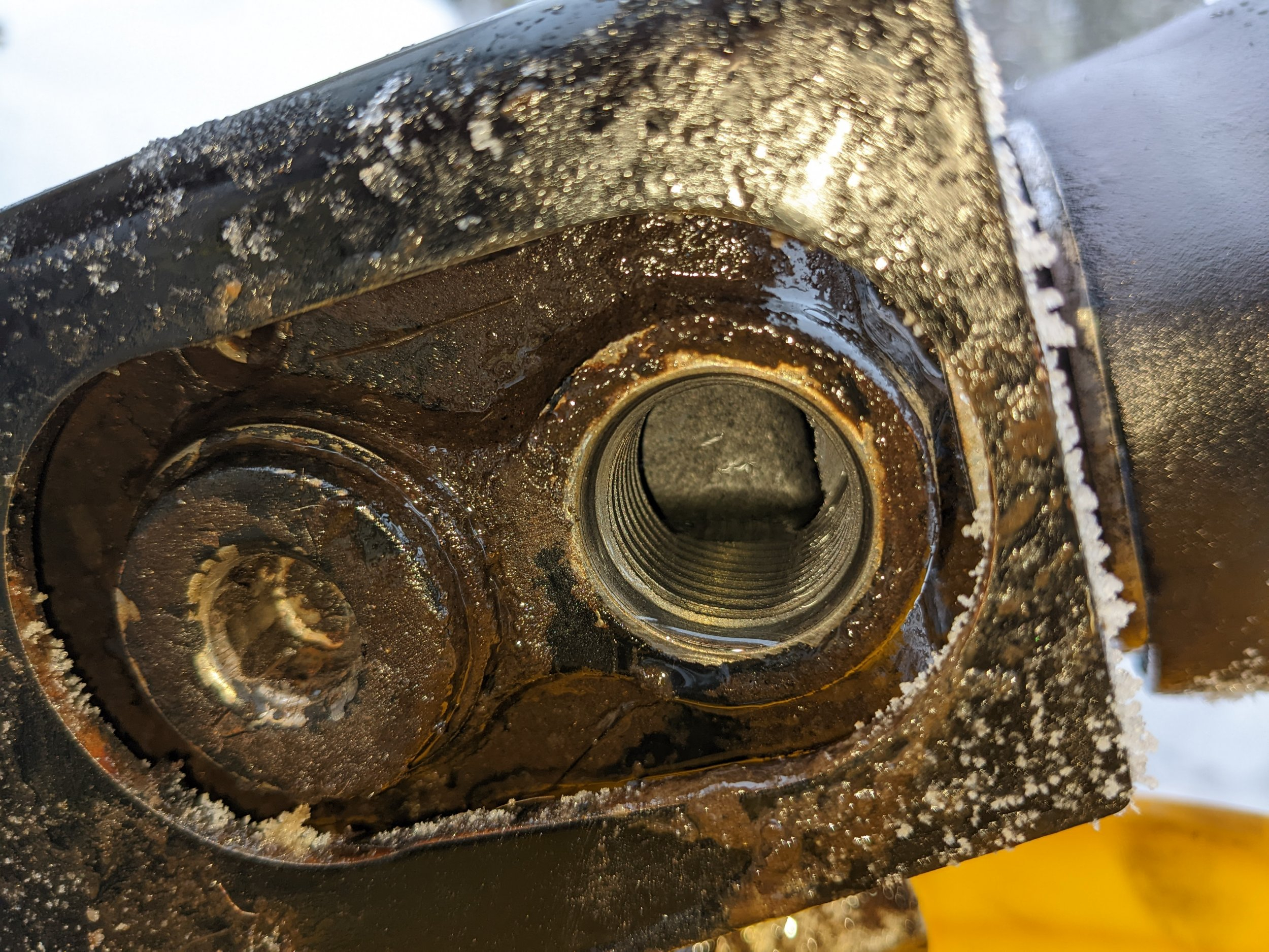

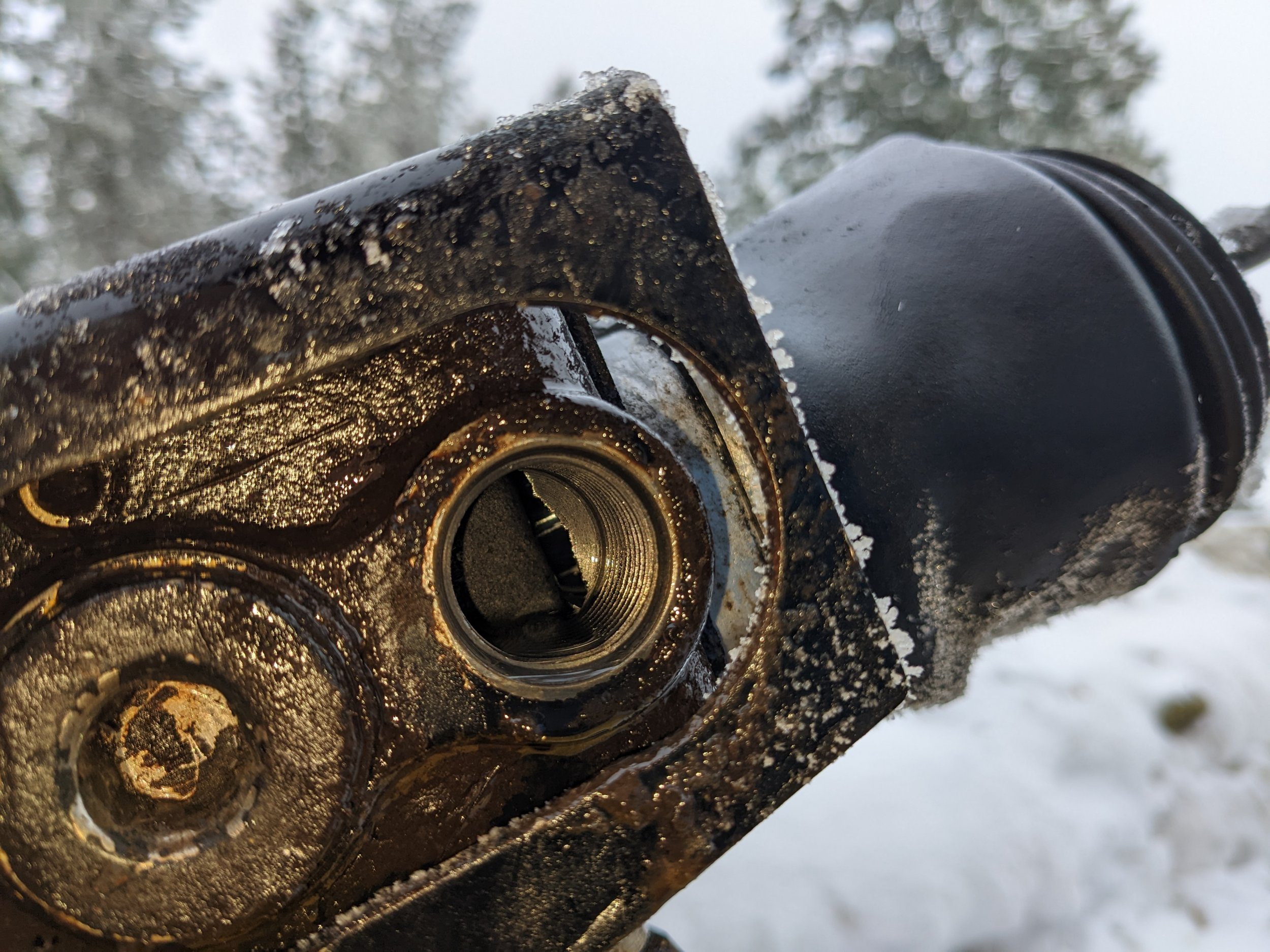

The sleeve they sent fits in the T port on the loader valve that was plugged:
However, the bracket / mount that the loader valve sits in needs modified so that I can tighten the sleeve into the valve - right now the sleeve bumps into the valve mount before it's tight.

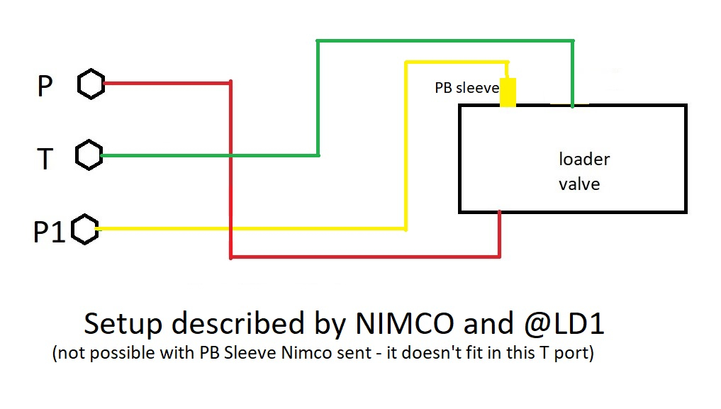

Here's the original setup before anything changed:

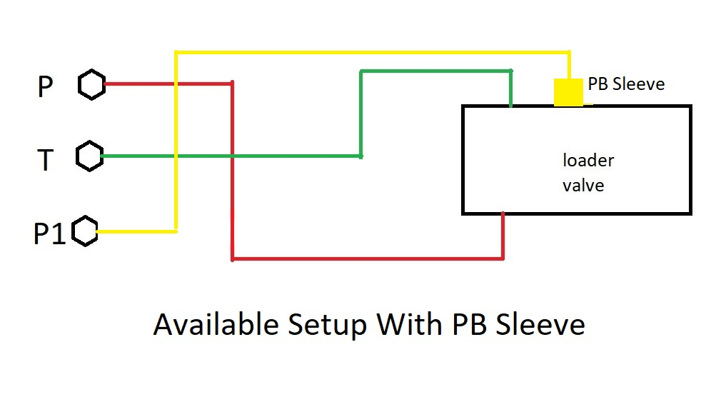

Here is the possible setup with the sleeve Nimco sent me:
However, the documentation from that valve (here - page 12 describes the Power Beyond / HPCO sleeve install), as well as LD1's description indicates it should be installed as follows:
Late to the party buy you are on the right track. I'll try my hand at explaining some things.
So you are on the right track getting with the dealer and tracking down a PB sleeve for your current loader valve. Find that sleeve and install it. The line you currently have coming out of the tank port of the loader and going to P1 on the tractor will hook to that sleeve and continue feeding the 3PH through that P1 port. Then you will add 1 hose going from a T port on the loader down to the capped T line that isnt being used.

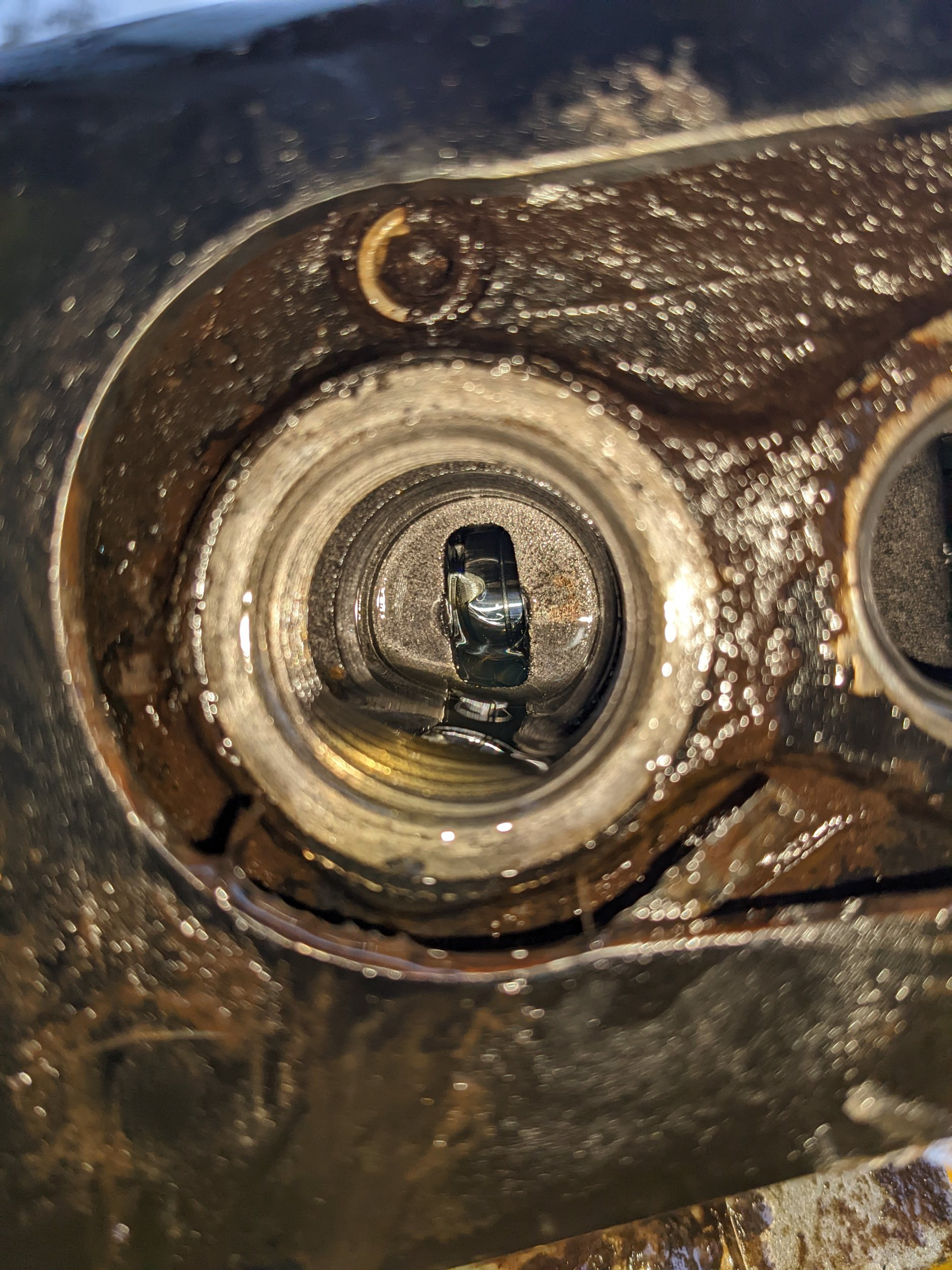

The sleeve does not fit into the T port shown below - the port diameter is too small.
My question is - should I grind out a space in the valve bracket and install the sleeve in the only T Port it will fit in (as shown in the 2nd drawing I posted), or should I see if Nimco sent the wrong sleeve? The documentation from Nimco doesn't match with what I am able to do with existing parts.
I certainly don't want to damage anything in the system - if I hook everything up the only way it'll fit with existing parts, can I do any damage?

The second diagram is correct and yes it should go into the tank port that had the plug. Hopefully the valve is still good. Looking forward to it working properly.

Alright, I'll get to grinding!
