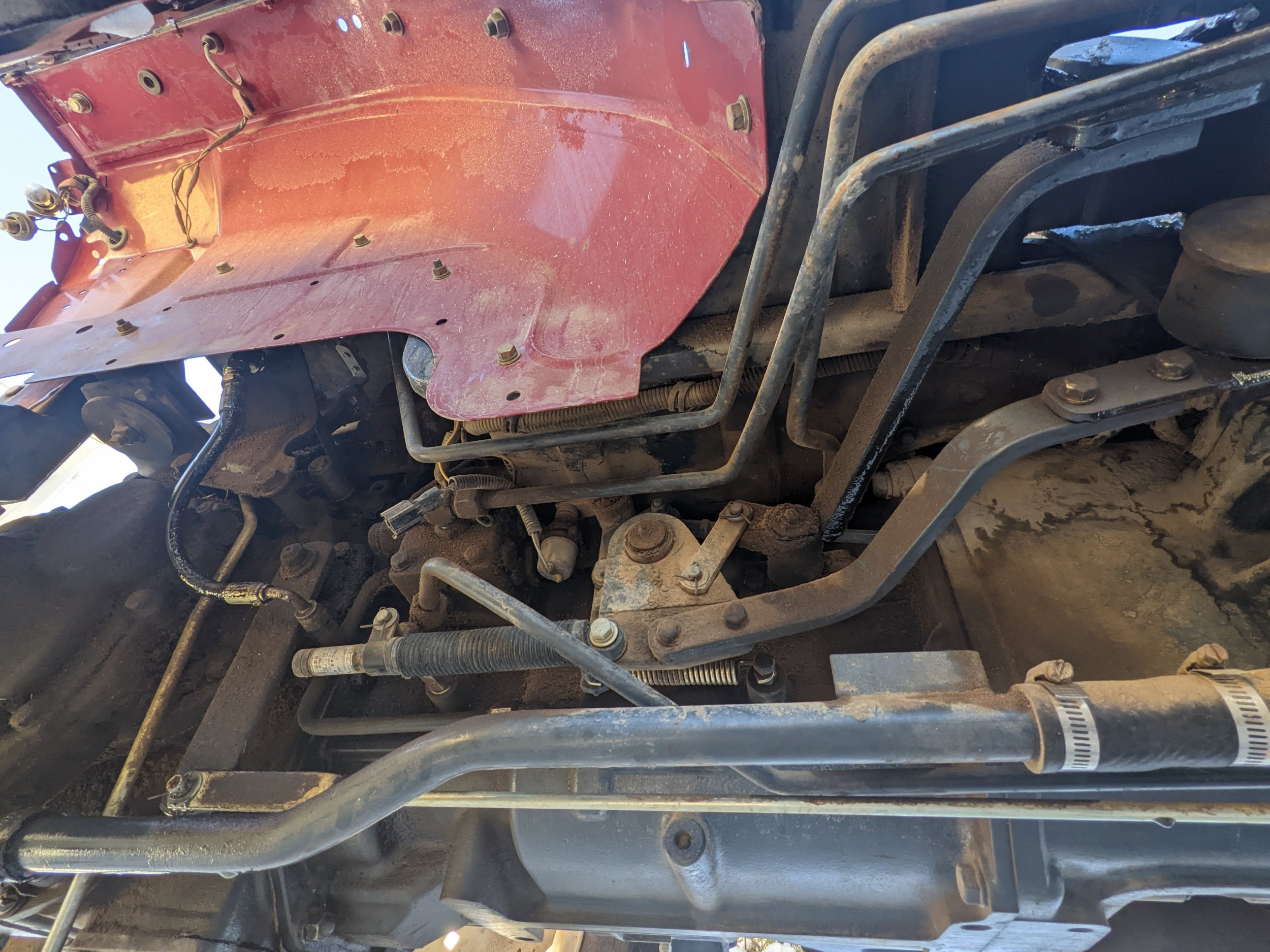

Here are pictures of the hydraulic lines coming from the system. The two hoses coming from the system go into the loader valve at each side.
   / TYM T330 HST Joystick Control Leak #12
I would suggest getting a hydraulic schematic for your tractor and or owners manual that explains how your tractor system operates. From what you are describing it seems like something is not correct. For those seals to leak you would have to pressurize the tank port. Doing this on most valves can crack the housing and if system relief is in the valve it becomes inoperable since tank pressure increases the relief setting.

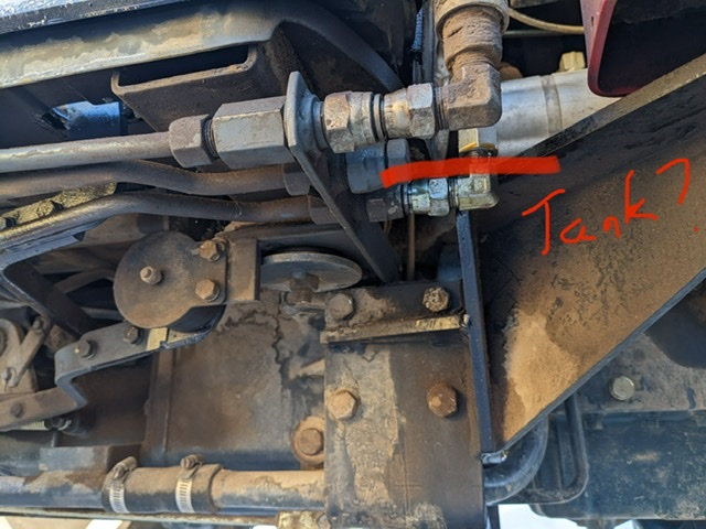

I wonder if this line would be return to tank? We need to see the markings for the valve ports and determine which line feeds what. Finding a power beyond sleeve for the valve may be difficult.
   / TYM T330 HST Joystick Control Leak #16
K5, good question on that extra line. Agree owner needs to see if there are markings on his Loader valve ports. Schematic that PT provided link for did not show loader valve so I presume this was an option but in looking at those steel lines it makes you wonder if it possibly came prepared for loader valve.
Where would I look for markings? Look on the loader valve? I tried to show in this picture where the steel
lines go - not the best picture:
I'll look for markings on the loader valve and try to figure out which line does what. The sun is just going down so it's getting cold fast - it'll have to wait until tomorrow.
Look closely around the ports. You should see P for power in, T for tank and C or Y for power beyond. The C would be where the power beyond sleeve would go so this one likely has a plug now.

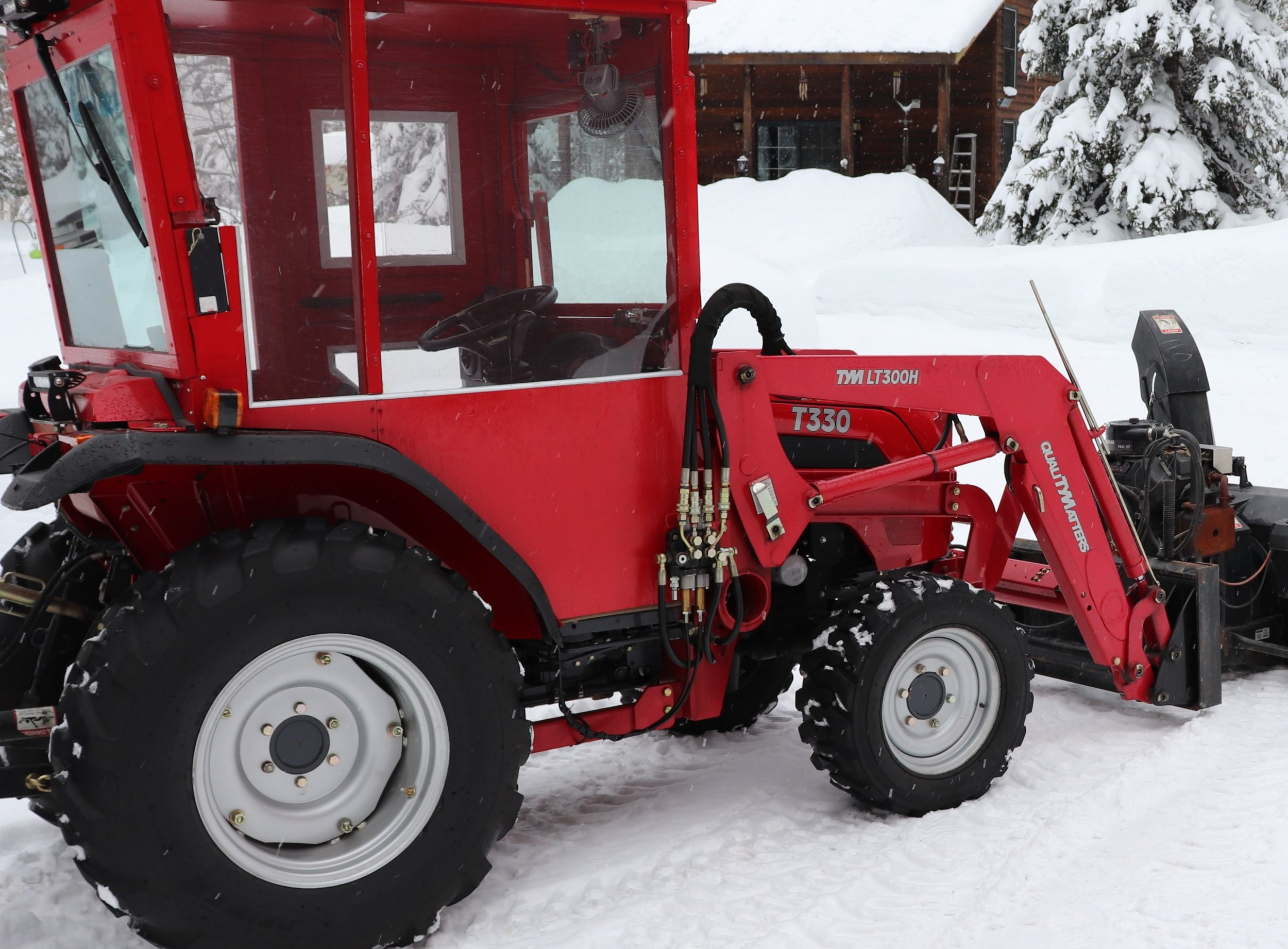

I had a T330 and I happen to have a couple of pictures of how the loader valve was installed on mine from the factory. Not the best pictures but I hope these can help some. Yooper
