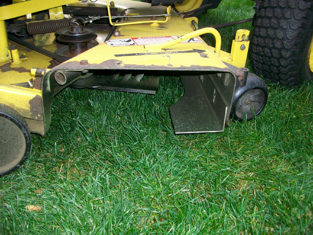

The G6's are the ones that were bogging some machines down. That's the reason Oregon came out with the G5 blade- so that others who couldn't spin the G6's properly could benefit from all the same attributes, but do it with a thinner, lighter blade. I spin a set of G3's which (for my machine at least) have the same exact lift height and cutting edge length as the G5/6 blades, and do it with my 14 HP Kawi in my 24 year old JD 240 w/46" deck with no problem at all. You shouldn't have any issues with the G5's with that engine.
Here's a picture of the G3 under my deck-

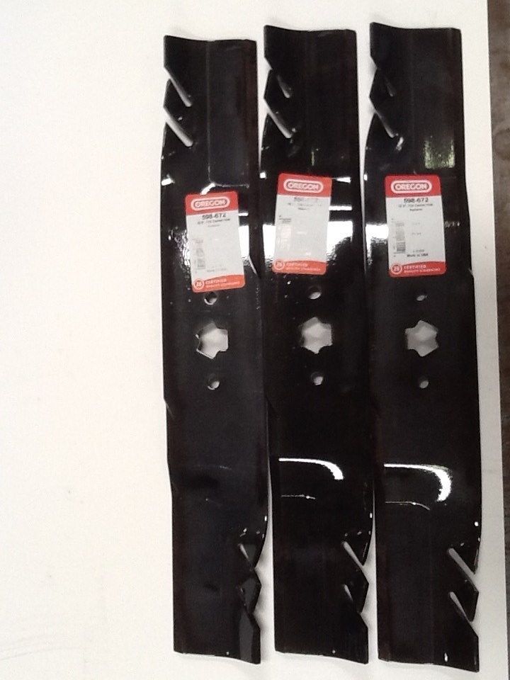

Okay I just ordered some G5's for my Zero Turn. I got them for exactly $50.00 and they were the star pattern with six corners. I just found out that each of these blades are just slightly over one pound heavier than my old ones. Which means I will have roughly three and a half more pounds of blades under my deck. Since I just literally scraped out about twenty pounds of grass with a knife I don't think it will make a lot of difference.

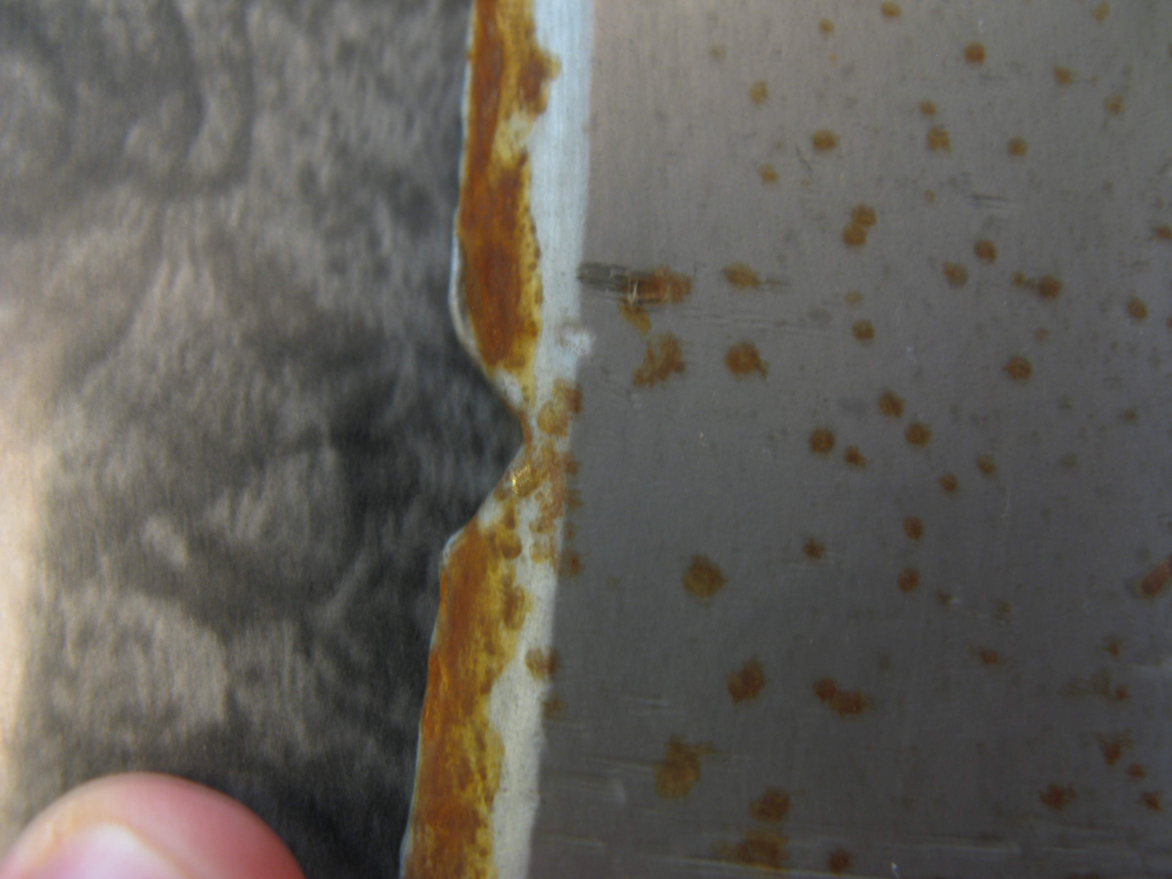

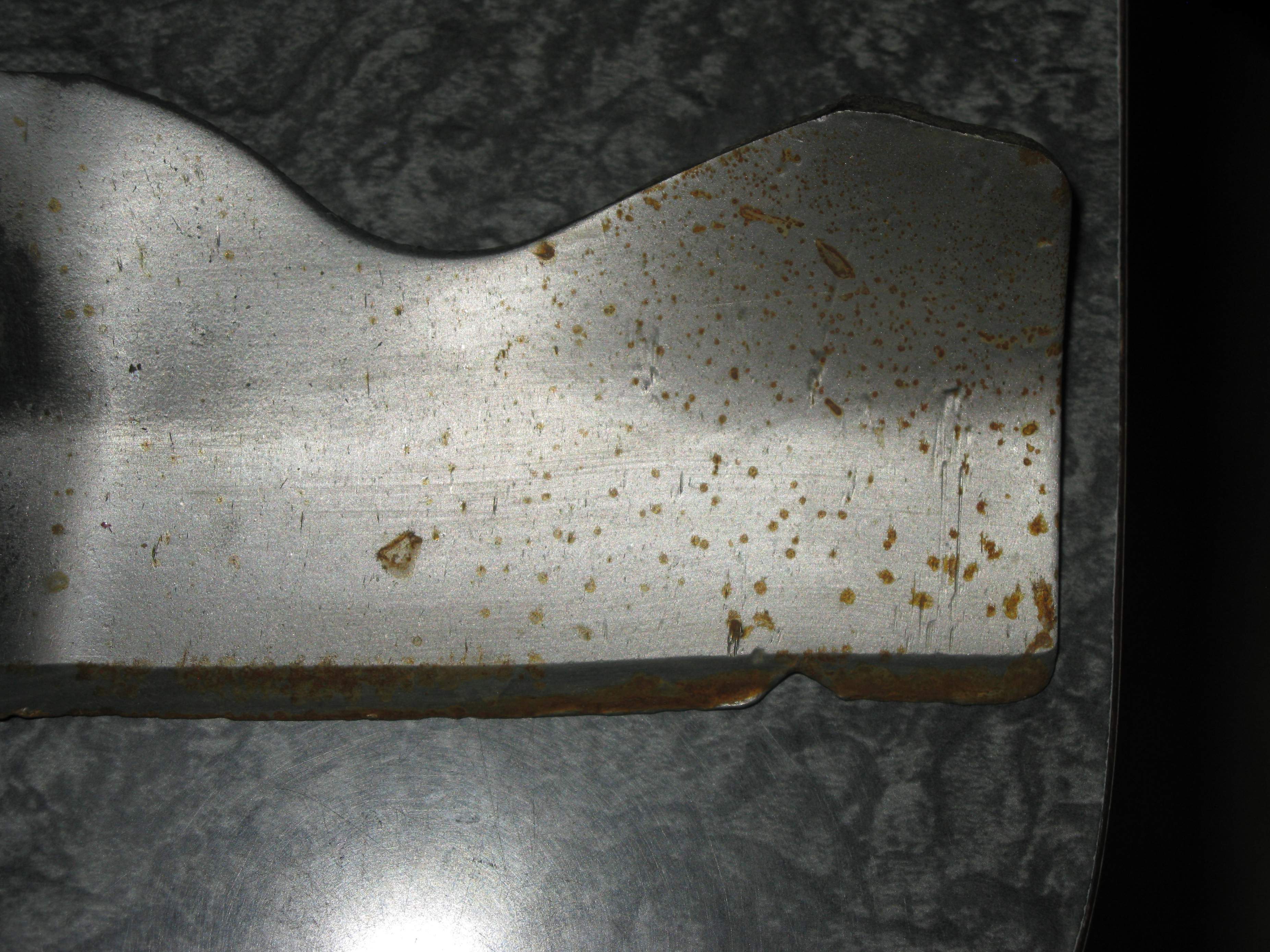

Hey RG1 the blades I took off (as you stated) are in pretty bad shape. The worst one by far is pictured below. The gash in it is pretty bad in my opinion. However do you think that when I get the Oregon Grinder and balancer that I could still use it? Take a look when you get a chance and let me know what you think.
